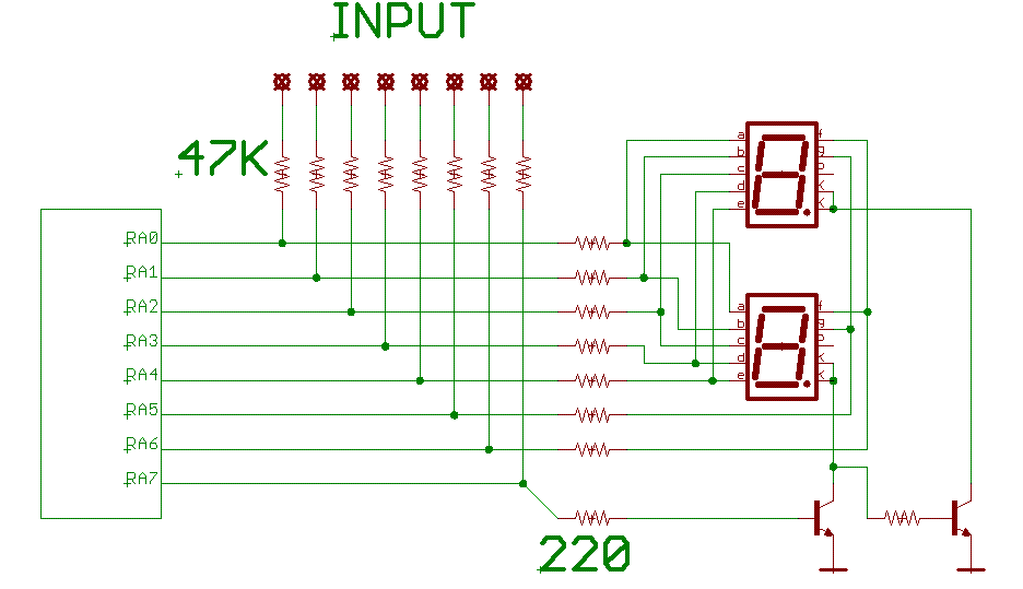

By adding some resistors it's possible to control four displays on each 16F628.
This is true if the circuit driving this display unit are capable of both sourcing and sinking the signal (i.e. not open collector) and can handle an extra load of 100 uA.
The same pins on the '628 can be connected both to the displays via 220 ohm resistors as well as the outputs from the controlling circuit via 47 Kohm resistors.
The '628 will first set the pins as input, read the incoming signal, calculate the correct bitpattern, set the ports as outputs, output the bitpattern, wait 20 mS and repeat all over again.
This means that the segments on the display can only be changed 50 times per second, but i think that's enough...
The attached picture only shows half of the circuit. It needs to be repeated for portB.

EDIT - I just realized that it's not possible to drive four displays this way using the 628 since the RA5 -port is crippled and can only be used as an input. This input/output sharing thing can be used in other applications to reduce the number of ports required, but for this specific application it's not usable. Sorry.

I'm sorry. I have to take back my idea since I just realized that it's not possible to use the RA5 -port as an output as it is crippled on most of the PICs and can only be used as an input.

hi mats,
Good try, but isnt Bit 7 going have problems with trying to register a high input, its going to be clamped about 0.7V with T1 base/emitter junction.
EDIT: in fact having had a better look at the dwg, all the inputs would have the same problem
Eric, you have a point there, I forgot about the transistor there, but by using transistors with a decently high gain it will work even there.
What's the problem with the inputs connected to the anodes? I can't think of anything.
I actually whipped up a test of this on my breadboard now. On the ports connected to the anodes it worked beautifully even with a 100K resistor as isolation to the controlling circuit. And by using BC547B transistors, a 22K as the first base resistor, and a 2.2K as the second it registered by input through a 2.2 K from the controlling circuit.
So the load of the controlling circuits highest bit will be considerably higher (2.3 mA) , but still within a normal range for most ic's.
However, all of this is of no use for the thread creator since the reset port pin is input-only on the PICs.

hi mats,
I would be interested to see the results of your trials, when complete, if thats ok.
I did consider using N Mosfets 2N7000 in place of the transistors, I too will try variations, let you know outcome.
