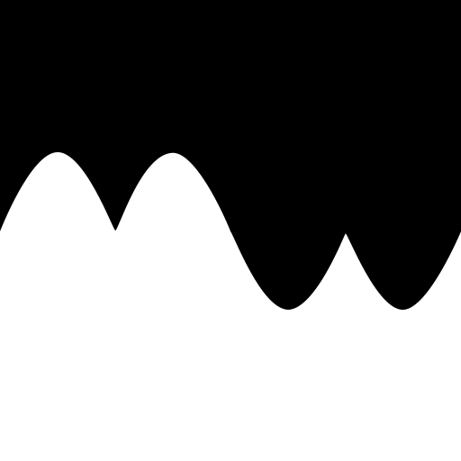

I stumbled across one problem. I need the waveform displayed on the image for haptics purposes. I can generate it digitally, but this has limits by means of my sound card. If there is a way of generating the same waveform at 1MHz it would be a huge playground for me. input is one sine. I guess a shift register, logic gate and op amplifiers are needed, but I can't figure out how.
Any ideas?
I'd use a zero crossing detector, eg. a suitable comparator, feeding the clock of a bistable such as a D type flip flop, so that alternates once each full cycle of the input, synchronised with the zero crossing.
Then use the output of that to control analog switches or an analog multiplexer, selecting either the input signal or an inverted version of the input.
That should give the alternating two positive + two negative peak waveform.
use an analog multiplier like an MC1496 feeding the X input with a sine wave, and the Y input with a square wave of half the frequency of the sine wave.
And don't try to generate the half frequency, just use a flip flop triggered by the rising edge of the sine wave.

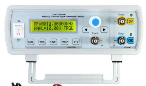

Here is a second option: $54.00 "DANIU FY3224S (FY3200S-24M) 24MHz Dual-channel Arbitrary Waveform DDS Function Signal Generator Sine Square Wave Sweep Counter "
you read my mind.... one other thing is that the square wave must be bipolar, not a logic level. logic level would only turn the sine wave on and off, you need to use a bipolar square wave to have it invert then not invert.

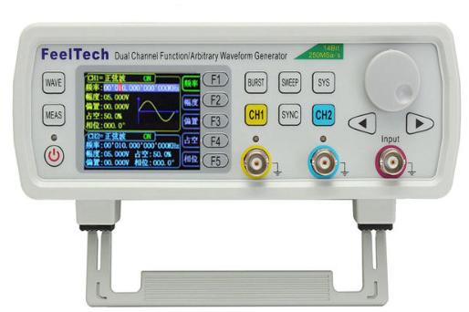

I have a Feeltech signal generator. There is an arbitrary waveform option. I have to learn how to get this wave.
MC1496 modulator is out of option. Only input signal is a sine wave. Flip-flop might just work.
