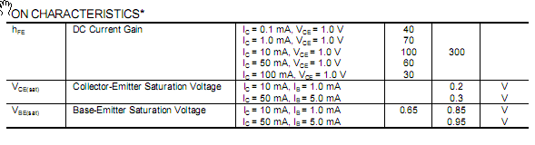

i use the 2n3904 bjt in fixed bias circuit
and determine beta for it and it was 103
then i replace The 2N3904 With The Other 2N3904 so i get beta= 151
why beta change here ?

Look at the spread for HFE from the datasheet.
They cannot make transistors exactly the same unless they are on the same chip like on an IC.
Many things change beta: temperature, voltage and current.
If the bias circuit is designed for the minimum specified beta, then any of the 2N3904 transistors will work in the circuit.

A properly designed fixed bias transistor has an emitter resistor as DC negative feedback. Its current barely changes with temperature change.
The emitter resistor also allows a high beta transitor and a low beta transistor to work the same.
