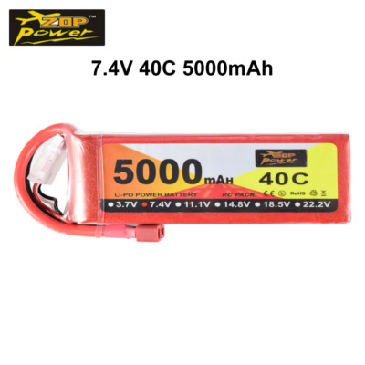

Depends upon how long you want the lamp to stay lit and do you want it rechargeable.
I'd suggest you look at battery packs for RC cars and planes, they are readily available and have high-discharge rated cells.
eg.

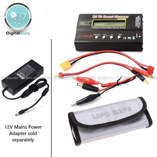

You will also need a matching or universal "balance charger" as packs like that do not have internal balance circuitry.
Something similar to this:
