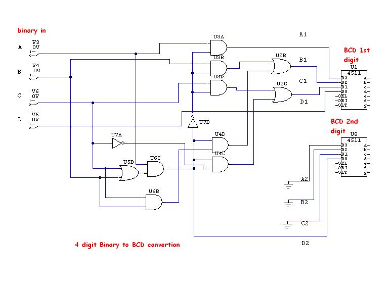

if you are interested in using few logic gates and get it done, see the attached one.

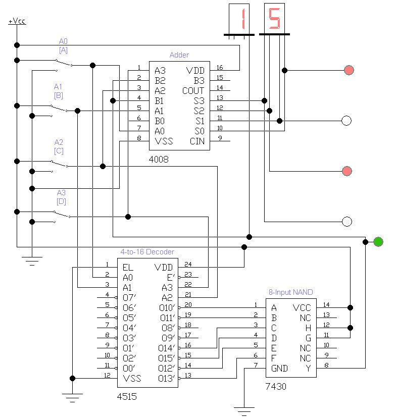

Here's a 4-bit binary-to-BCD circuit that uses 3 ICs: an adder, a decoder, and a NAND gate. The encoder and NAND gate causes 6 to be added to any number above 9, and adds zero to numbers 0-9, for proper binary-to-BCD conversion.
(Note: The 7-segment displays shown have the BCD-to-7-segment decoder built in.)
The circuit could actually be simplified using a digital comparator such as the 4063 in place of the decoder and NAND gate, but I didn't have models for those in my simulator so am unable to prove its operation. The comparator would be wired so that any input above 9 would give a logic 1 output to B1 and B2 of the adder.
