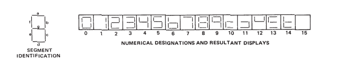

The 7448 LED display pattern is shown in this image.
0 to 9 with 5 symbols
To display 0 to F you require a different decoder or use a PIC.

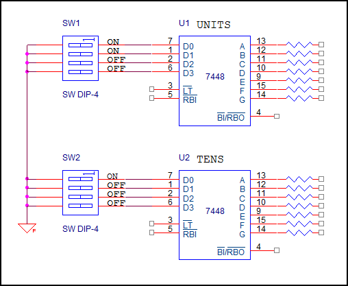

OK since you mention a 7448 decoder driver and since you mention two displays I will assume you want to simply display a number based on inputs to the 7448s? The attached would display a 13 as drawn. Your displays would be Units, then Tens right to left looking at your displays side by side. Maybe this makes sense? I used dip switches to input to the 7448s. All you need to do is place the appropriate pins to common.
That's how I read what you want to do anyway and I may be wrong.
Ron

That won't work. He stated he wanted to convert a 4-bit binary number from 0000 to 1111 to decimal. For that you need a binary-to-BCD conversion.

Oh, I absolutely agree. He also mentioned 7448 and a pair of 7 segment LEDs. I assumed a pair of each. OK, all things considered, what does he want as I am clueless. I am sure he knows what he wants but he can't seem to express what he wants. That leaves an audience guessing what he wants. This is like:
I have two seven segment LED displays. I have two 7448 decoder drivers. How do I display a number between 00 and 99? He states he wants to make a BCD to Decimal conversion and uses 0000 to 1111 as an input. Not going to happen with the parts he listed that I can see?
Beats the hell out of me.
Ron
