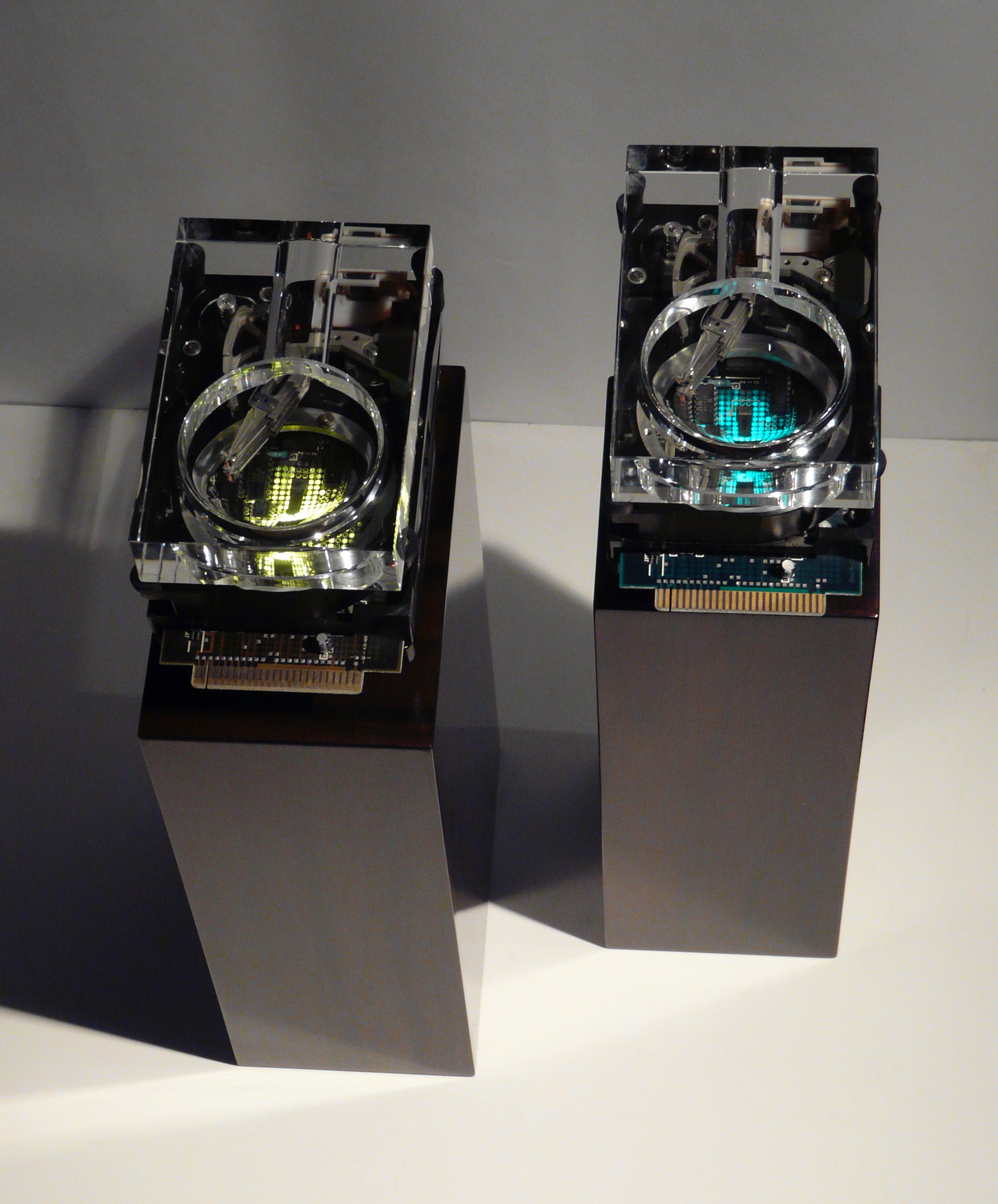

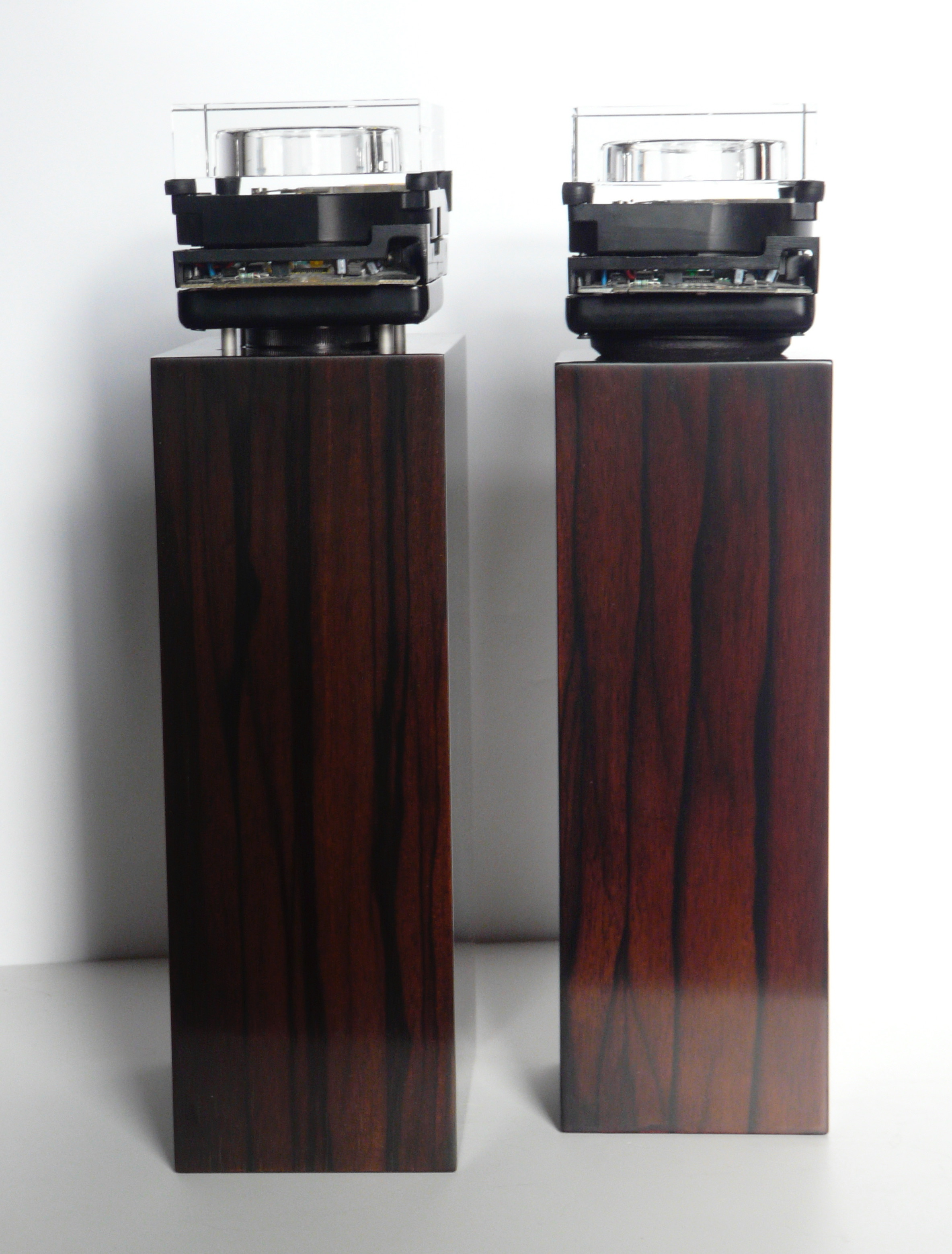

Alec, here's some better photos....when I first made this "Flying Heads" pc. several years ago, I used Mag-Lites to illuminate the hard drive boards...that's one reason they were so tall. Also, I was just starting to learn about wood at that time and thought wood & tech might look nice together.
Anyway, I need to now update it for a european show, that runs from May thru November...I want it to stay lit that whole time, without people there having to fool around with it. Also, I prefer not to have a cord coming out of it.
I liked the idea of using a tac-lite to update it, because of the magnified lens and bright beam that would make the outside lighted element, be brightly lit. I'm open to other ideas too...like reworking the mag-lite itself, which part of it has to stay anyway (see images).
There is plenty room inside, but the only entry is the approx. 2" hole at the tops of the wood portions.

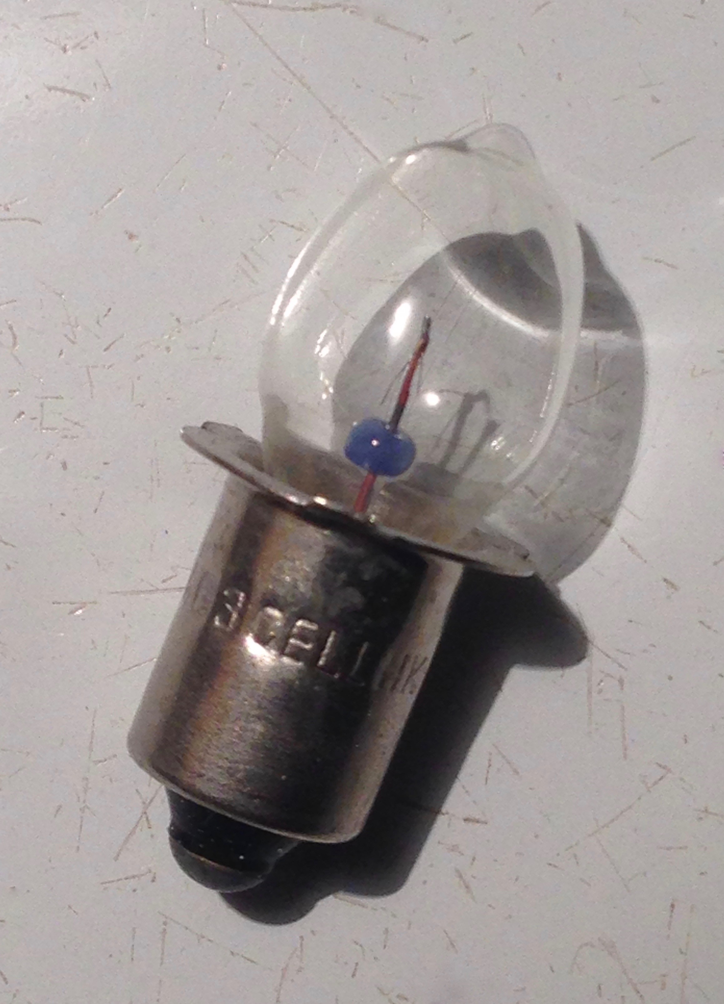

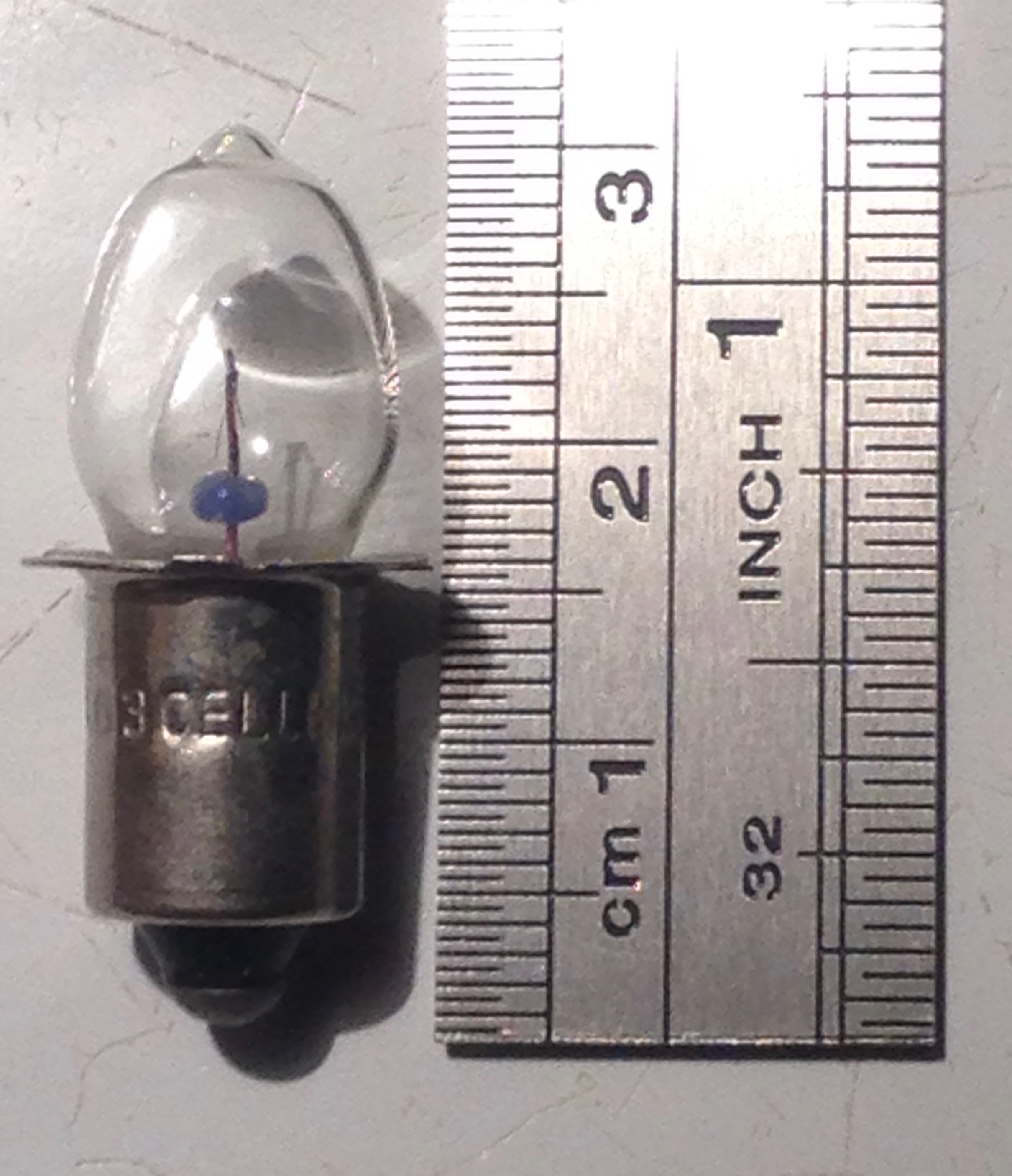

Diver, the Mag-Lites hold (3) D size batteries each (maybe someone makes a spacer if 3 of these is too many). Also, maybe there's a bright bulb that would work with them...attached are images of the standard Mag-Lite bulb (MAG3CELLHK 1E0).
So all I would have to do is get these Lithium Thionyl Chloride D size batteries and new, better bulbs that could handle these batteries.

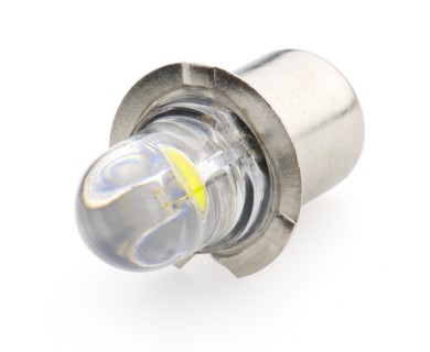

You want a LED replacement bulb. They use much less power. The ones I designed use a PWM. Most will work over a wide range of voltages. Many will have a spec of 2V to 30V or they will say 2 batteries to 5 batteries. (read the data!) Don't use a old type bulb.
