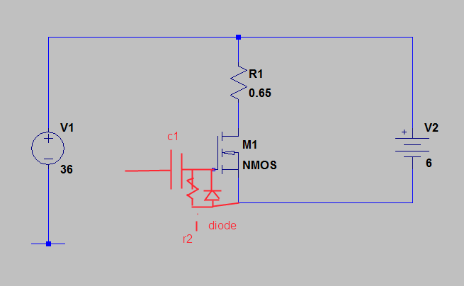

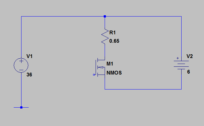

Need some advice here.
How to derive a 10V to 18V gate drive from this situation?

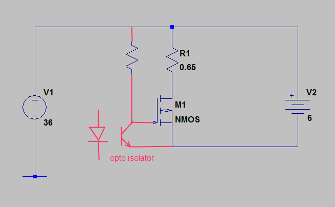

Can you connect the negative of the battery and the source terminal of M1 to the negative side of for V1 while opening the plus connection to V2?
Alternately you can get a logic level MOSFET for M1 (fully turns on at 5V) and use V2 to drive M1's gate.
Disconnecting V1 is difficult as it will require a P Channel FET additional to switch and additional Gate voltage to be generated.
A logic FET gate drive may not hold up as the 0.65 ohm load can cause a Vdrop on the battery which is a D.U.T. and can be undercharged.
You don't need to generate a gate voltage for a P-MOSFET in series V1 and the battery. A resistor from source to gate shuts it off, and grounding the gate turns it on.
If the battery voltage is too low to drive the MOSFET gate then you will need to generate that voltage in some other fashion.
No problem, a gate drive transformer, with the appropriate step up turns ratio from 6v, you can add a turn off transistor on the gate as well if you want.

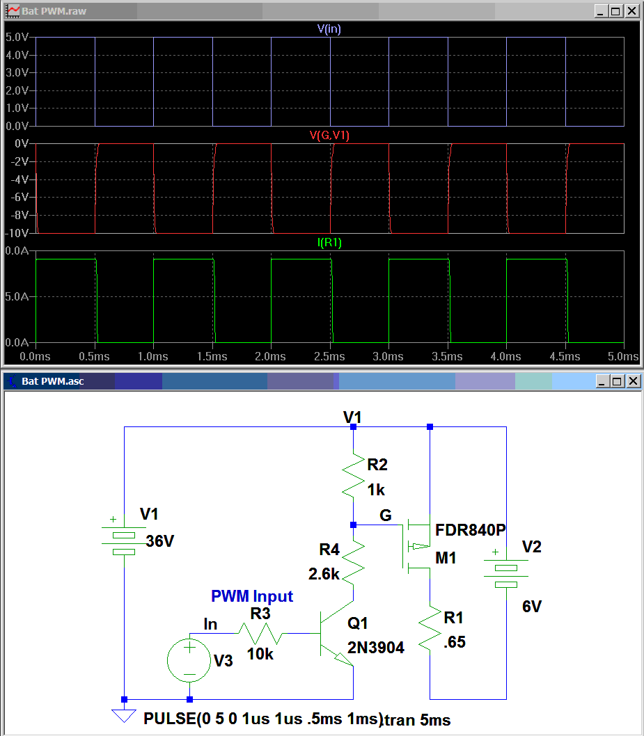

What is the PWM frequency?
Will you ever need to be on 100% of the time? or more than 90% of the time?
Here's an LTspice sim of a circuit that should do what you want.
I changed the transistor to a P-MOSFET to simplify the drive requirements and allow for DC drive if needed.

Rons quite right there I hadnt thought of that a transformer needs a certain time to reset, so max pulse width will be around 90%.
Nice circuit cruts.
This circuit will work only if (from V1- to V2- has less than 0.5 volts of noise)
C1*R2 RC time constant should be 10x of the switching frequency.
Diode makes the turn off voltage on M1 to be -0.6 volts. The gate will go a little negative.
The positive voltage swing will be on the gate.
The duty cycle can not be 100%.
If the duty cycle goes to 0% R2 will turn off M1.
Yes the duty cycle can be 100%. Swapping to a P channel isn't ideal for me.... B.O.M limitations. If cruts can get the N channel to work with a similar circuit, that would be swell!

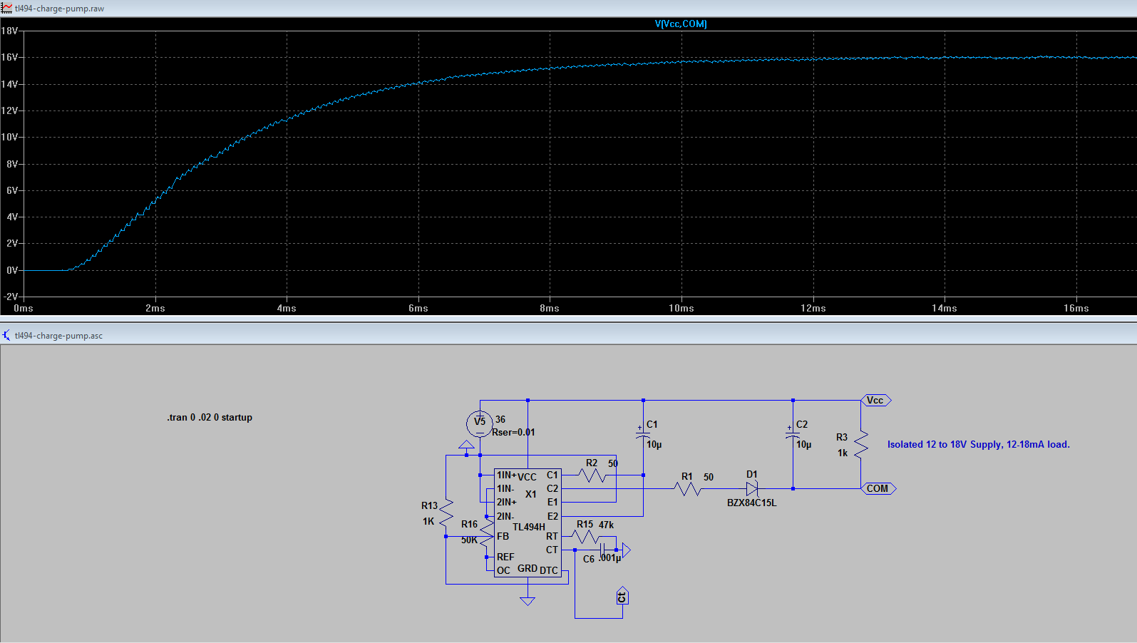

Since the Tl494 is available in my BOM...it looks to be the way to go with the dual alternate NPN outputs with guaranteed dead time.
here is the sim> the isolated voltage is achieved in about 12 mS
  • Chgpump-spice.zip

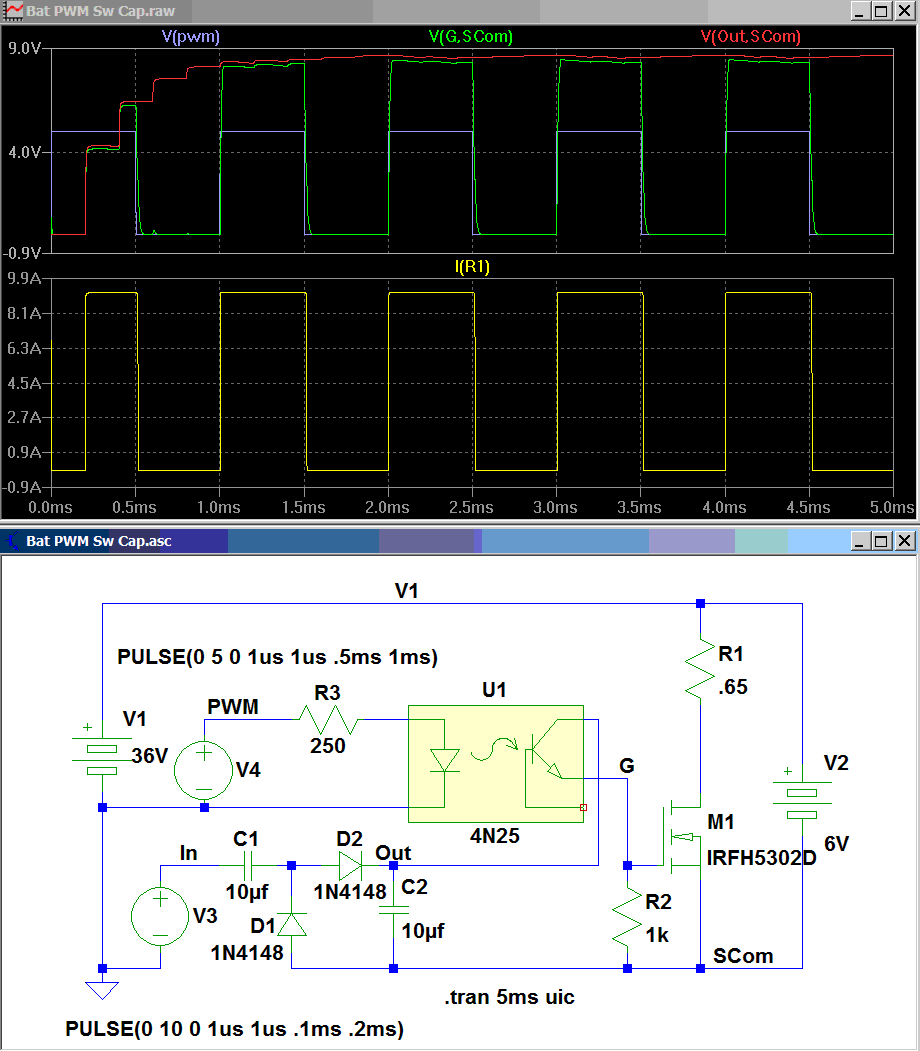

You need to reference that voltage to the minus side of the battery.
Below is the conceptual LTspice simulation of that.
V3 generates the switched-cap voltage referenced to the minus side of the battery (SCom).
V4 is the PWM signal driving the MOSFET gate from that voltage using an opto isolator.
  • Bat PWM Sw Cap.asc
I think that's the best solution cruts. Lower parts count. I have a free OPA in a quad 324 nearby in the cct running on regulated 12V that can produce a 10.5V V3 signal. I'll prototype today!
You can pick up about 0.7V in the DC output if you use Schottky's for the diodes.
