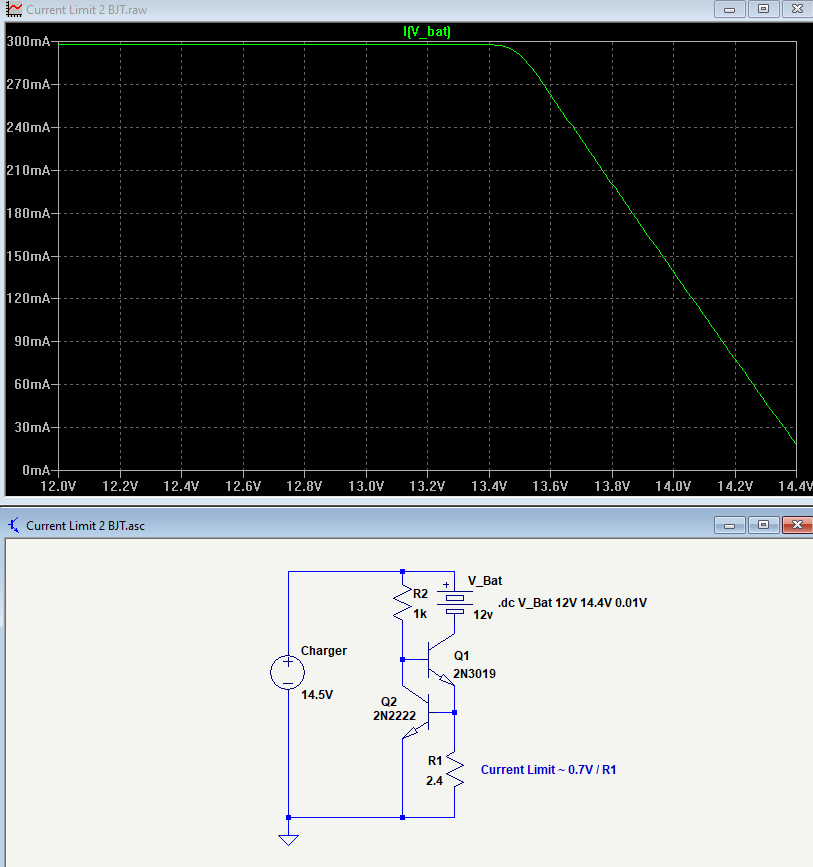

To supply my microphone amplifier with voltage I bought a battery of 12 volt 1.3 Ah, Nedis Lead Battery BALA1300 12 Volt.
Finding a charger for this is not that easy, because this battery must be charged with 300 mA.
Most battery chargers that can be found on the web start at 600 mA with charging, which does not seem good for the life of my battery.
Now I wondered if it is not possible to make a charger with an LM317 that has a charging current of 300 mA, but which also stops charging when the battery is full.
Does one of the Forum members have an idea to solve this problem?

You can readily adjust the charge current of an LM317 to 300mA but, to determine when the battery is full, you need to monitor the current and shut off the charging when it drops to a low level.
That requires more complicated circuitry or a microprocessor to monitor the charge.
The best solution would likely be to purchase a smart charger with a 600mA limit which automatically drops to a trickle-charge when the battery is full, and add a series current limit circuit for 300mA to its output.
A simple two-transistor current-limit circuit is shown below.
It limits the battery current (green trace) to 300mA.
As the battery voltage rises (horizontal axis), the current drops and, at some low current, the smart battery charger should drop to a lower voltage trickle-charge.
A good 600mA charger will be fine with a lead acid battery (1.3Ah). As long as the charger has voltage control it will adjust as needed. Here is some advice from battery university...
