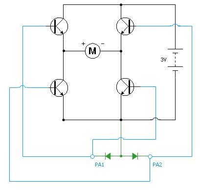

I think I'll just stick to two pins per motor. All I need to know is how to connect the circuits so that PA0=1 and PA1=0 makes the motor go forward, PA0=0 and PA1=1 makes it go backwards, and PA0=PA1 prevents any of the BJTs, MOS-FETs, or whatever else might be used in the H-Bridge, from opening. I don't know if the suggested IC handles all this itself, but either way I would like to know how this behaviour would have been achieved with my schematic, even if the schematic wouldn't work for other reasons, since it's bugging me now and I don't see any reason why a link between the battery ground and PA0/PA1 via diodes wouldn't work... If someone could please answer this question I will be very grateful. I have asked several times now but I've only ever received answers to questions I didn't actually ask...
Even if I find out that the IC will handle all of this, I would still like to know why this aspect of my schematic was incorrect.

I don't see any reason why a link between the battery ground and PA0/PA1 via diodes wouldn't work... .
Isn't part of this answer just that we just connect the PA0 & 1 signals to whatever suitable h-bridge is chosen?
But the rest of the asnwer, is to do with the link (green diodes) you mention between battery ground and the PA0/1 signals. That is a strange configuration I have not seen before, I can't get my head around it. I'm afraid you're going to have to explain the theory behind (if you have before already, I'm sorry I missed it, please try again). You teach us please :)
Okay my theory is this:
When PA0 is 3.3V and PA1 0V, the current flows out of PA0, through the bases of the top left and bottom right transistors, and ultimately ends up at the battery ground, where I joined those green wires to. The wire splits into two diodes, and the the current should flow through the diode to PA1, completing the circuit.
If the inverse is true, i.e. PA1 is 3.3V and PA0 is 0V, the current will flow through the bottom-left and top right transistors, again reaching the green wires connected to the battery ground, and this time the current will return to PA0.
When both PA0 and PA1 are at 3.3V, there is no voltage between the two terminals, since they are both high. No current flows, so none of the transistors allow current to pass between their collectors and emitters; the motor stops.
To clarify, the only reason for the diodes in the green wires is because without them, there is a direct conductive path between the two terminals, so virtually no current will actually reach the transistors.
Please let me know if you can see any holes in this theory.
Schematic has been added to this post as requested by marcbarker. Black denotes the H-Bridge, Blue is the uC output connections, and green is the wiring providing the uC output with a route back to ground via whichever port is connected to ground.
Note that I haven't updated the schematic yet, so I may well use that IC suggested my blueroomelectronics, and will certainly add resistors to the blue circuit to limit the current passing through the uC terminals.

I need a picture, sorry :) can you edit the previous posting and add a schematic (again? sorry), with this scheme on it, so there's no chance of making an error understanding it.
EDIT I'll take a look later and post
