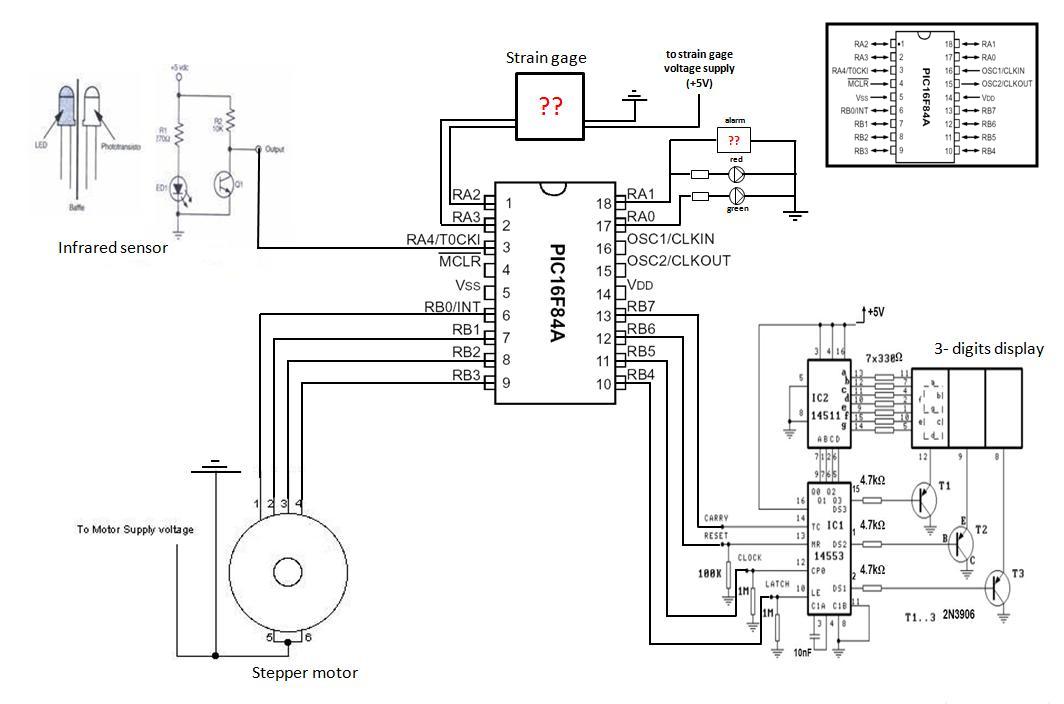

I am planning to do this project
I already collect all information and all specification of each item I need, but still something missing
I could not find the suitable strain gage and alarm
The stain gage should give us 5v for the maximum weight which should be between 0 and 15 kg.
You can see the attachmented files to get full idea about the project and the specification
Please check the circuit in the given files.
If you have any modification for the circuit or any addition please inform me because my experience does not help me that much and I'll be thankful.
circuit diagram:

hi,:)
The problem is that strain gauges or load cells will only output millivolt signals.
Much too low a level for the PIC's adc input.
You require a high gain amp [opa] to amplify the mV signals to a voltage level suitable for the PIC.
Do you follow OK.?:)

A couple of questions, are you configuring the strain/gauge into a bridge or do you plan to use a single strain gauge element.?
Also what is the specification of the strain gauge,
ie: mVoutput per Volt, excitation voltage and the voltage required at the output of the amplifier.?
Knowing these parameters I could post a circuit diagram.:)

You may have to use an external A/D or scrap that ancient 16F84A and use a PIC with a 10 or 12bit A/D built in, the 16F88 is a good choice if you only need a few I/O pins. You can get high resolution A/D converter ICs with 8 to 24 bits of resolution.
Also you'll need a stepper driver, you can drive a motor directly with PIC output pins.

The limited information you are posting is not sufficient to enable me to design a strain gauge amplifier.
If you require to measure at load upto 15Kg using standard 10bit PIC adc, that will give a rough resolution of 15/1023 = 0.014Kg, say 15gm.
Is this resolution acceptable.?
Also if you make up a strain gauge bridge, will all 4 elements of the bridge be strain gauges or will it be 1 strain gauge and 3 high stabilty resistors.
What will be the bridge excitation voltage and OPA supplies.?
YOU must decide which strain gauges you plan to use.:)
