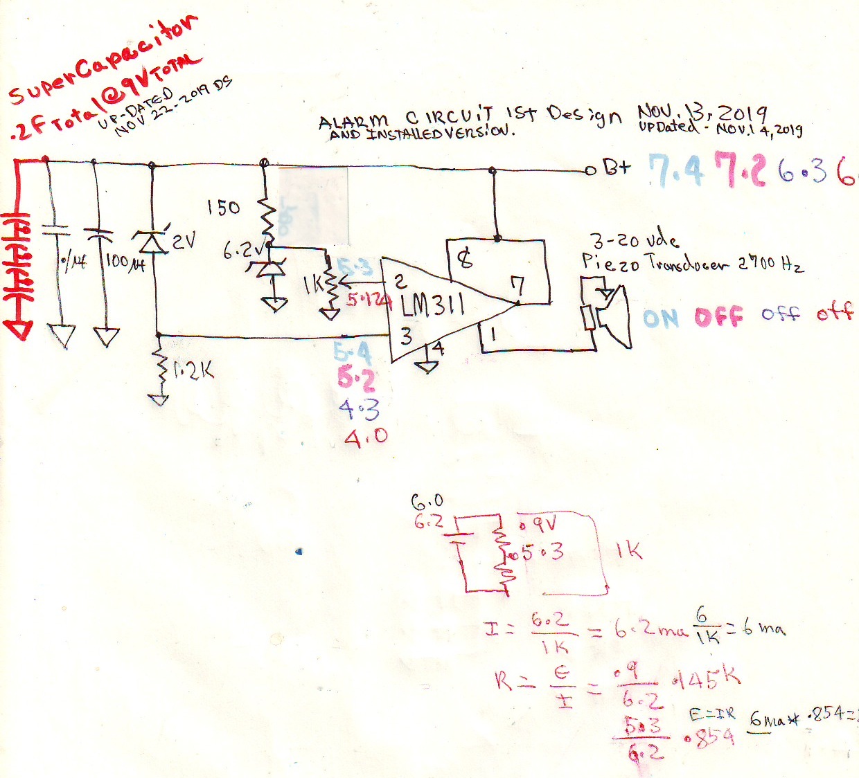

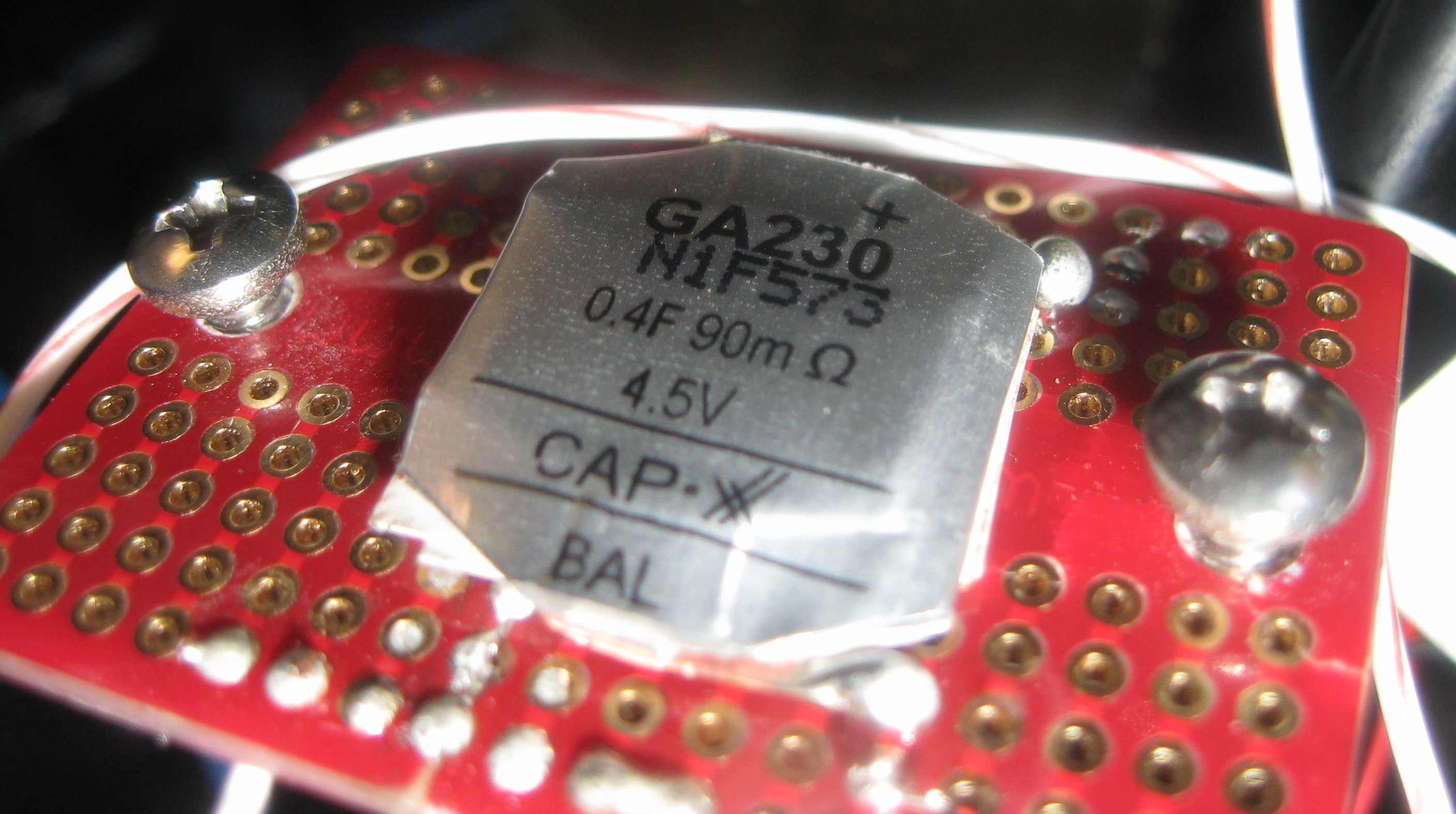

Added 2 0.4F @4.5 VDC SuperCapacitors in series to the power at the ignition switched 6 volt where the Alarm Circuit is and it worked nicely to eliminate the noise which was like little crackling sounds the alarm circuit was making. in the 6.8 to 7,2 volt range. Note the car does not shutoff for about 1 second now when the key is turned off. The voltage reading however are a little higher. Just wondering though. Would it be better for the SuperCapacitor if it were on the Un-Switched side of the ignitions switch? It would then stay on all the time but may be harder on the Ignition Switch? Also just wondering, do SuperCapacitor's ever catch fire?
Alarm Circuit installed November 2019:
The Alarm Circuit has proven it's self and saved overcharging several times with the various failures including the last one caused by a failure of the 6.8 Volt Voltage Reference diode. There have been Zero problems since with anything.
Hi Dan,
supercaps can fail from overvoltage, I don't know if they can catch fire.
Possibly a 1A fuse may be an idea, just in case?
With two or more in series, add equalising resistors across them to ensure the voltage across either one does not creep up over time if the leakage is different between the two.
That should hopefully avoid any problems.

It's good that I revisited your comment "rjenkinsgb:" As I never fused this separately from the VW's fuse if I even have it on the fuse side of the fuse block, I need to check. It should be and be on the instrument circuit, I will check this. One thing is it's located just behind the dash where if the supercapacitor did short out it would smoke things up and smell and be quickly noticed. One thing that is good is that the supercapacitor chosen for this application worked out very nicely and is still performing flawlessly without resistors.
