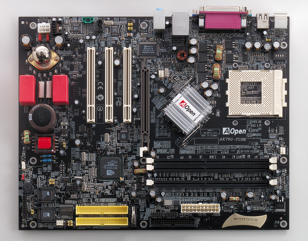

If your laptop uses vacuum tubes in its output that feed a matching transformer then it needs a load.
You know, I thought a tube used in a computer sound card would be just crazy enough, so I googled it. You can get one for your desktop. :rolleyes:
A Tube Soundcard: YES! - The T-T computer: tubes and transistors - Softpedia
Upper left corner:
ak79gtube-jpg.33128
Some people like the distortion caused by a vacuum tube amplifier and its lack of damping of a speaker's resonances.
