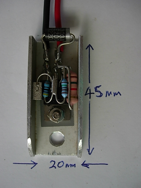

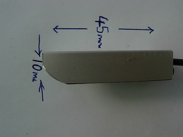

You want electrical isolation and good thermal resistance, My favorite is the Sil-Pad because it does not require heat sink grease. My second favorite is kapton. I'm not crazy about Mica. You want ow thermal resistance on the back of the TO-220 transistor.
Kapton tape can surely help in the construction. The Silicone adhesive is good to about 200 C. It's also available with an acrylic adhesive. I have both tapes at home. I used the Silicone adhesive regularly at work (semiconductor research lab).
You could probably get away with a larger piece of Kapton tape with silicone adhesive that essentially fills the C-channel and some thermal grease on the other side.
If you read into the details, I would get a TO-220 mounting kit instead of a nut and lockwasher. The bellveille (dome shaped) washer used is superior to lockwasher. see: https://en.wikipedia.org/wiki/Belleville_washer

It doesn't mater what shape the capacitor is, I used the smallest I could find at the time. Heres the dimensions.

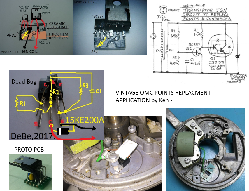

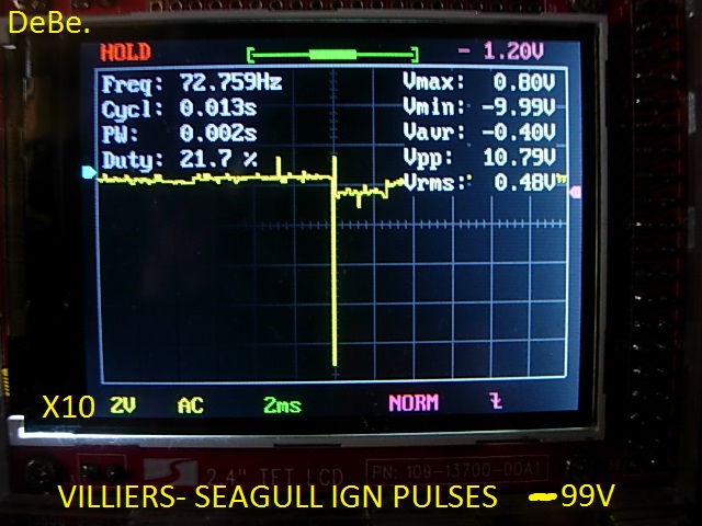

This is what voltage spikes the unit has to deal with just at cranking speed. The Villiers coil doesn't have that high a voltage. But the Wipac is mutch higher & this was the reason for the Mosorb as it would eventualy destroy the module. This is why Nova modules fail on some ignition systems. Note these 2 ign systems are diferent polarity.
The Mosorb is there to clip high voltage spikes. I found some Ign coils would destroy the switching transistor. So its there for reliability, I did not think $2 each was that expensive.

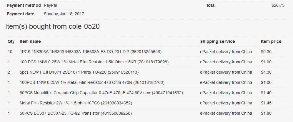

Now I will wait 2-4 weeks one stop shop for 10 complete RED ATOMs
Note: I contacted the seller to swap in 1.5K Ohm 2W resistors looks like I selected 1.5 ohm

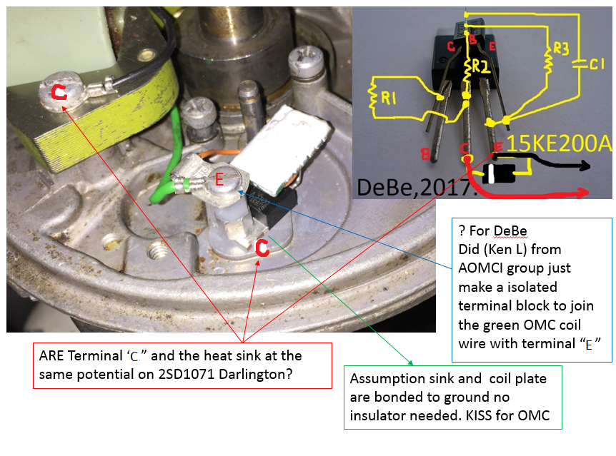

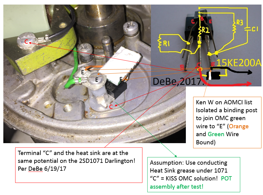

Just swap the red & black wires.

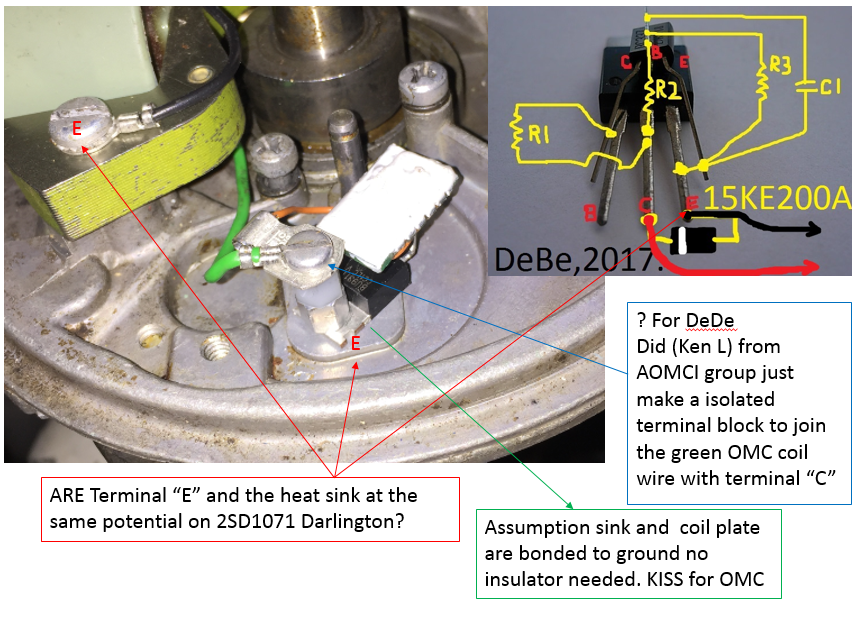

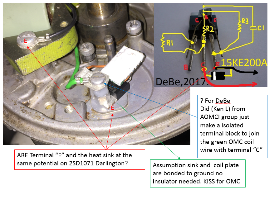

Ken on the AOMCI list you gave this same advice to Ken L. in his application and it worked great! He posted the picture below of his proto board version in a OMC outboard without a insulator and some wiring that is not obvious.
My questions are in the image below:
Matt
I'll be the devil's advocate here. Why? The darlington construction may keep C from being the metal tab. See: https://www.onsemi.com/pub/Collateral/TIP140-D.PDF. It's a darlington, no no mention case is tied to tab. For a 2N3055, the case ties to C is mentioned. https://www.mouser.com/ds/2/308/2N3055A-D-43225.pdf
Usually C is the case. Easy enough to check if I someone has one. Here, I THINK it's isolated.
The terminal looks like it's made from an Aluminum M-F spacer with another M-F Nylon spacer.
The Assembly does need poting as it wont survive vibration. KISS the tab is electricly connected to C on all of these transistors we are using, in the above picture the tab is part of the circit to ground on this particular outboard. UTC are the same specs.
