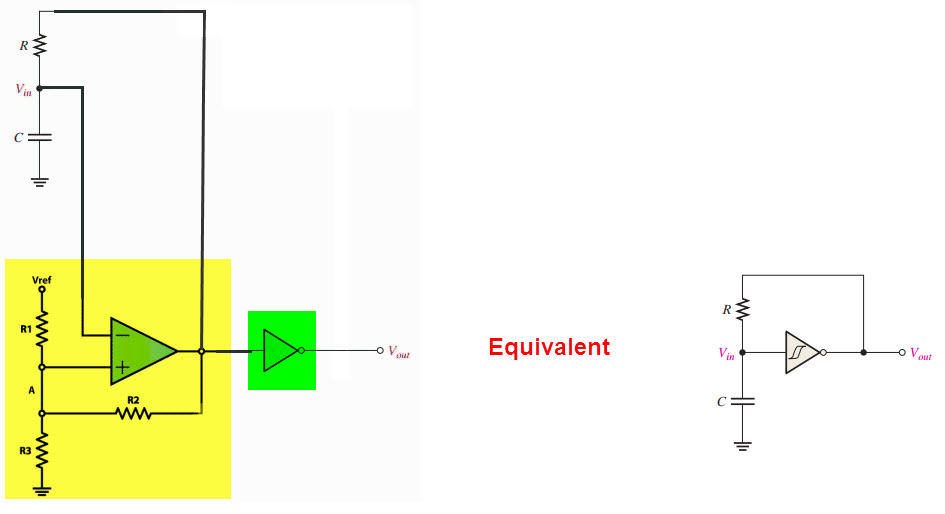

Could you please help me with the questions below about astable multivibrator?
Question 1:
Please have a look here. Is the input voltage, Vin, going to be lower than the output voltage, Vout?
As soon as Vin is applied, Vout goes HIGH and as it's greater than Vin therefore current starts flowing from the output, Vout, into capacitor C through R.
Question 2:
This question is also based on the text from Question 1. Are the shown circuits equivalent? In yellow we have schmitt trigger, green is inverter.
Thank you!

Vout will switch to (almost) supply voltage and 0V, depending on input level.
Once the oscillator has stabilised, the input voltage will probably range between about 1/3 and 2/3 supply. Each time the cap charges or discharges to the input switching threshold, the output will change state and swap between charge and discharge.
The other circuits are not equivalent as the first stage is an inverter, then with a second inverter added. There is no overall inversion so it will stay in one state or the other rather than oscillating.
The feedback resistor would have to be moved to the output of the first stage to make that an equivalent; the added inverter is then redundant.

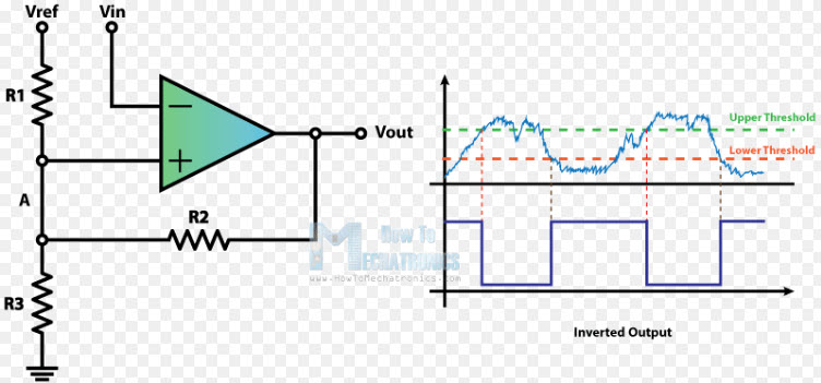

Isn't the first stage, highlighted in yellow, just a schmitt trigger circuit?
By the way, this is actual schmii trigger I used. Perhaps, a schmitt trigger circuit in itself an inverter circuit?

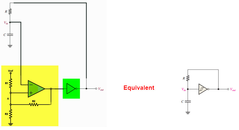

Like this?
Thank you for your help and time!
Yes, but the way it is configured means the output is inverted relative to the input, the same as with the single CMOS inverter version.
Near enough, except for the extra inverter on the left hand version.

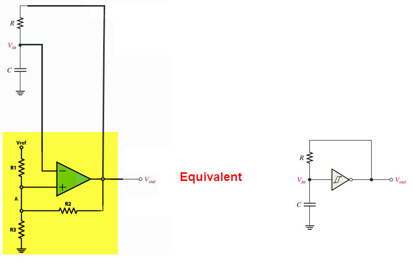

Please have a look here. I have removed the inverter. Is it more like it now?
Assuming I have it correct now, Is the configuration called 'inverter with hysteresis'? As a matter of fact, all my confusion started with second para from original text where it is said, "Figure 7–55(a) shows a simple form of astable multivibrator using an inverter with hysteresis (Schmitt trigger) and an RC circuit connected in a feedback arrangement". I started asking myself 'how does an inverter with hysteresis look like?'.
Yes.
The hysteresis part makes it a schmitt trigger, whether it inverts or not.
The inversion allows it to work as an oscillator in that configuration.
A 555 timer can be thought of in a similar way; the hysteresis is produced by two separate voltage comparators rather than changing thresholds via feedback as with your example circuit, but the end effect is similar - two different voltage thresholds which cause the output to change state.
See the diagram "50% Duty Cycle Astable Oscillator" half way down this page, for a 555 osc circuit that's pretty much equivalent to the schmitt trigger inverter oscs.
