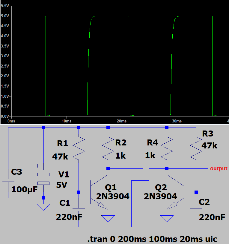

what type of multivibrator is this?
Sine wave oscillators are very complez designs that would require different driving stages. I would use an MCU, or ic555 and cd4047, but I just wanna be a little bit non-complex for a while :)

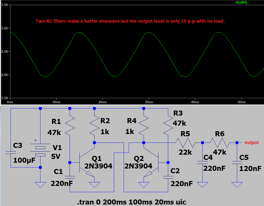

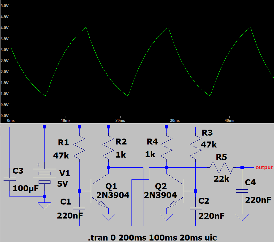

Here is a simulation of the squarewave, then with one RC filter to make a lower level triangle waveform, then with two RC filters to make an even lower level poor sinewave:

Ok. I see now. I am thinking of an RCL circuit, mabe that would do the trick and also, how do I calculate the values of R2 and R3 in an astable multivibrator? Its really confusing to rearrange the formula..
