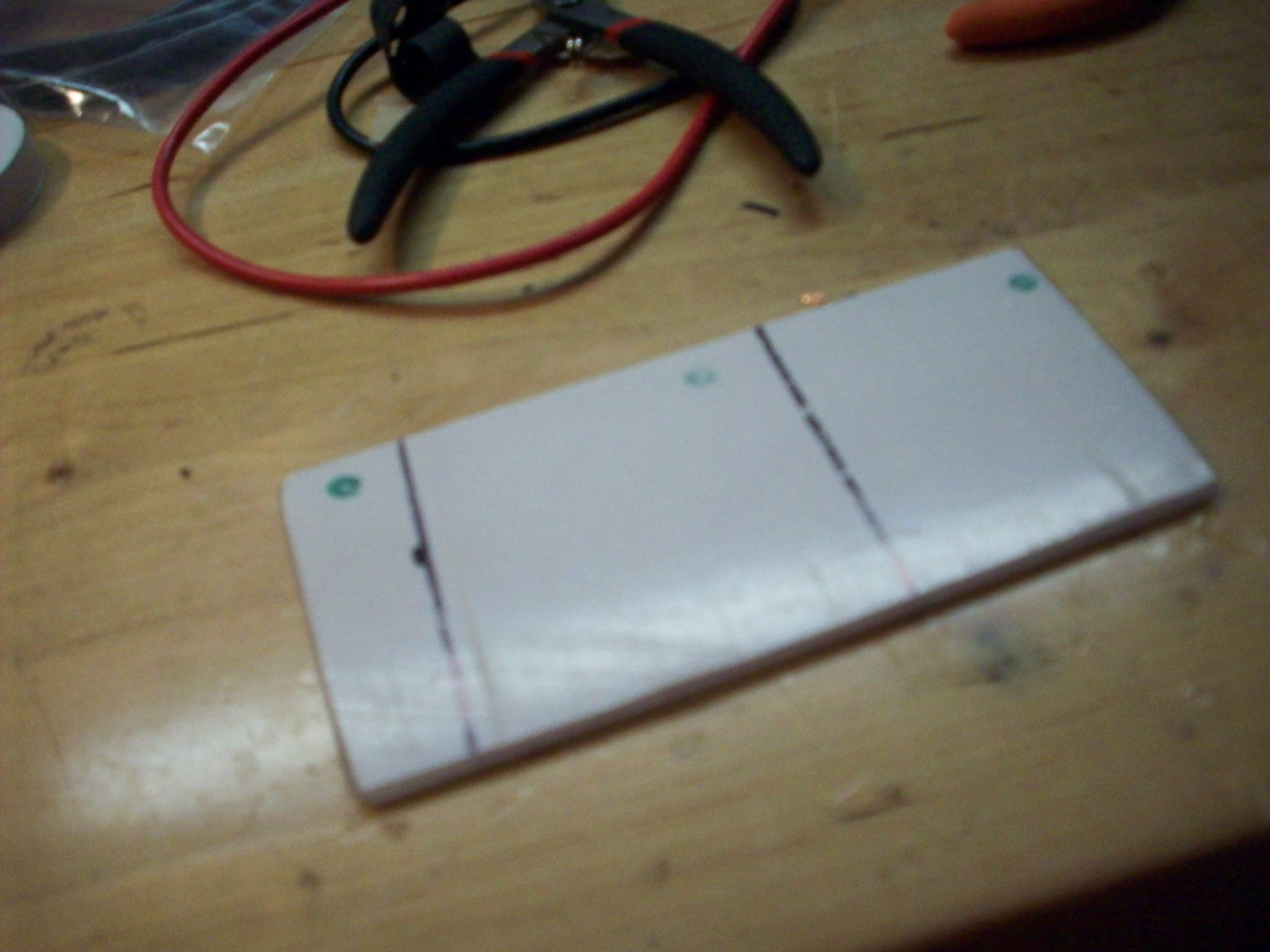

ARES 001
A picture of one of the lexan pieces. I am making better ones today.

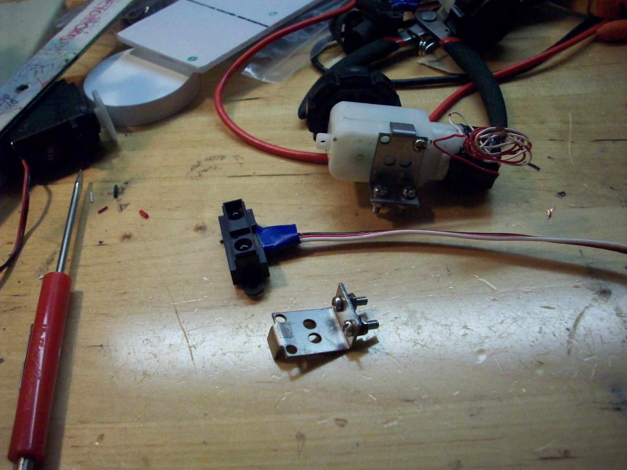

ARES 002
Picture of the Motor, bracket and a SHARP IR sensor

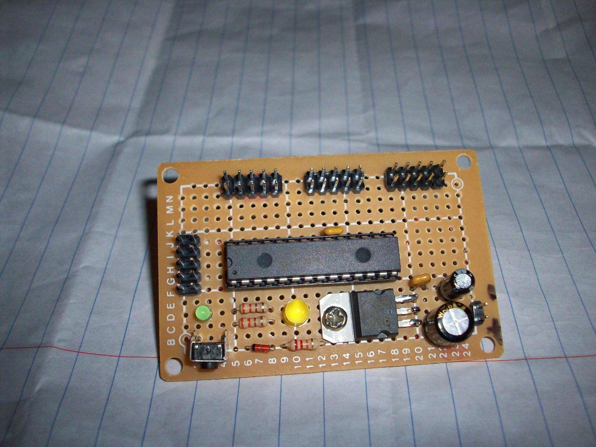

ARES 003
Picture of the ARES1 Motherboard, with a 18F2525 in. The LED's appear lit but they aren't. The green LED is the reset LED which turns on when MCLR is low.

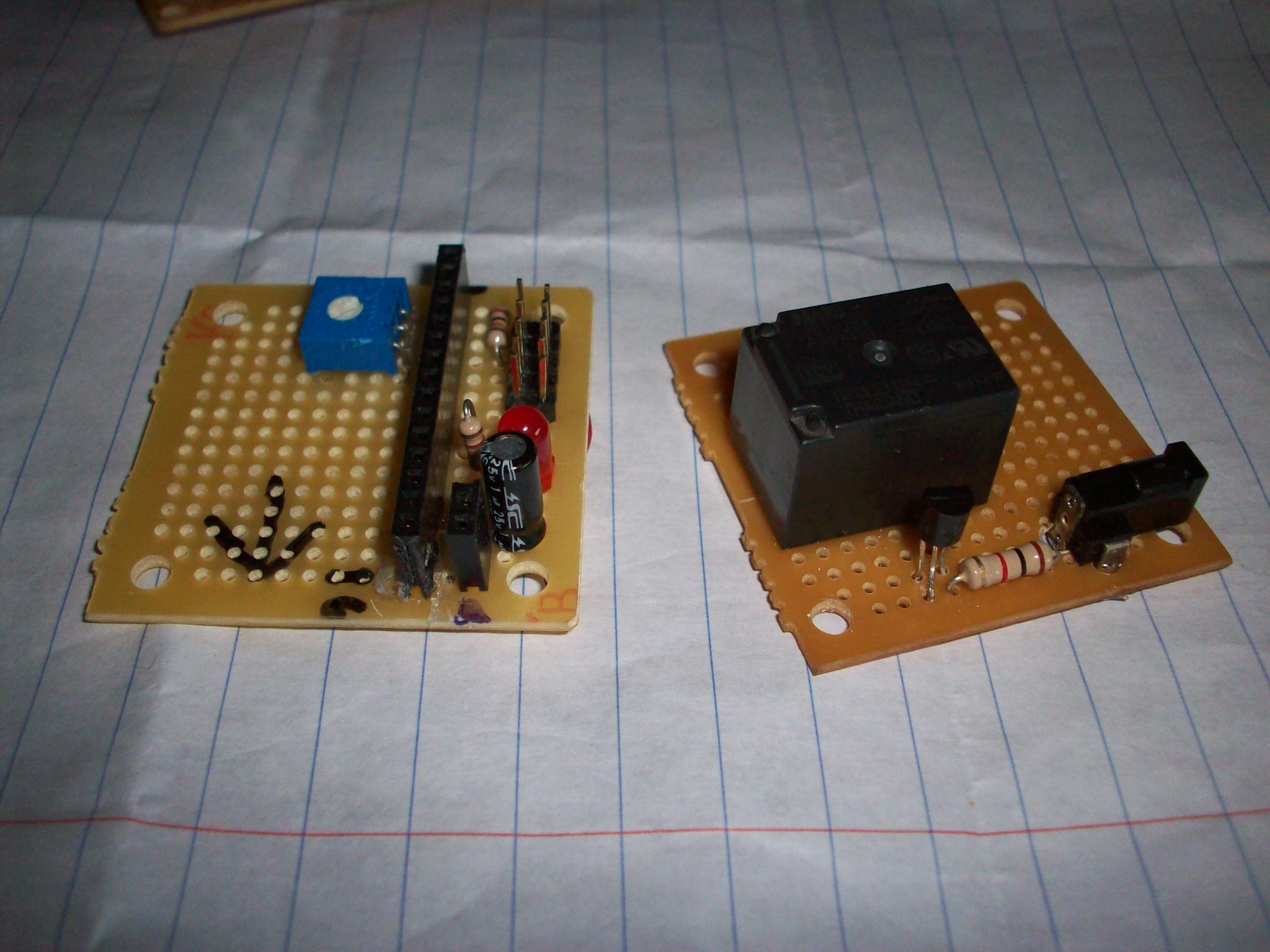

ARES 004
Pictures of the LCD Module on the left without LCD and the Automatic Battery Charger. It will signal a LED and a alarm when the voltage drops too low. It could also trigger the robot to look for a power source, an idea that I have.

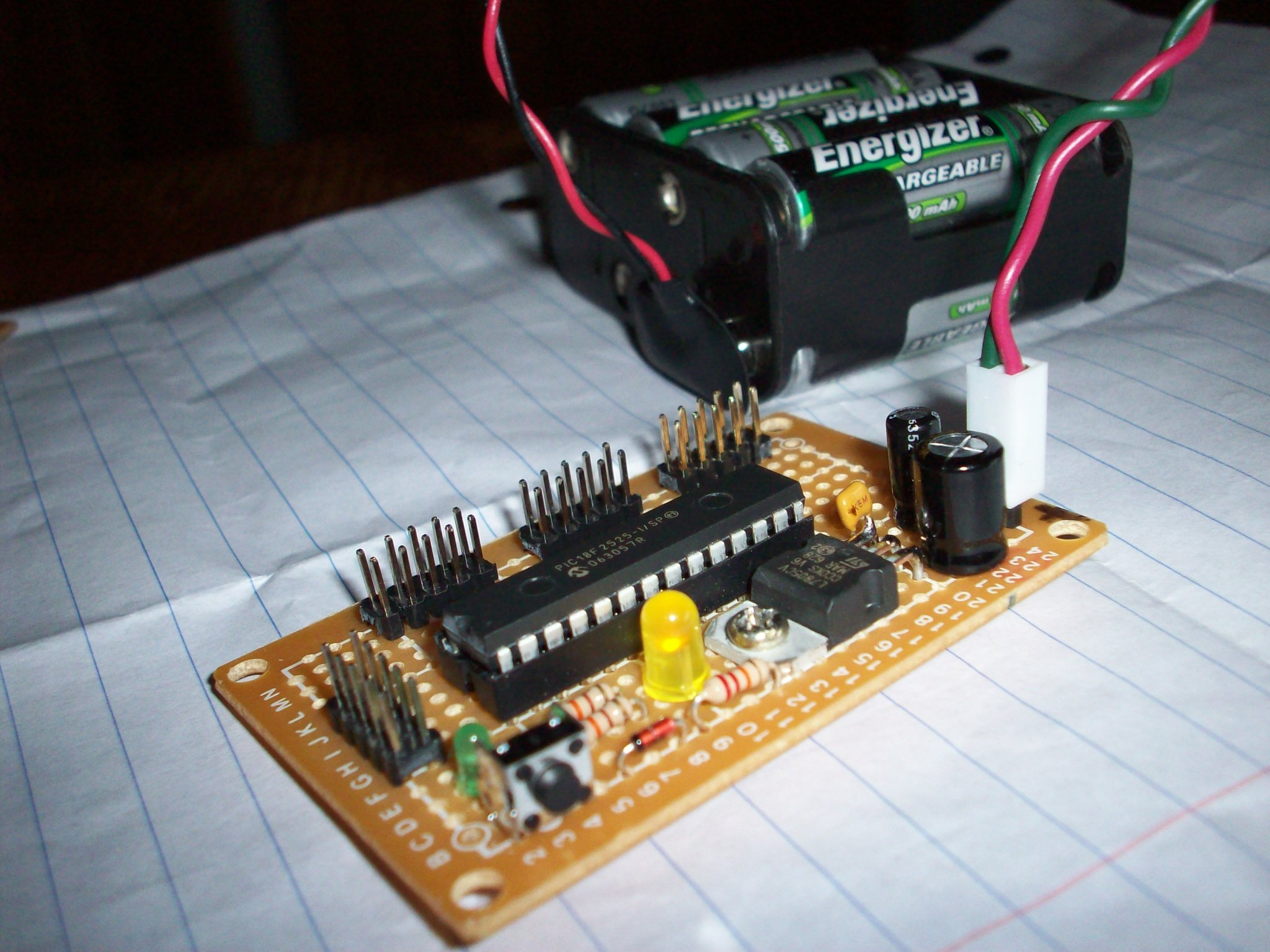

ARES 001
This is a picture of the main controller board, a 18F2525 (picaxe pfft!) with reset button and reset indicator. The LED indicates when the chip is held in reset. For testing I added a 5VDC regulator and a bulk capacitor. Those will be removed once the power board is complete. In the top of the controller board there are 4 2x5 headers. going from left to right they are: Program port, PORTA PORTB PORTC. The Yellow LED indicates power.

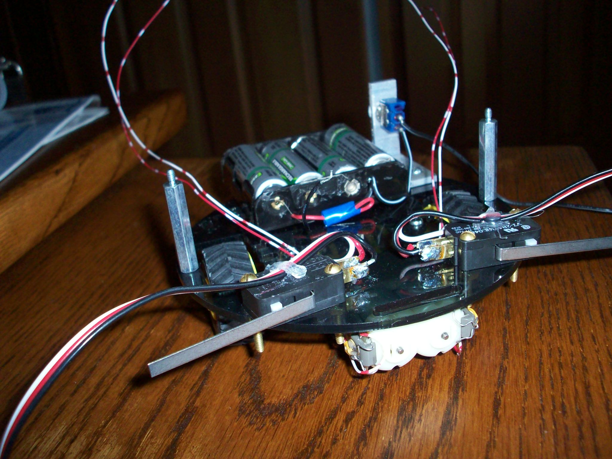

ARES 003

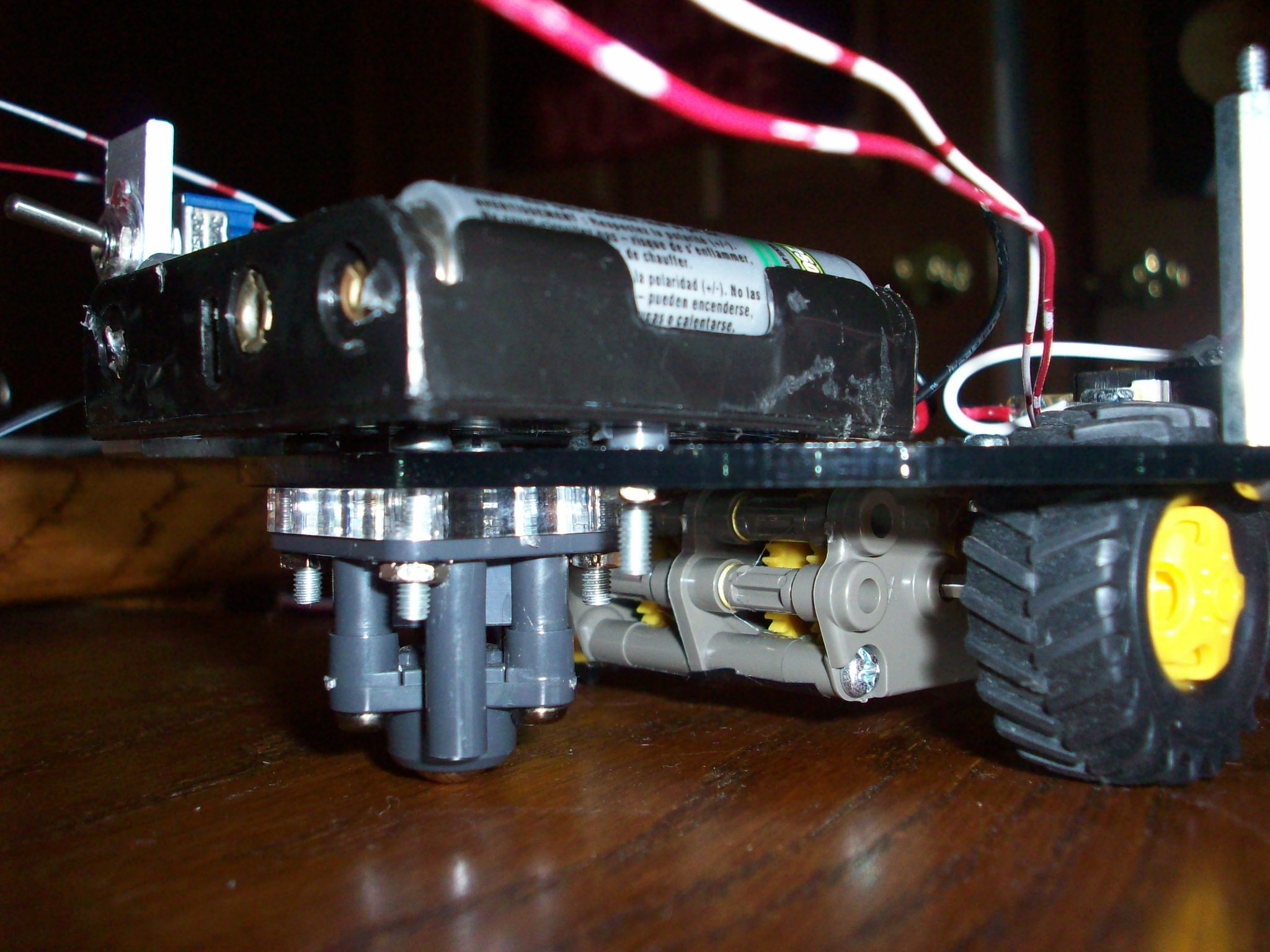

Picture of the robot with motor wires hanging out. Those will be shortened and fixed up. Whisker switches/micro switches are also visible with their wires (chopped off PWM servo wires) hanging out. Those will be attached to 3 pin female connectors;

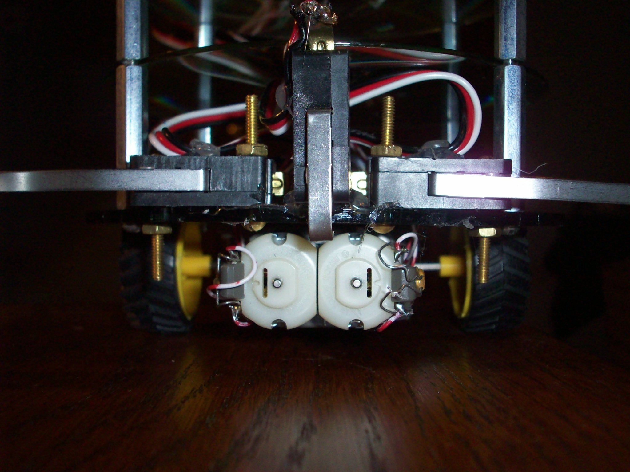

ARES 004
Front of the robot. You can see the motors and the capacitors attached to them. Another shot of the switches.

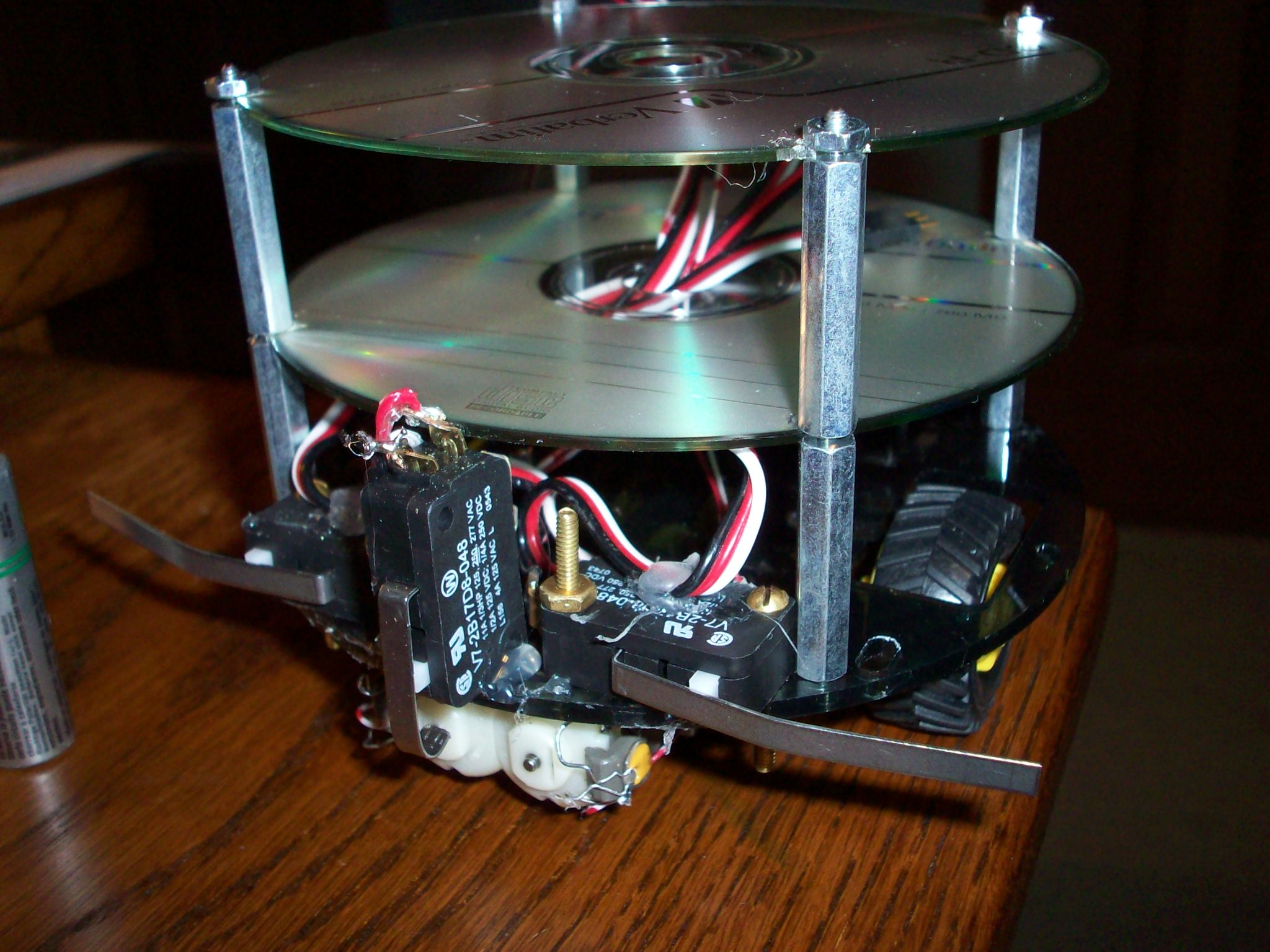

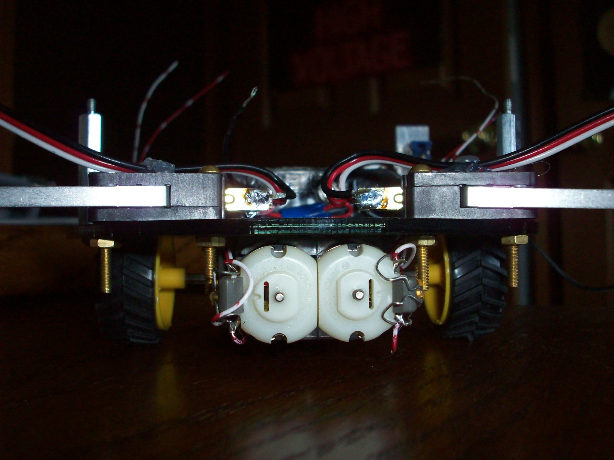

ARES 006
Side view of bumper switches (left, front and right) as well as the battery pack in the back. You can also see all the wires coming out of the side as well, which will be wired up soon.

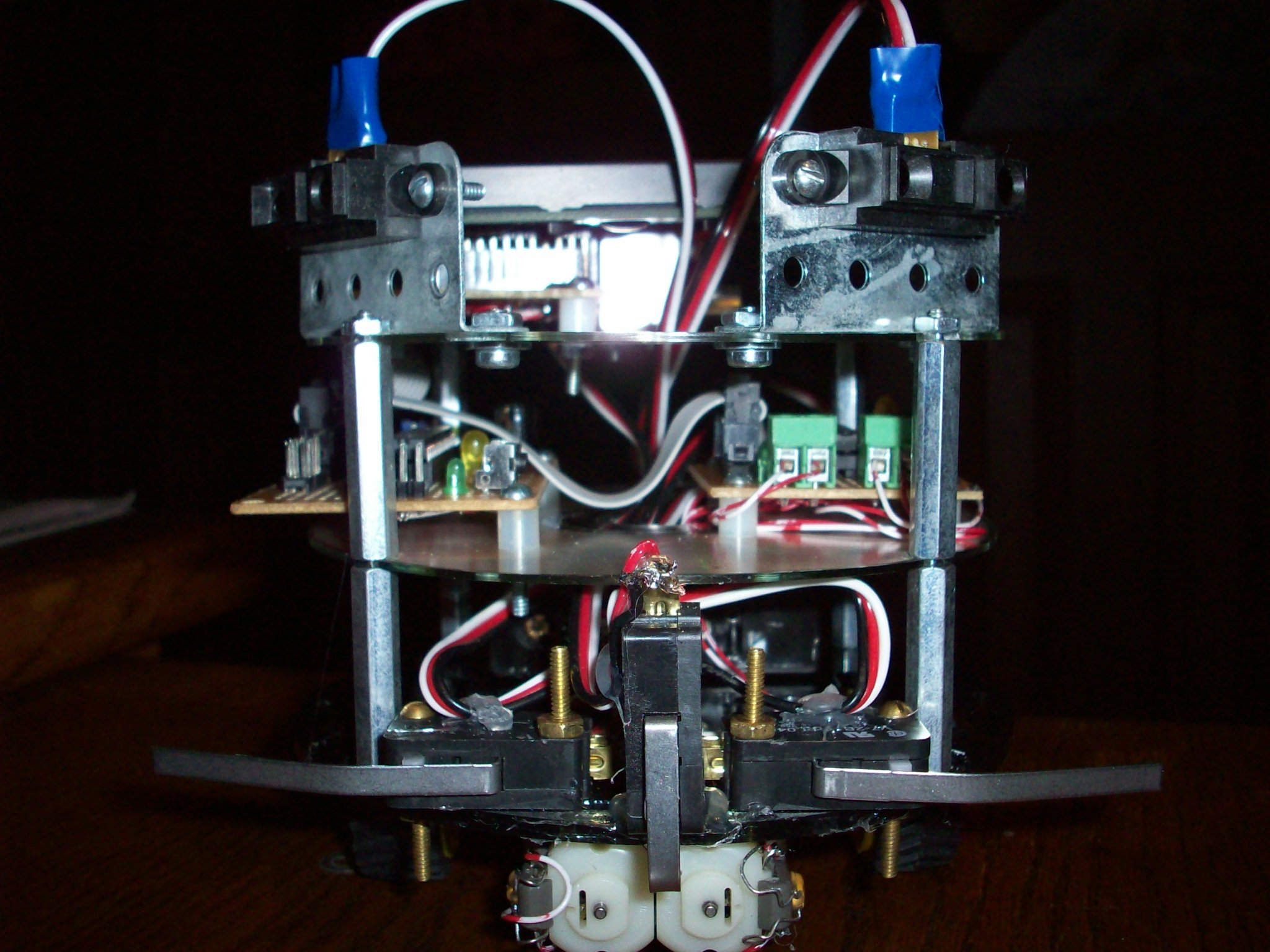

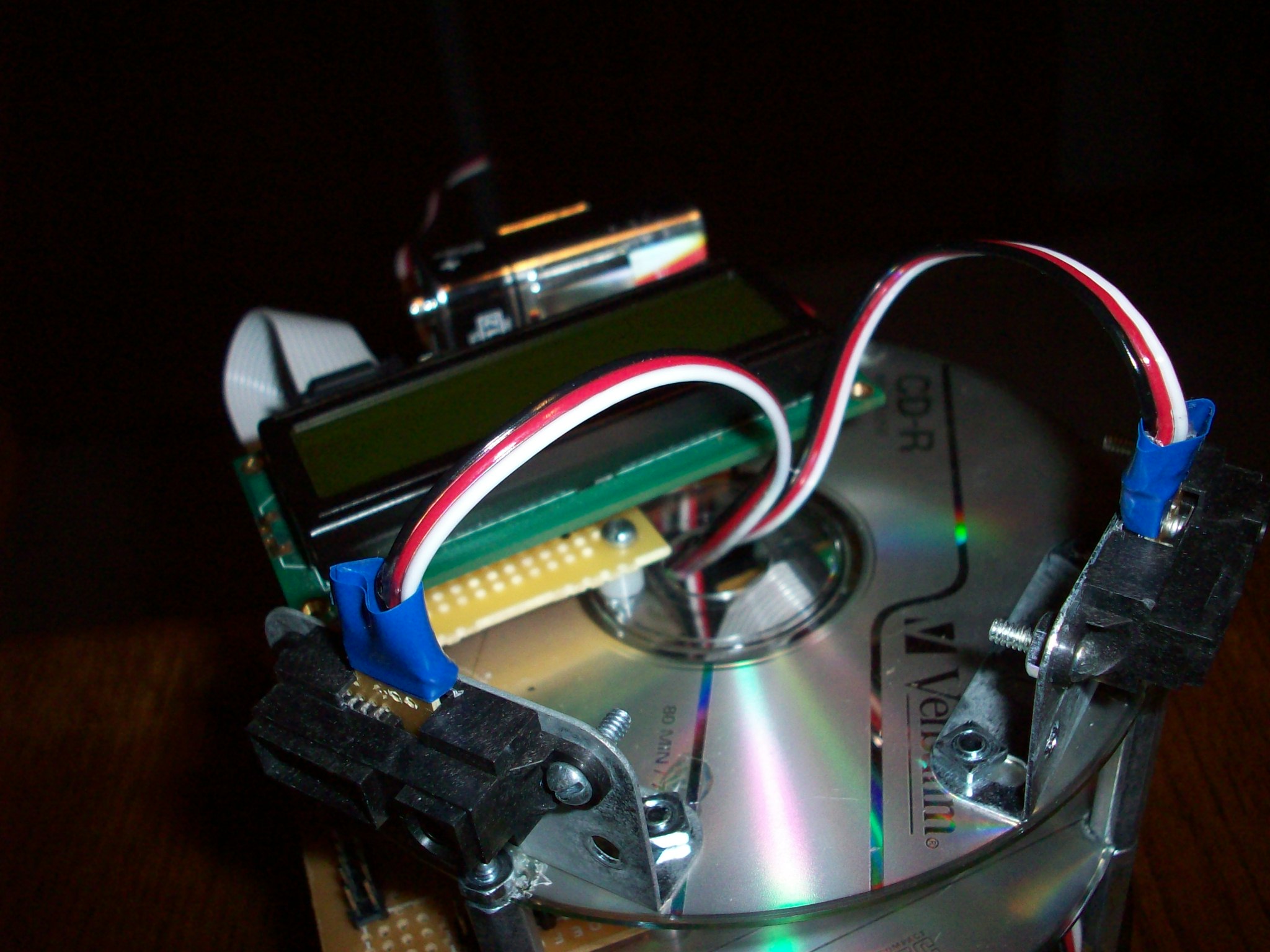

ARES 007
Front of the robot with the sensors. This will allow ARES to know if it hits any walls and will react accordingly. All programming will be done resembling NAOS multitasking.

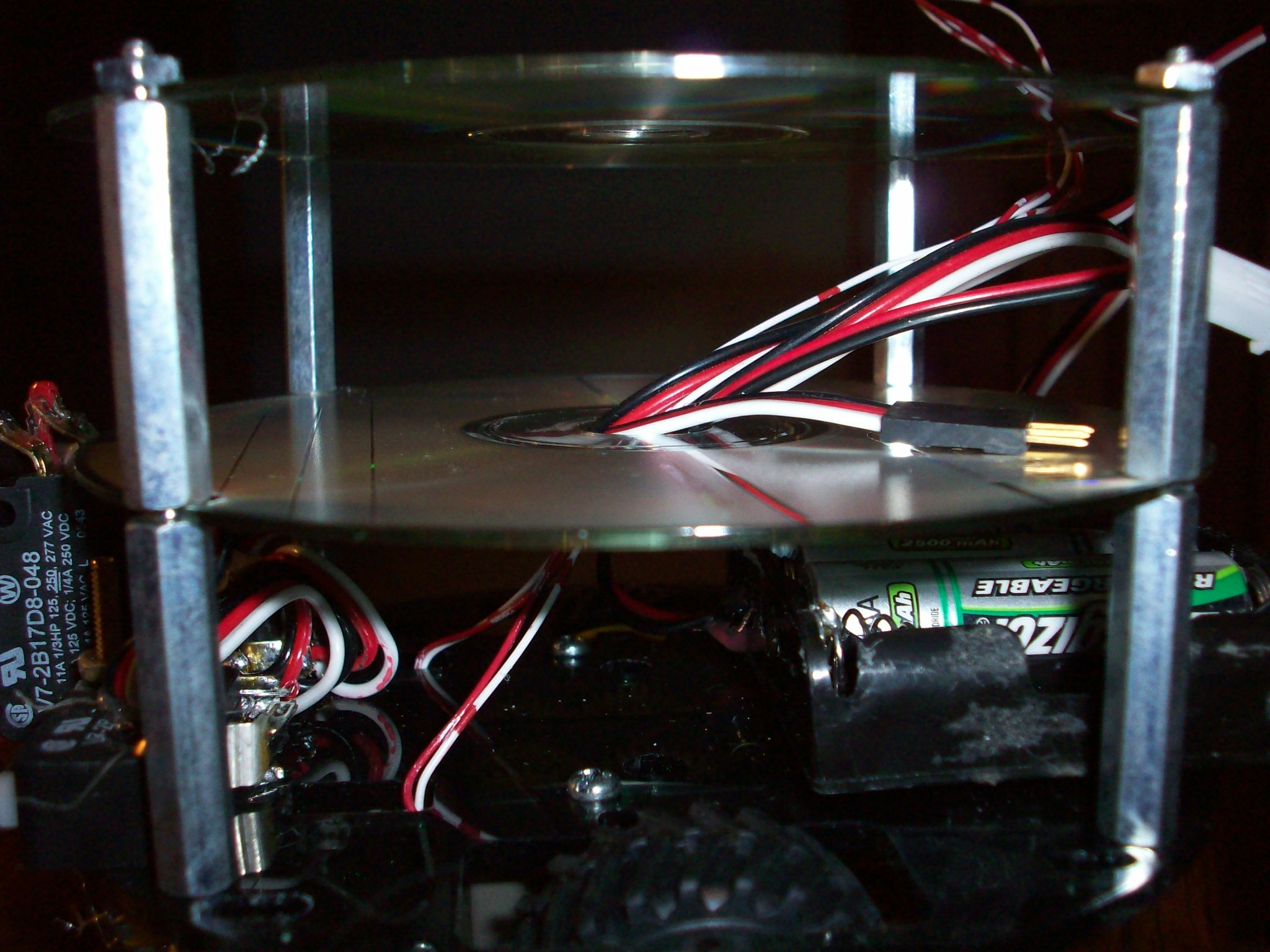

ARES 008
Another side view of ARES1. If you see, you will notice and realize that the CD's are smaller than the base, preventing me from drilling through the CD. I had to "Pinch" the CD's with the standoffs to ensure that ARES will not fall apart while driving around, dragging its guts everywhere (ew!).
ARES 009
Sideview of the 2nd platform. You can see all the wires coming out of the very small CD holes. With this many wires through it so far it gets quite difficult to fit headers and etc through it.

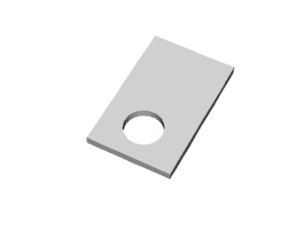

Looks cool, only one comment. Is there any reason you did not just drill holes in your CD platform? The current setup looks like weak supports on the CD's. At very minimum I would add washers or little metal tabs sandwiched over the CD's. Metal tabs as shown in image.
At any rate looks cool so far. Good job...
I may have mis-worded it. There are little nubs drilled out of it. Bah just look at the picture. The black is the part that the standoffs go through, and it turns out quite nicely.
Oh, I could not tell from photo. In that case, never mind :)
You might want to consider using common ground and power wires. Thus you will have signal wires (n) plus two through the CD holes. That is common practice in airplanes (both full size and models) and many other applications where space is limited.

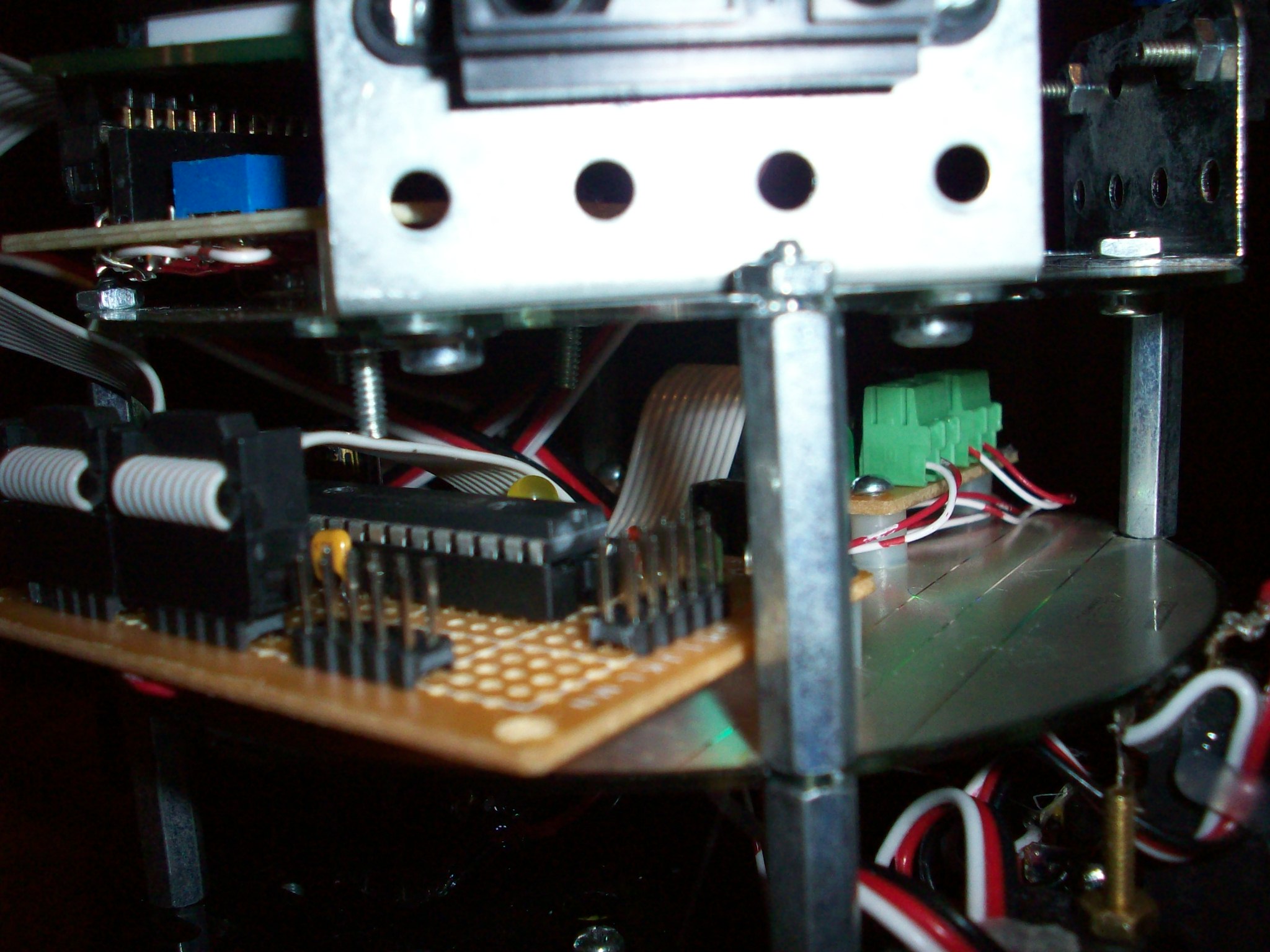

AREVx1 003
Side view of the 2nd deck. You can see 18F2525 and port A with no 2x5 on it. You can also see the motor controller in the background, with the controller board in the forefront.

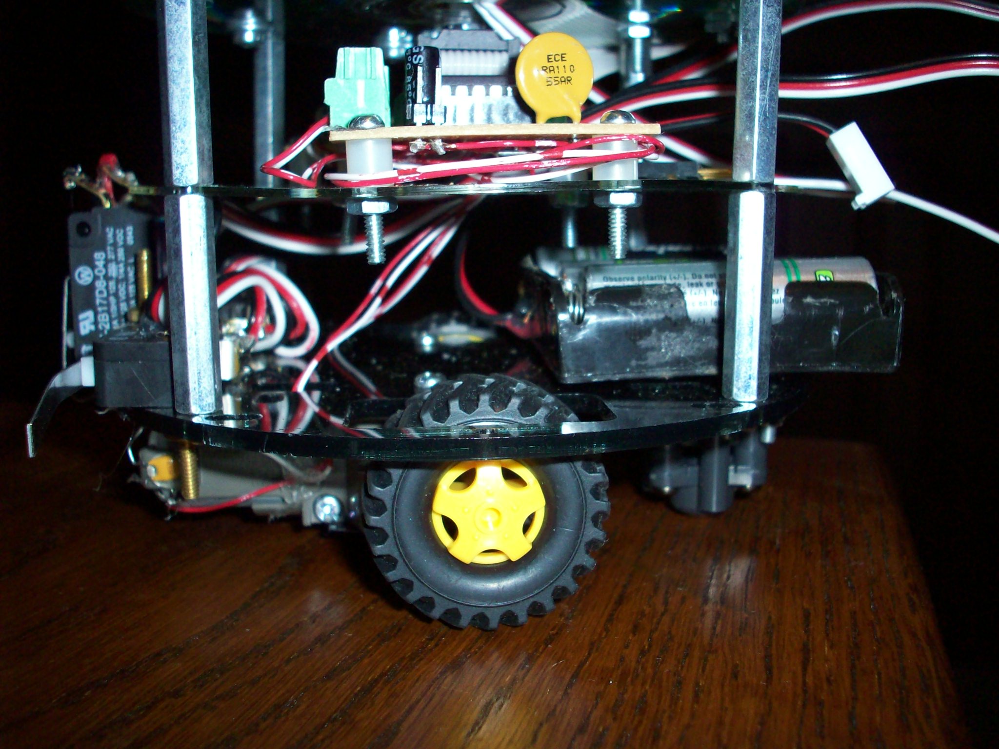

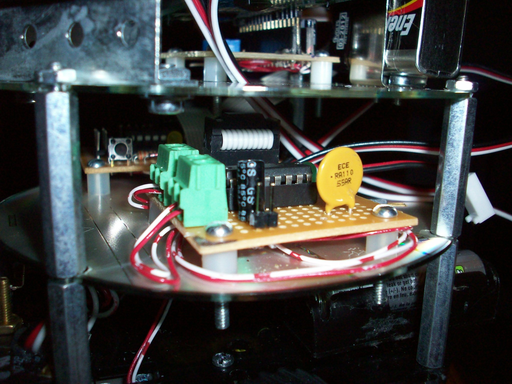

AREVx1 004
Motor controller board with the green screw connectors and the vital PTC fuse. That will save your robot in a short circuit!

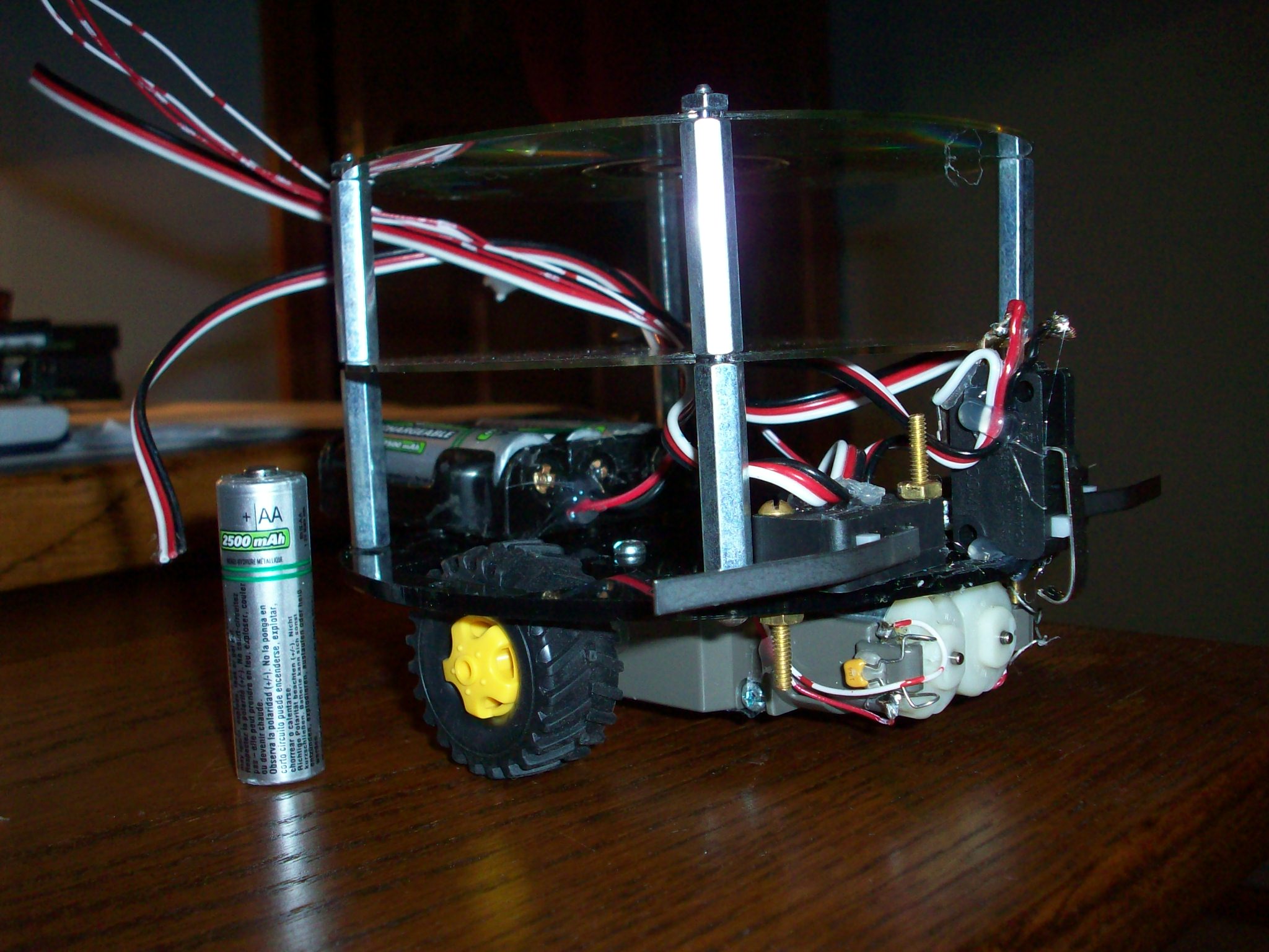

AREVx1 005
Side view of entire robot.
