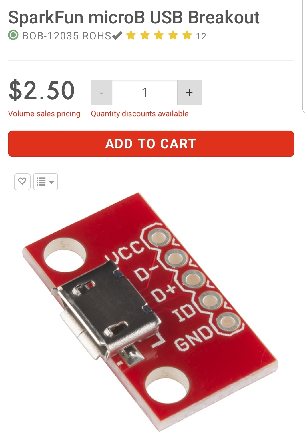

I did look at cutting off the usb and fitting a power jack but the wires look so small I can't see it working so I figured wireless charging might have made its way to devices other than mobiles. They all seem to be 5 voltish so I'm happy to risk it. I guess it's back to plan a and butcher the usb

The question no one has asked is what the voltage of the wireless phone charger is. If it's 5 volts, it's just a matter of adapting the connections to the phone.
Chrisk, what are the ratings on the charger for the wireless phone? If it's 5 volts, this won't be too complicated. If it's more than 5 volts, wireless charging is going to be complicated.
Assuming it's 5 volts, it's a matter of adapting the connections. There are various ways this could be done. This approach requires some simple soldering. I haven't found an Off-The-Shelf adapter.
First, I would start with a Qi receiver with a USB micro B connector.
Next, get a USB micro socket breakout board. This one is from Sparkfun but they should also be available on ebay. The Qi receiver will plug into this board.
The tricky part is finding a cable with the right size barrel connector to fit the phone connector. This come in many different sizes, but some careful measurements will help you figure it out. Find the right cable on ebay, or check at local thrift stores for a charging module with the right size cable that can be cut off. Connect the wires to Vcc (+ 5 volts) and ground on the breakout board, matching the polarity of the barrel connector to what's needed for the phone. Usually, the center is positive and the outside is negative but it should be marked near the jack.
