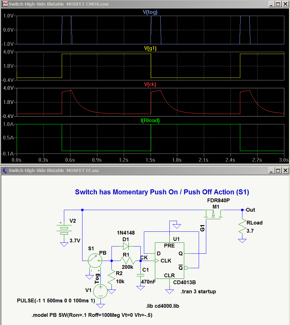

Below is the LTspice simulation of a circuit using the 4013 connected as a toggle FF.
D1, C1, and R1 are for switch de-bouncing.
S1 and V1 simulate the PB switch.
The transistor can be any logic-level P-MOSFET that fully turns on at 3.3V Vgs (as noted in the data sheet where the Rds value is specified) with a current rating of at least 2A and an Rds of less than an ohm.
The circuit is micropower (or likely nanopower), consuming only leakage current whether it's ON or OFF.
Note that the power (to the battery) and ground for the 4013 are not shown and must be added.
Also all unused inputs (not outputs) on the unused FF in the package must be connected to ground.

Below is my LTspice simulation of the circuit KMoffett posted.
I have to significantly modify some of the resistor values to get a good switching action for all the voltages.
S1 and V1 model the momentary PB switch function.
Note that the circuit requires no de-bouncing circuit and and is insensitive to how long the button is pressed.
The circuit recovery time is only about 50ms after the button is released before it can be pressed to again toggle its state.
The MOSFETs must be logic-level types that fully turn ON (not their Vgs threshold) at 3.3V Vgs (the point where the Ron is measured in the data sheet).
Edit: If it is desired that the circuit always start in the OFF state when power is applied then you can add a 20nF capacitor across R1. That will keep M1 off during the power up time until all the circuit voltages have settled.
Edit 2: You can substitute a CD4049 inverter for M2 if desired. With that you can also eliminate R1 thus requiring only three passive parts for the circuit (besides the PB).
That circuit should also power up in the OFF state, thus not requiring any additional capacitor.

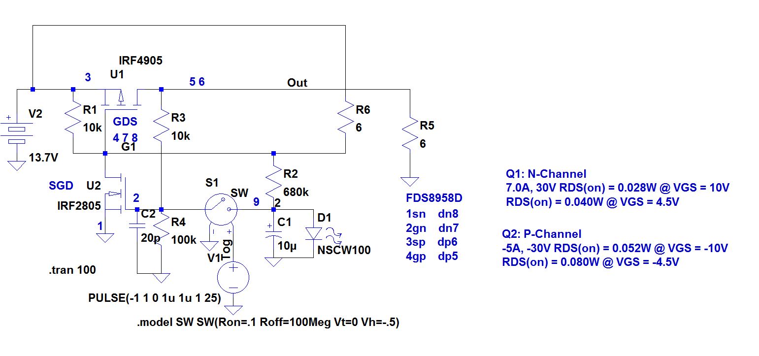

I upped the voltage to 13.6 v and use an IRF4905 for the P fet and I can not get this circuit to run. I'm going to go work on some simpler (mechanical) and let my brain relax and hope for some help.

I had to modify your circuit by increasing C1 to 1μF and changing M2 to a MOSFET with a higher Vgs(th) to get it to work.
The problem was that the voltage at G2 was not going low enough to turn off M2.
Note: I don't have the IRF4905 model in my library so I substituted a different P-MOSFET for M1.
To make the switching more reliable over a range of voltages, replace M2 with a CD4049 inverter since it has a higher threshold voltage, making it easier to switch. With that you can also eliminate R1. That is shown in the second attachment.

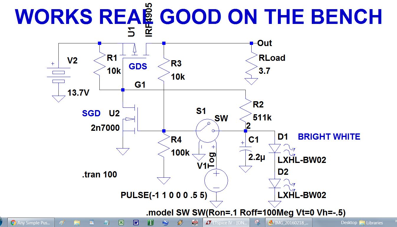

I don't know where what I thought I had posted went, but here's where I want it so here's my post, I was working with the circuit and it worked kind of iffy, and after changing a few thing, used a 47uf 50 volt cap, I had it working good, but you couldn't push the button to rapidly or it wouldn't work, wouldn't turn off until the cap voltage had bled off. I was watching this with my scope and noticed it had to decay to about 2 volts or less to be able to switch, so I put a Bright White LED across the cap to keep the voltage down, it was going up to 13v and taking a while to decay. I thought it was working good and removed the meter and the scope and it started NOT staying off, so to take the place of the meter, I added a 100k resistor to keep the NFET, 2N7000,gate drained off , I finished up using a 2.2uf cap, because I had 3 of them and I need 3 of these circuits and 511k resistor and 1 LED across the cap, it needs 2 to sim.
Now it switches just about as fast as I can push and repush the button, I'm happy.
tried some different caps,4.4nf worked good, 100pf worked better,IMHO.

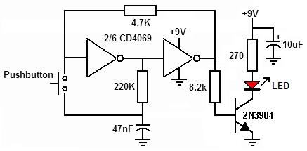

Your circuit is the discrete version of this circuit:

I have made several variations of this switch and right now I like the one that is displayed in this .asc
I have found that the addition of a LED or zener to keep the cap from charging up to the supply voltage makes it able to toggle quicker. I have some 16 pin sop adapter boards and I can mount 2 FDs8958D dual fet chips on it and make 2 switches in a compact package. Also, it can be used to switch R6 and/or R5 in this drawing. I have found it to be quite versatile.
