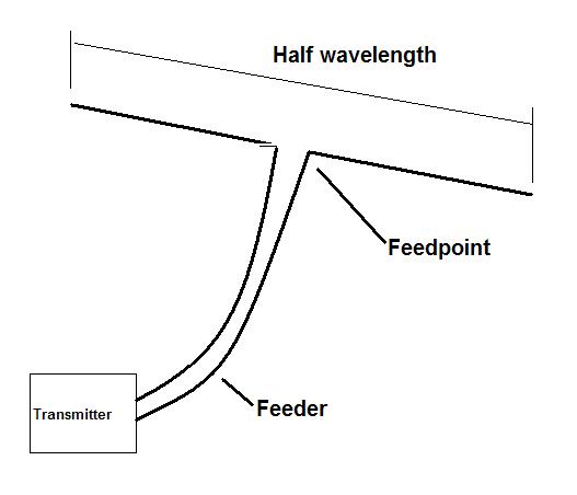

can you show me a feedpoint, a feeder and a dipole? although i know what these are...you're getting me confused because i don't know what you mean when you say to connect a 75ohm dipole to a 50ohm feeder.
A dipole has two wires (or rods), each wire is a quarter wavelength long at the design frequency.
This dipole will have an impedance of 75 ohms.
As the two wires are the same length the dipole is centre fed, this is the feedpoint of the antenna.
The feeder is the cable which connects the transmitter to the antenna.
Most often the feeder is a coaxial cable, sometimes the feeder can be what is known as "twin feeder" which is basically two parallel wires.
Coax and twin feeder have characteristic impedances.
Coax usually 50 or 75ohm, and twin feeder 75 or 300 ohm. Other values are available but these are the most common.
The impedance of a coax cable depends on the ratio of the diameters of the centre core and the braid and the dielectric material between them.
The impedance of a twin feeder depends on the diameter of the wires, their spacing, and the dielectric between them.
See the attached sketch to help your understanding of the terms.
