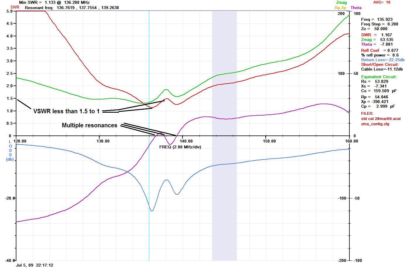

Using an antenna analyser, read about it here:
Vector Impedance Antenna Analyzer AIM4170

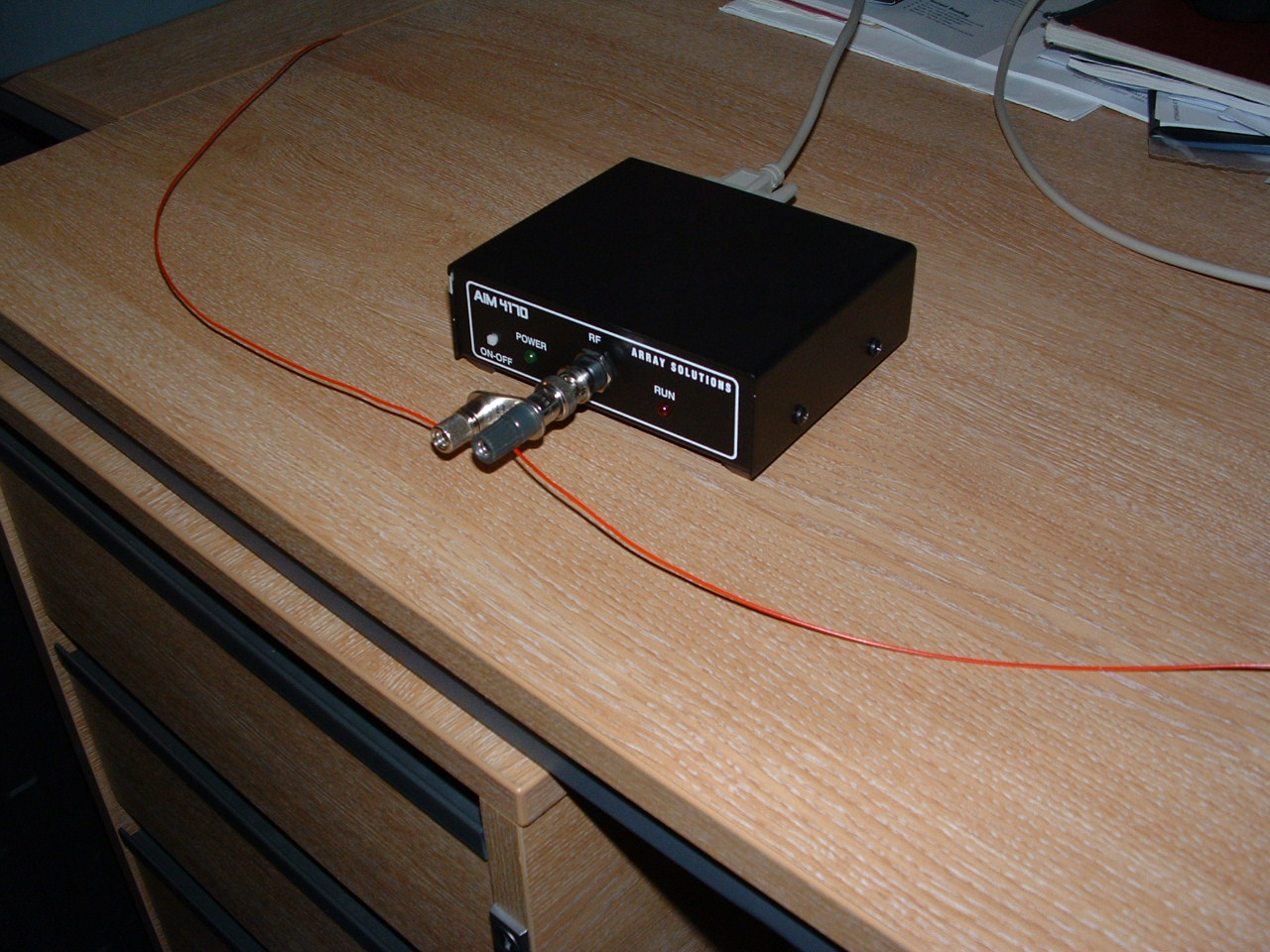

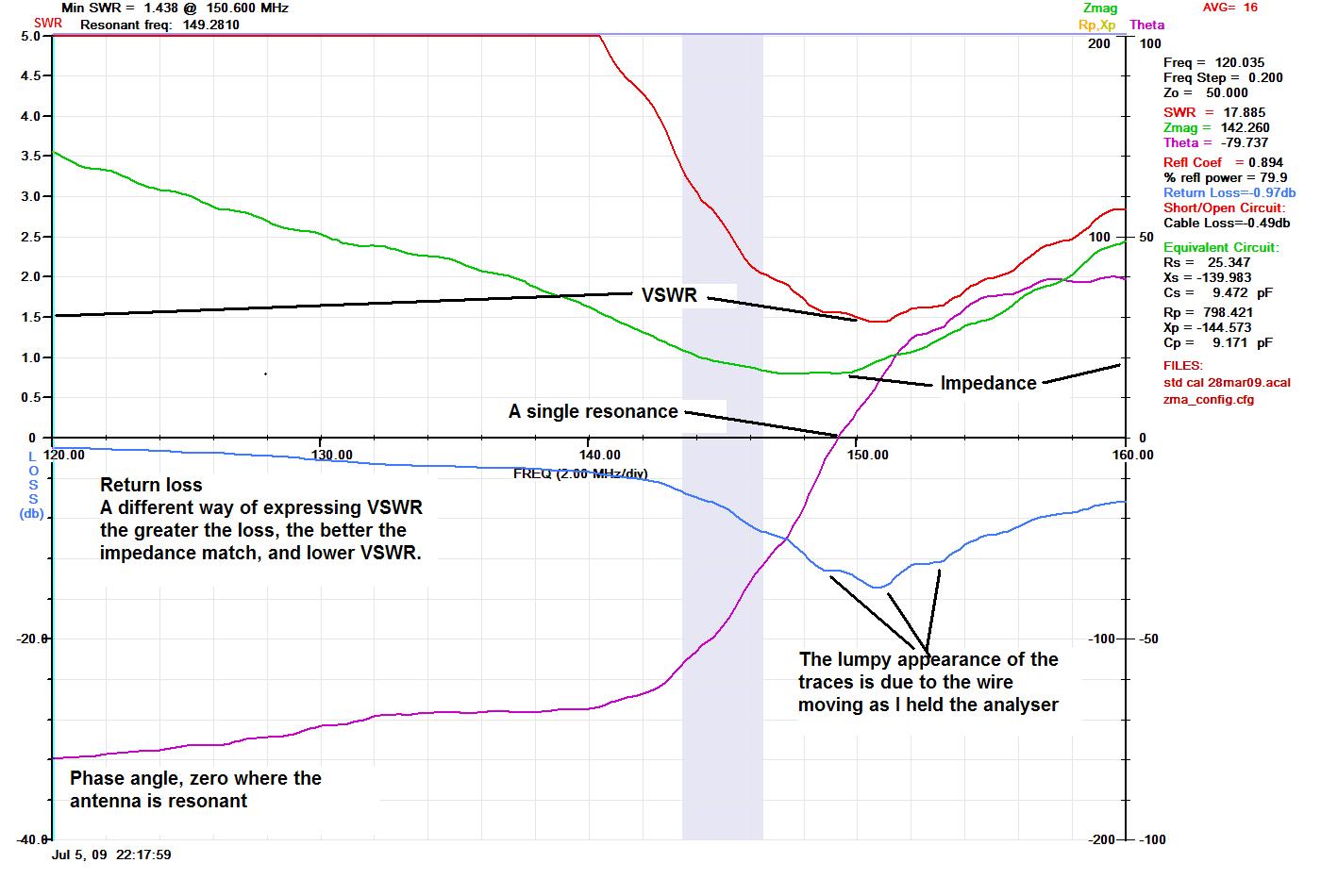

I did some scans of a couple of antennas, a dipole made from 19inch long hook-up wire, and a groundplane antenna (a monopole) made up using 19inch lengths of steel rod.
The dipole.
With the dipole and the antenna analyser just laying on my desk, I got the result as shown in the attachment below.
The legs of the dipole were 19inches long, this should give a resonant frequency around 145Mhz, in reality it was showing multiple resonances around 137Mhz due to the effect of the desk.
Picking the analyser up in may hand and holding it clear of the desk and other stuff, I got a totally different picture.
The general apperance was much more what would be expected from a crude dipole, the resonant frequency was higher than expected, and much higher than when on the desk.

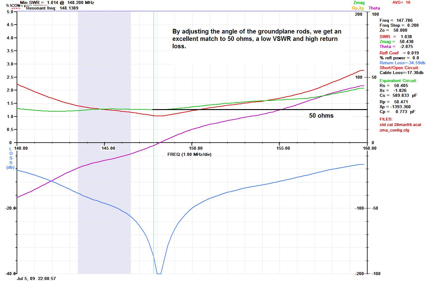

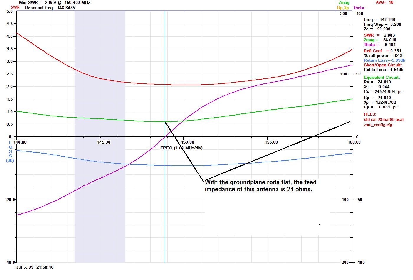

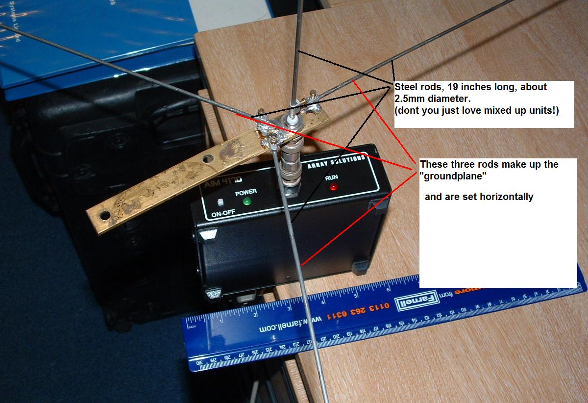

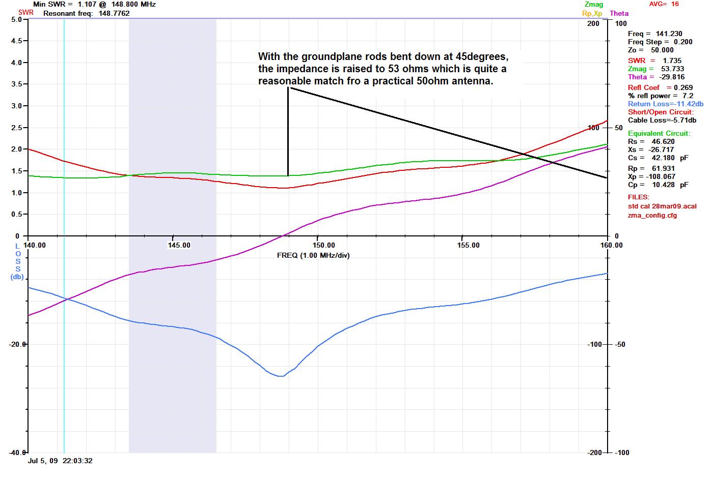

And now the groundplane (monopole) antenna.
I will let the pics speak for themselves.

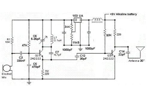

hi!
still i haven't understood the purpose of the second LC tank...
can you check the modifications i did on the schematic?
The second LC tank allows the output to swing below ground and above the supply voltage with low harmonics. Your second transistor with its poor biasing might be saturated or might be cutoff (a clipped sine-wave) which produces severe interference harmonics.
I don't know which adjustable regulator you are using.
The output transistor needs to have its own supply bypass capacitor, or remove the choke.
Your audio does not have pre-emphasis so it will sound muffled without treble audio frequencies when played on an FM radio.
can i "play safely" without the second LC tank? if yes show me how...
the regulator is the reg102-A it's an ultra LDO which i had also available.. but at first i didn't wanted to use because for the purpose of my experiments i'm trying to utilize old used spare components and that regulator is new.. i guess it's also too much for that circuit..
btw the ferrite bead is that type "Murata BLM31AJ601SN1L" it's what's left from an old project of mine...are they suitable for my design?!
right now i don't care so much about the audio quality...mostly i'm trying to make it as stable as possible and learn something from it. ;)
Simply remove the horrible 83k biasing resistor and replace it with a 47k negative feedback resistor from the transistor's collector to its base. Then a low gain or a high gain transistor will not clip and produce interference harmonics. But the negative feedback will reduce the output level.
