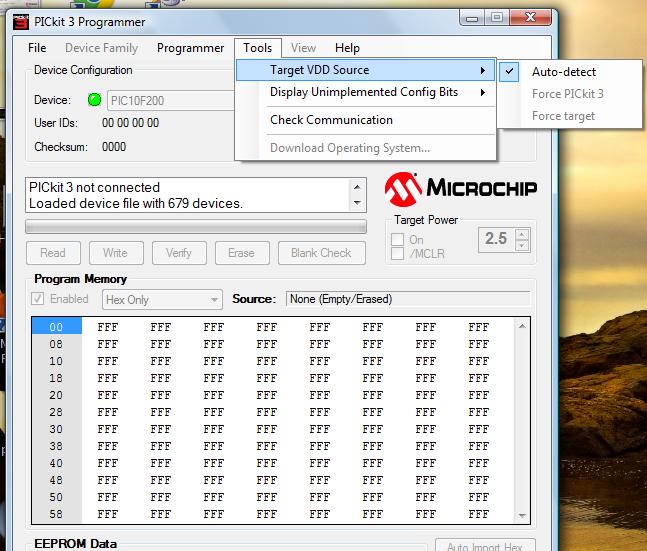

2.In the Pickit 3 "known problems" section there is a recomendation for a problem such as this, to select the 'Vpp first entry mode'. The pickit 3 version that I have does not have that menu option. I checked the latest version and same thing.

Have you tried the standalone GUI I pointed you to in post #10 ? I don't use MPLAB (it's far too complicated) I use the Pickit 2 and it's standalone GUI. That and notepad with a bit of MPASM.

I'm sorry I sound like a dummy but I don't understand what a GUI is and I didn't know what to look at in that link you sent. Help me a little more please. And thanks for trying! Aaron
It's the AP you was asking about it looks like the pic I posted.
It doesn't have
Vpp first entry mode' The device
I posted the AP for you it's in the zip
GUI is 'Graphic user interface'. As in a program that you call up on your computer. Things to click on as opposed to things you have to type in, what they call 'Command line interface' Where one mistake could spell doom.
As it is, Burt has supplied a link to the 'Gui', it's a lot less complicated than MPLAB.

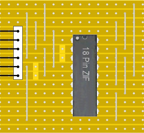

Here's a little 18 pin ZIF adaptor I made for my PICKit2/3 - you could of course use a normal socket if you wished, it also fit various smaller PIC's as well.

Thanks for the replies guys, Houseofwax, Burt, Jason and Nigel. I guess what I am learning in this particular problem episode is that the simplest ways of doing things, although they may take longer, are sometimes the better or maybe the only way.
I started w/ uCs a year and a half ago. I started w/ MPLAB and am comfortable w/ it (although I sure would like to learn more about simulation w/ MPSIM). I also started w/ a pickit 2 clone and a programmer module board w/ 40 pin ZIF. Eventually I wanted to get away from needing to take the pic out of the target to put in the programmer module every time so I figured out how to do ICSP. About the same time I started using a 16F1827 and so needed a Pickit 3. I did not like losing the use of the ICSP pins so with Nigels recommendation, I put in a 3P2T switch to move the programmer in and out of the circuit thereby having full use of all pins for the project. It works great! Until this episode, I did not think I would need that old programmer setup again. But it is what cured the problem. This morning I reprogrammed the chip w/ pickit 3, ICSP about 20 times w/o a glitch. SOOO, I'll keep that pickit 2 stand alone setup in mind when I run in to this sort of thing in the future. That Vpp 1st entry mode is valuable.
