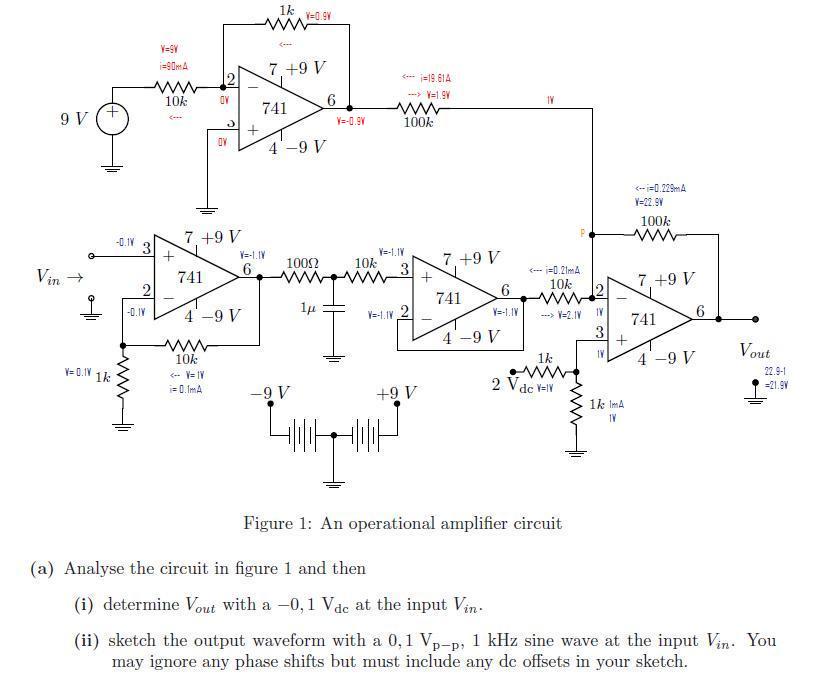

See image.
I have tried to decipher what i think is correct.
I've done it in two parts, marked in red and blue and then added the two currents at node P to find Vout. Need to know if i am correct.
Also for the part marked in red. Do you consider the op amp or do you ignore it since it's voltage is zero and use it as a series circuit?
And where do you connect the battery in this circuit?
Must you analyse the circuit at 0.1, 0 and -0.1?
Any and all help is much appreciated.

hi Jason.
The -9V supply is connected to all the Pin #4's of the OPA's and +9V to all the pin #7's
You are asked to analyse with a 0.1Vdc signal into Vin [ some countries use a comma in place of a full stop for decimals] and a 0.1Vpp at 1KHz.

hi J,
Use the marked up drawing for reference.
Amp 'A' , is an inverting amplifier with a gain [ or attenuation] of -Gain = R2/R1
Amp 'B' is a non inverting amplifier, so +Gain= 1+ [R4/R3]
Amp 'C' is non inverting 'buffer' with +Gain of 1
Amp 'D' is a 'summing' amplifier.
The -Gain1 = R7/R5,,,,,,,,, -Gain2 = R7/R6
The non inverting input voltage 2V is divided by R8 and R9, so +vin =1V
So for Amp 'D' the over all gain is ???
[remember that R5 and R6 are in parallel as far as the gains for Amp 'D' are concerned]
For Amp 'C' , R10 and R11, with the 1uF form a low pass filter, ignore this for the DC analysis.
So you work out the gains of Amps A , B and C first, then post the results, then we will cover Amp 'D'
BTW the Vout you have worked out is wrong.

For Amp 'D'
Consider the output of Amp 'D', due to each input.
Amp 'A' input -0.9V input , as 'D' an inverting amplifier with a gain of 100k/100k =1
the 'D' output would be +0.9V
Amp 'C' input of +1.1V, again 'D' is inverting with a gain of 100k/10k = 10
the 'D; output would be -11.0V
On Amp 'D' the non inverting gain would be 1+[100K/9091] [ rem 100K || 10K] =11+1
So 'D' output would be 12*1V = 12V.
If you now take the algebraic sum of those outputs you should get +1.9V as Vout.
OK.???

I have gone through part one again and calculated Vout to be 23.9V. For amp B the gain is 11 multiplied by the voltage of -0.1V gives you -1.1V. Therefore in the end you will have 0.9+11+12= 23.9V. Am i correct in saying this?
hi Jason
Sorry, but your answer for Part 1 is very wrong.

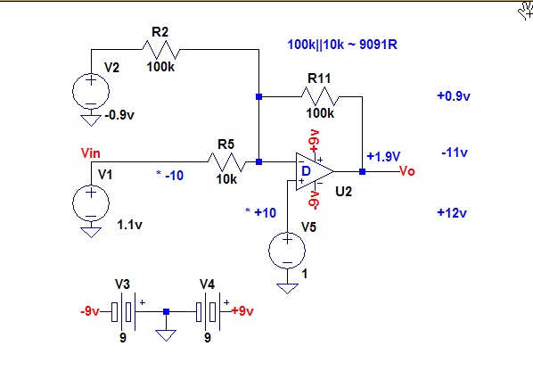

Look at this image, I have simplified to show just Amp 'D'
The -0.9v input is amplified by times 1 by D and its also inverted so it comes out of D as +0.9V
The -1.1v input is amplified by times 10 by D and its also inverted so it comes out of D as -11V
The +1v input is amplified by times 12 by D and its NOT inverted so it comes out of D as +12V
If you add those 3 outputs together, algebraically you should get +1.9V
Check you calculations and post how you have worked it out.
E.

hi J,
I think I may have misread the -0.1Vin as 0.1Vin...........give me a while to recheck..
E.
EDIT:
I did misread that input, sorry about that.:eek:
The output would want to rise to 23.9V, but as the OPA Supply is only +9V, it would not be able to rise to +23.9V.
The 741 OPA has a saturation voltage of Vsupply -1.5V ie: [9v-1.5=7.5V] with a 9V supply, so the Vout would be around +7.5V
So the figures I posted earlier should read:
The -1.1v input is amplified by times 10 by D and its also inverted so it comes out of D as +11V
If you add those 3 outputs together, algebraically you should get +23.9V [ But the in practice it would only reach around +7.5v]
