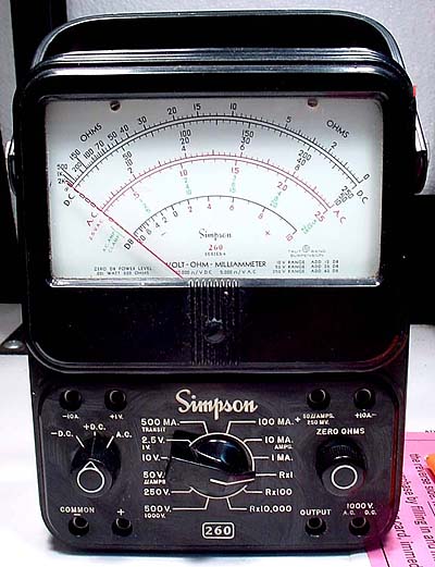

Verify that your meter looks like this pic...or if different then how so.

You set it to "Volts" to measure voltage, and you set it to "Amps" or "milliAmps" to measure current.
You choose the range dynamically to get the best measurement. If the measurements peg the meter, you increase the range.
If the measurements are all at the low end of the scale, you decrease the range to get better resolution.

The Simpsons 260 at work, does not have a Diode or semijunction reading on the meter it has only DC, AC, AC Clamp, DB , that's it
Maybe you guys have a different Simpson 260

You use the Ohms x1 scale first, then read off the ohms and the voltage at the same time, using a DC voltage scale as well as the Ohms scale. Then knowing the internal battery voltage you can estimate the voltage of the diode and the current of the diode and that gives you the first data point. You then switch the Ohms range and do it again and that gives you another data point.
I asked him to verify that his meter was as the picture i posted, but he didnt do that. We need that info to know what the series resistance is, and he also has to check the battery voltage so we know what that is too.

So you put the ohms on X1 and you're reading ohms SCALE and the DC voltage SCALE? write that down and calculate the current and the internal battery voltage?
Well for the voltage if you dont have a reverse scale (probably dont) then you have to subtract the voltage reading from the max voltage to form a percentage. Then multiply that by the battery voltage.
So if you use the 10v DC scale and you read 8 Ohms and 6 volts, then 10 volts minus 6 volts equals 4 volts, but that means 40 percent of the battery voltage, so if the battery voltage is 1.5v then multiply 0.4 times 1.5 and that gives you the voltage of the diode (which would be 0.6 volts for these readings). You could then take that voltage and divide by the resistance (8 ohms) and that gives you the current. So now you have one voltage and one current, and that makes up one data point for the diode curve. You then change resistance scale to the next one up i guess and do it again, but this time you'll get different readings.
You do have to check your battery voltage first however, and since there could be battery loading the low ohms reading will be just a rough estimate of sorts.
If this still isnt clear, then bring a diode to work with you and use the meter to measure it on the x1 Ohms scale, and take readings for the Ohms and the volts using the 10v DC voltage scale, then come back here and report those values and we'll go through the numbers. You also should get the battery voltage used on the x1 resistance scale so we know what it is.
