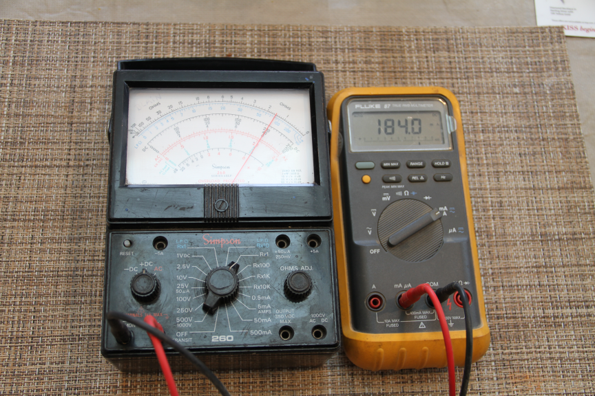

In other breaking news as to the current a Simpson 260 will typically deliver using the RX1 range? The Simpson is a 260 Series 6 XLP set on the RX1 range. The current out is measured in a loop using a Fluke 87 DMM.
With the 260 reading about 1.5 Ohms the loop current is 184.0 mA. Actually more than the 100 mA I expected to see.

According to the schematic posted earlier in this thread, the 260 would put out 130ma with the leads shorted together. Apparently there are other "versions" of this meter though.
In that schematic they show a 1.5v battery as the power source for the resistance tests, but if they use two batteries in series for other versions of the meter then it could easily put out twice that much which would be more like 260ma. Of course if they lower the internal shunt resistance that could also be the cause of a higher current. As i was saying before, my Simpson 160 has an internal 30 ohm resistor and 1.5v battery for the low ohms test setting, so the max current for this meter is only 50ma.
So again, it depends on the meter being used. The only way to tell for sure is to measure it with another meter being sure to take the internal shunt resistance of the second meter into account also when doing the measurement.

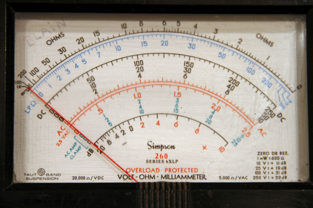

Yes, the old and reliable Simpson 260 series went through many changes. Interesting the meter has survived since around 1940 making it over 70 years in existence. Over the years the design changed a few times as it evolved. Al, I also have a 270 version with a mirrored back movement and I have a 269 which like your 169 uses a 1.5 volt D cell and one of those 22.5 volt batteries. The latter 22.5 volt batteries are getting hard to find. Anyway, here is a picture of the face of the meter I used. This has been my beater working meter for about 30+ years.
The Blain above OHMS top left is where I inscribed my name on it years ago. :)

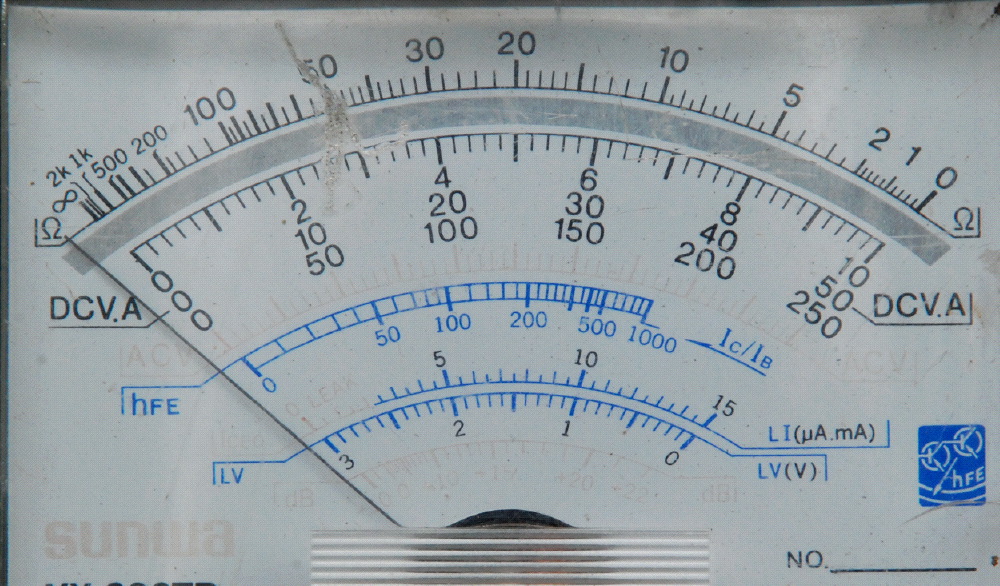

This is a pic of my jap special.
The bottom scale is the scale which allows the testing of the forward characteristic of diodes.
This is the 'reverse voltage' scale and shows 0 volt at full scale, and 3 volt at zero scale. When an 'OHMS' reading is taken, the first step is to 'zero' the ohm range by shorting the test leads and adjusting the 'ohms adjust' to give full scale reading. As resistance is added to the test leads, the meter reading drops back to the left hand side so that when an infinite resistance(open circuit) is presented across the test leads, the reading is at the left hand side. If you measure the voltage across the test leads it will be 3 volt when there is an open circuit, and zero volts when there is a short circuit. So the sum of the voltage across the test leads, added to the voltage internal to the meter circuit, will always add up to 3 volt. The reverse voltage scale shows the actual test voltage across the resistor (or diode) under test. The ohms range in use will determine the test current flowing in the test leads. The actual test current starts at the maximum at full scale and reduces linearly back to the left hand side.
If you take a diode and test it with the meter on Rx1, a typical value might be 0.85 volt and the current will be about 0.72 of 150 mA = 108 mA. If you change to the Rx10 ohm range, the forward voltage might be say 0.65 volt and the current will be say 0.78 of 15 mA = say 11.7 mA.
On the Rx100 range, the voltage might be 0.55 volt and the current will be about 0.81 of 1.5 = 1.2 mA.
Looking at the scale of the simpson in post #72, if you measure a diode on the Rx1 range and you get a reading of say 175 volt on the DC volt scale, this is 0.7 of the scale range and if the battery is 1.5 volt, then there is 1-0.7 = 0.3 of the battery voltage across the diode, and the current is 0.7 of 1.5/12.3 = .7 of about 125 mA = 87 mA. Now using the Rx100 range, if the reading is at say 190 volt, then this is 0.76 of scale and the diode voltage is say .36 volt and the current is 0.76 x 1.5/1230 = 1.8 mAmp.
So it looks like the Simpson isnt that great for testing forward characteristics, because of the few ohm ranges available and the low test voltage.
