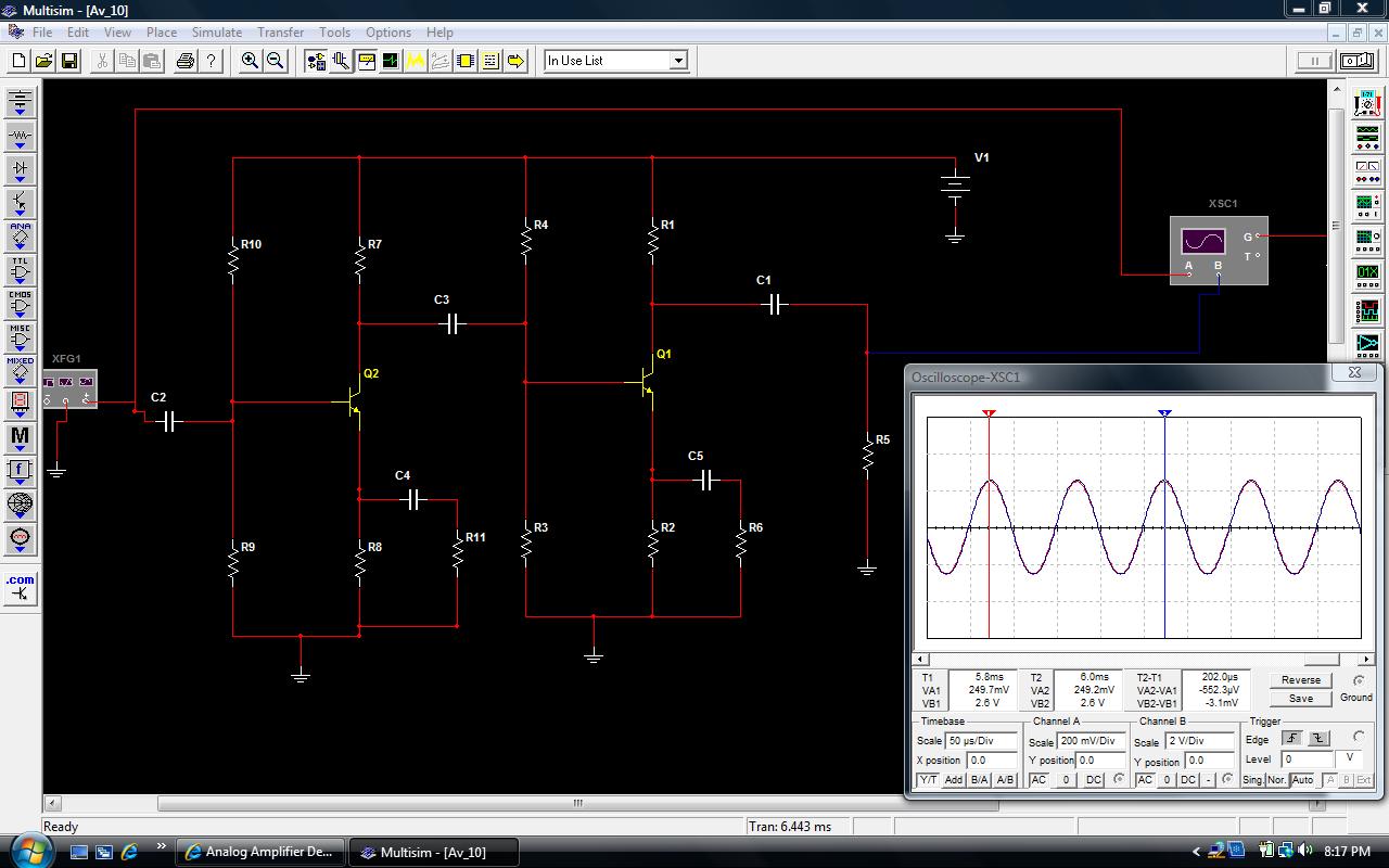

Here's what I came up with using 2 CE stages.
Of course not allowed to show the actual resistor values.

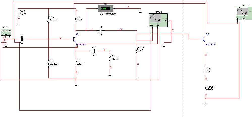

Ok guys, sorry I haven't read the last couple of replies but here is what ive done so far. The labs are closing now so Ill post a schematic of what ive done and will go through the previous posts and try to learn.
The problem here is stage two. Stage one works perfectly.

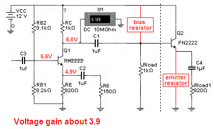

I removed all the wires for your 'scope and cropped your schematic.
The output transistor is missing a bias resistor and an emitter resistor.
The emitter of Q1 has a voltage too high at 4.9V and a collector too low at 6V. Then its max swing is only 1.1V p-p which is reduced to 0.55V p-p by Rload (1k).
The voltage gain is about only 3.9.
The input impedance is about only 3.7k ohms.

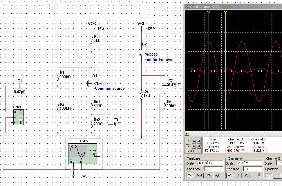

Audioguru, I tried your setup:
What is going wrong here? Everything looks messed up, I am going crazy!
Why are the values for R3 and R4 so low?
The Mosfet will work perfectly if the values are high enough that the input impedance is 50k ohms or higher.
I think the negative feedback produced by R4 and the low transconductance of the Mosfet will produce voltage gain that is less than 10.

Did you look at the datasheet for the 2N7000 Mosfet? Its gain (transconductance) is a wide range. There are low gain ones and there are high gain ones. You must bias it using negative feedback for a low gain one to work as well as a high gain one.
When the gate resistor connects to the drain then when a low gain Mosfet does not conduct much then the drain voltage is higher and it feeds more voltage into R4 which turns on the Mosfet more.
When a high gain Mosfet conducts too much then the drain voltage is lower and it feeds less voltage into R4 which turns on the Mosfet less.
If you bias the Mosfet with a voltage divider from the supply voltage then a low gain Mosfet might be turned off and a high gain Mosfet might be turned on too much.
the way to get the proper bias on the MOSFET and keep a high input impedance is to isolate the voltage divider from the gate with a high value resistor. all you need here is a voltage. the Mosfet gate capacitance which is a maximum of 50pf has an impedance of 3Meg at 10khz. so you can use a 100k isolation resistor to connect the voltage divider, and your input impedance will be just a little below 100k. this can be done with MOSFETs and tubes, but not with bipolar transistors. look at my example above. or use audioguru's self biasing scheme, and you won't have to tweak the bias network. looking at the Fairchild data sheet, the production range for Vgs(th), the gate threshold voltage is from 0.8 to 3.0V. that's a very large range, and audioguru's self biasing scheme might work best with this device. you want to eliminate the actual device tolerances as much as possible and let physics do the heavy lifting. the goal here is for a circuit to work first time, every time. of course life is full of surprises, but that's the goal to shoot for.

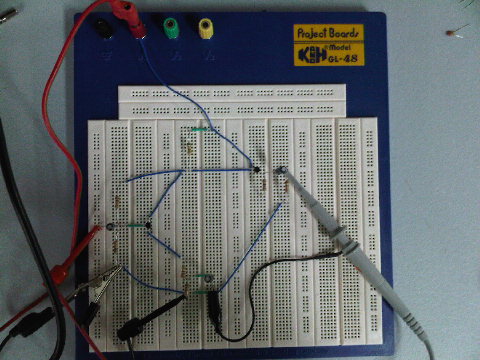

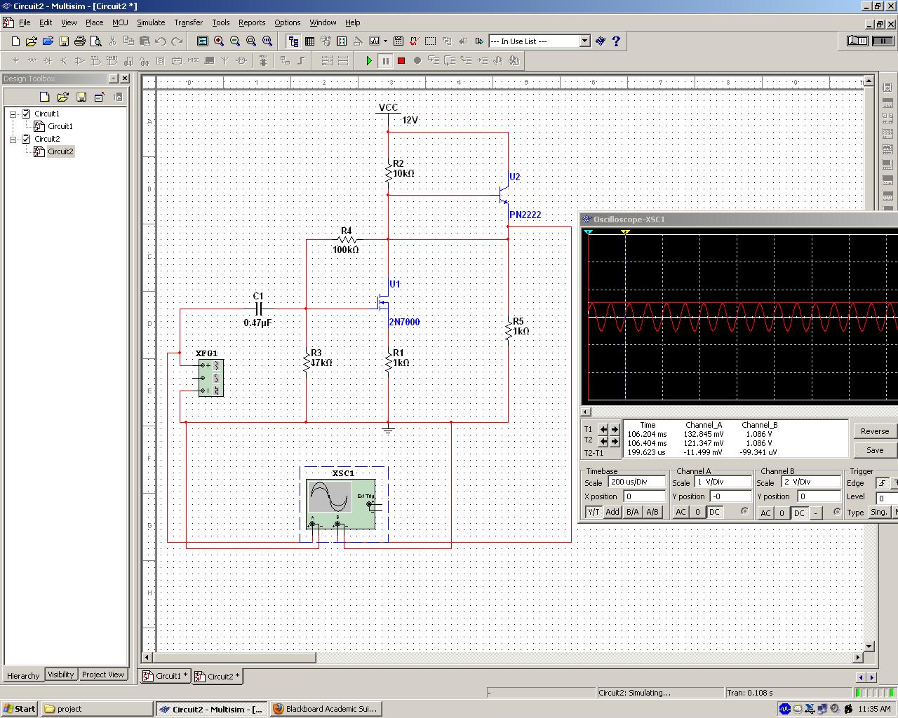

This is my final touch guys. Have a look at it and tell me if anything needs changing! The gain is 12.452.
I implemented on the breadboard, and everything seems to be fine. Although I didn't get much time since the labs were closing.
Good!
Your amplifier works and it exceeds the requirements a little.
But will it work with all 2N7000 Mosfets? They have a wide range of transconductance and current.
You could have done tht whole thing on a single one of the boards on there, why do you have it spread out like that?
@audioguru: That's a good question. This same setup would probably not work since its not a generic setup. For different MOSFET's, won't you just bias it accordingly?
@sceadwian: Take it easy on me :p I'm still new in the field of electronics :) I spaced them out so it can be simpler for me to visualize things.
