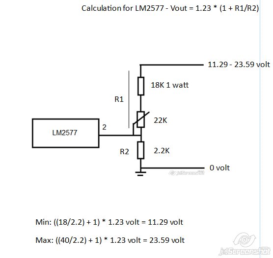

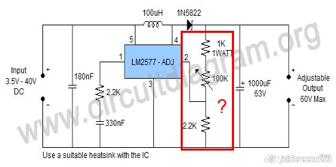

I would like to be able to adjust the output from let's say 10/12 volt to 24volt, so i'm thinking of putting in a third resistor like in the diagram below, but i'm not 100% how to calculate these resistors value to get 12 - 24 volt out.
So:
1. Is there an alternative to LM2577-ADJ that could give me 1+ Amp?
2. What should the 3 resistors be in Kohm?

I have tried a few hours now to see if i could change the resistors to give me around 12-24volt out. This is what i calculated it to be. Is it correct and can it deliver 1+ A?

I thought i could get help in here on how to calculate the resistor values correctly. I have tired myself, but not 100% sure it is correct though.
If you have followed the equations from the datasheet on post #2, then you are correct and you will obtain 24 volts output
However, that does not mean that the circuit can deliver the current you require. This is totally different, and it is limited by the peak switch current which in turn is related by the load current and the power inductor's ratings.
If you exceed the inductor's maximum DC current it will saturate.
That might be the reason your module's inductor burned out.

Be aware that boost converters such as the LM2577 increase voltage. They do not increase power or current.
In fact, due to the inefficiency of the conversion, the input power will always be greater than the output power.
Power is volts times current. So if your output is 24 volts at 1 amp, the output power is 24 watts. Therefore, your input power will be 24 watts times some inefficiency factor. Let's pick 90%.
Input power of 26.6 watts / 12 volts = 2.2 amps input current. Average.
Note that word average. Boost converters, or any switch mode power supply, works by switching the current on and off in pulses. That means the magnitude of pulses of current, when on, must be greater than the average. How much so depends on the ratio of on to off time, or duty cycle. That switch current is what the LM2577 sees.
The current through the inductor is nominally the input current, but includes a ripple current at the switching frequency. the peak to peak value of the ripple current is dependent on the ratio of the inductance to other operating conditions. (see the datasheet referenced in post #3.)
The main stumbling block that many people have with choosing components for boost converters is that they use the output specs. The input specs need to dominate when choosing the inductor, and you really need to look at the whole design when choosing anything.
