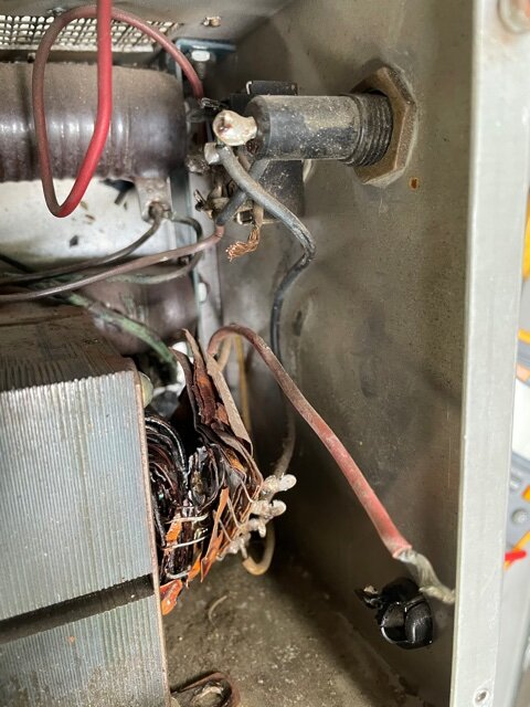

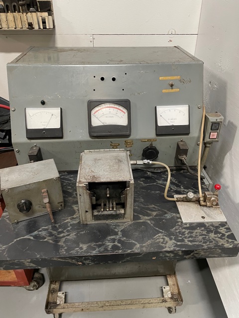

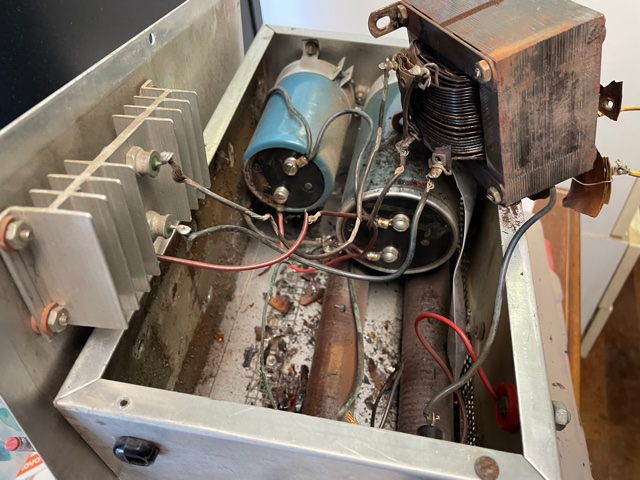

The owner sent me some pics ...one is the main component that houses instruments, the rest are the load bank I have been describing thanks,

The pictures do not provide much help. It is not even possible to read the labels on the controls and what the meters read. A ruler placed next to the transformer would give us a rough idea of the VA rating of the transformer.
I have been assuming the the alternators you have been talking about car alternators so that would be a regulated voltage output of about 14.5 volts a between 40 and 100 amps output. the two resistors in series will be 3 ohms which would only provide a load of 4.8 amps which is not much of a test load. The original transformer had two secondary winding (I ASSUME 10 to 12 volts RMS.) You could also use a transformer with a single secondary winding and add two more diodes or use an encapsulated bridge rectifier. A full schematic of the complete unit would be a great help in us understanding EXACTLY what tests are being done. I assume the alternator under test is being driven at a variable speed. (A VFD an 3 phase motor ?) Are there more high power resistors that can be switched in to provide a variable load ?
