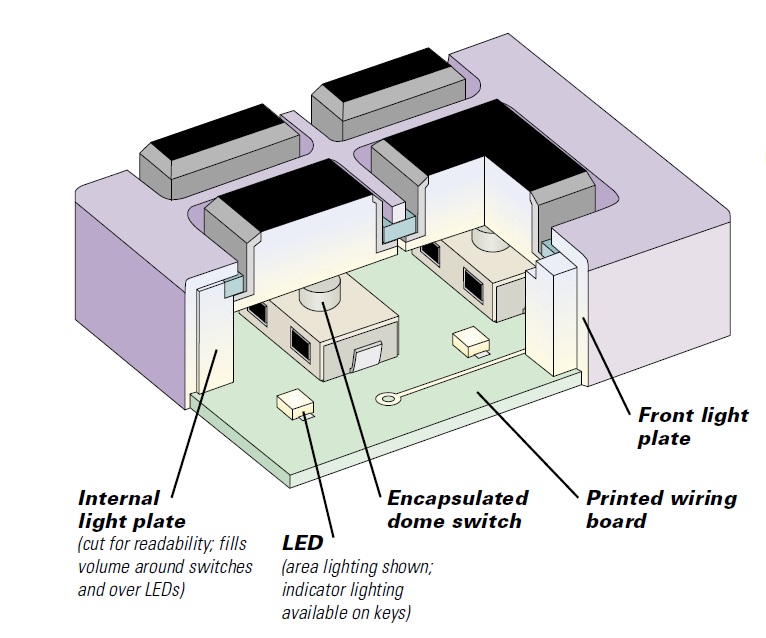

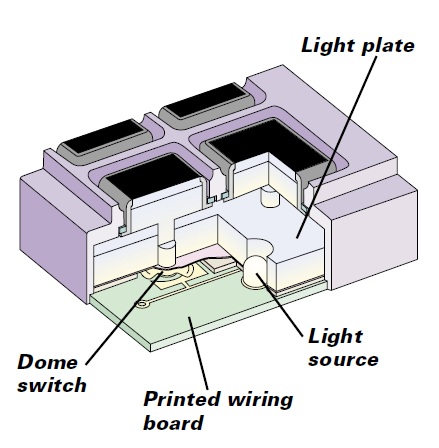

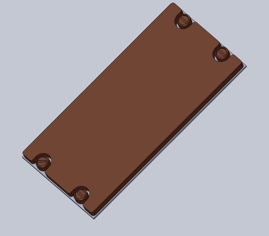

Basically the aircraft panels are made from 2 layers, the bottom aluminum layer and the top layer which in real planes I'm not 100% exactly what it's made of, but based on what I've been told, the way simulator guys do it similar and they just use some type of clear Acrylic or plastic piece (you can see how it works in the attachment) and then just paint it to the colours that you see if you look up aircraft cockpit pictures. Then they simply engrave the panels or in other words simply strip back the opaque paint to show the clear plastic in various shapes and letters (refer to the second picture).
Here is where it gets a little tricky. The problem is that you have an aluminium backplate directly behind the clear material, so you can't simply put a light source behind the panels. This whole issue can be simplified by not having an aluminium back plate but what would this world be without a challenge :)? So, within a 6mm thick or there abouts of material, you must enclose most of the stuff that you see poking out from the front of the panel (based on what other people do, it appears that they do make cut outs in the aluminum for various accessibility issues but I don't think I'll be placing LED's behind the aluminium panel with cut outs for the light to shine through. I've also attached 2 images of how the real panels are made and as you can see, they essentially have a PCB with BMD LED's on them.

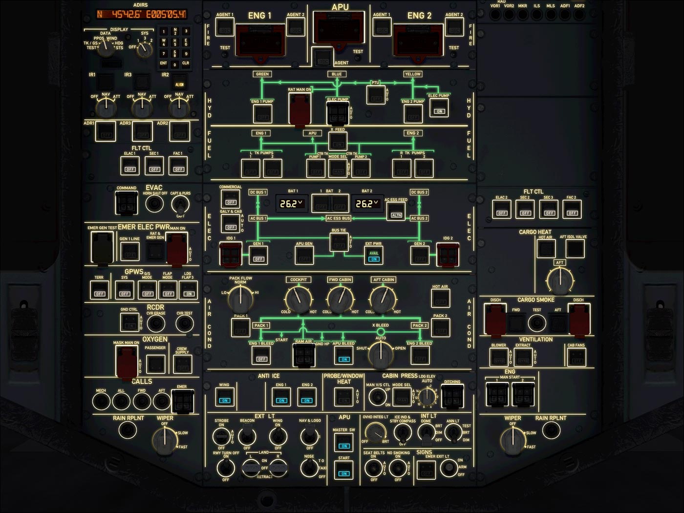

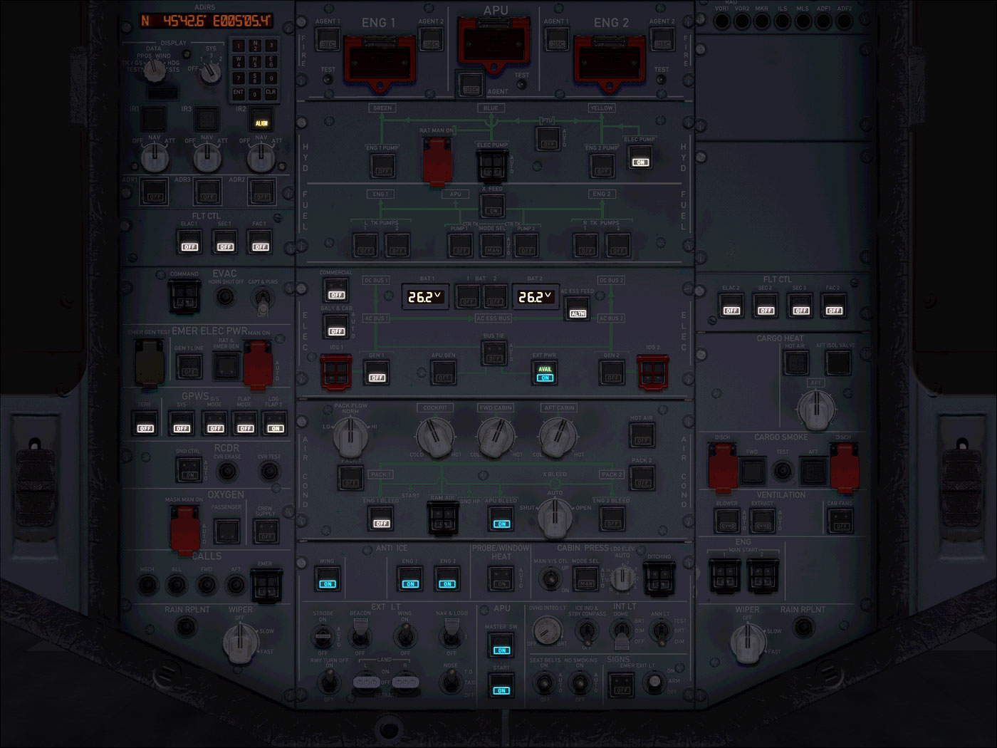

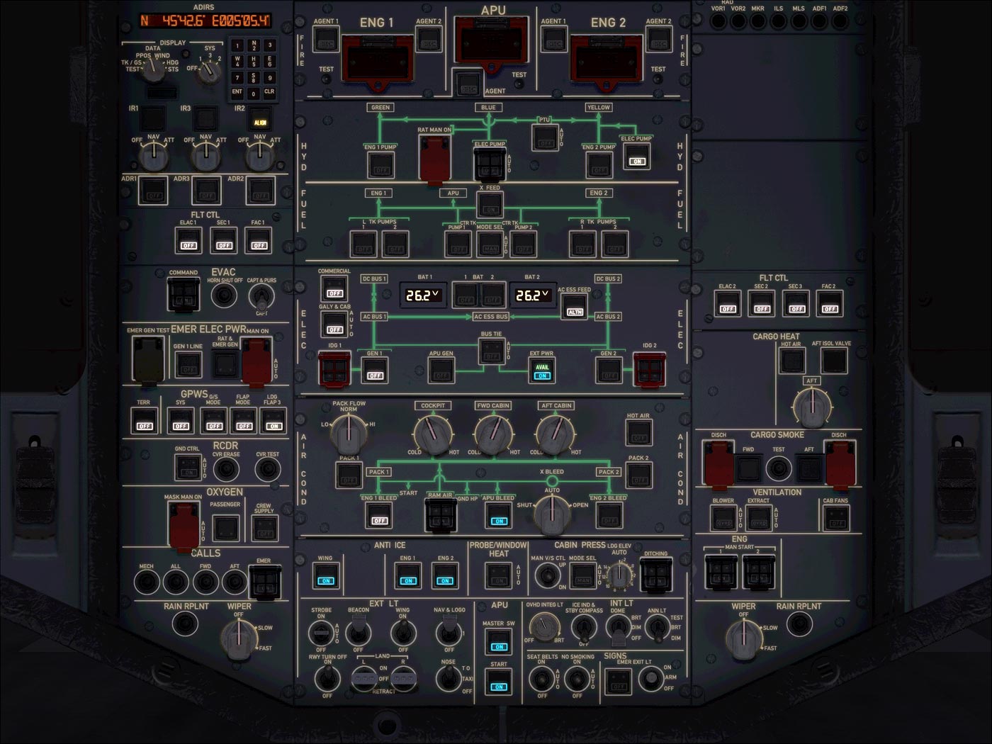

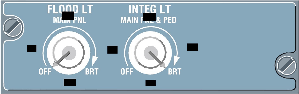

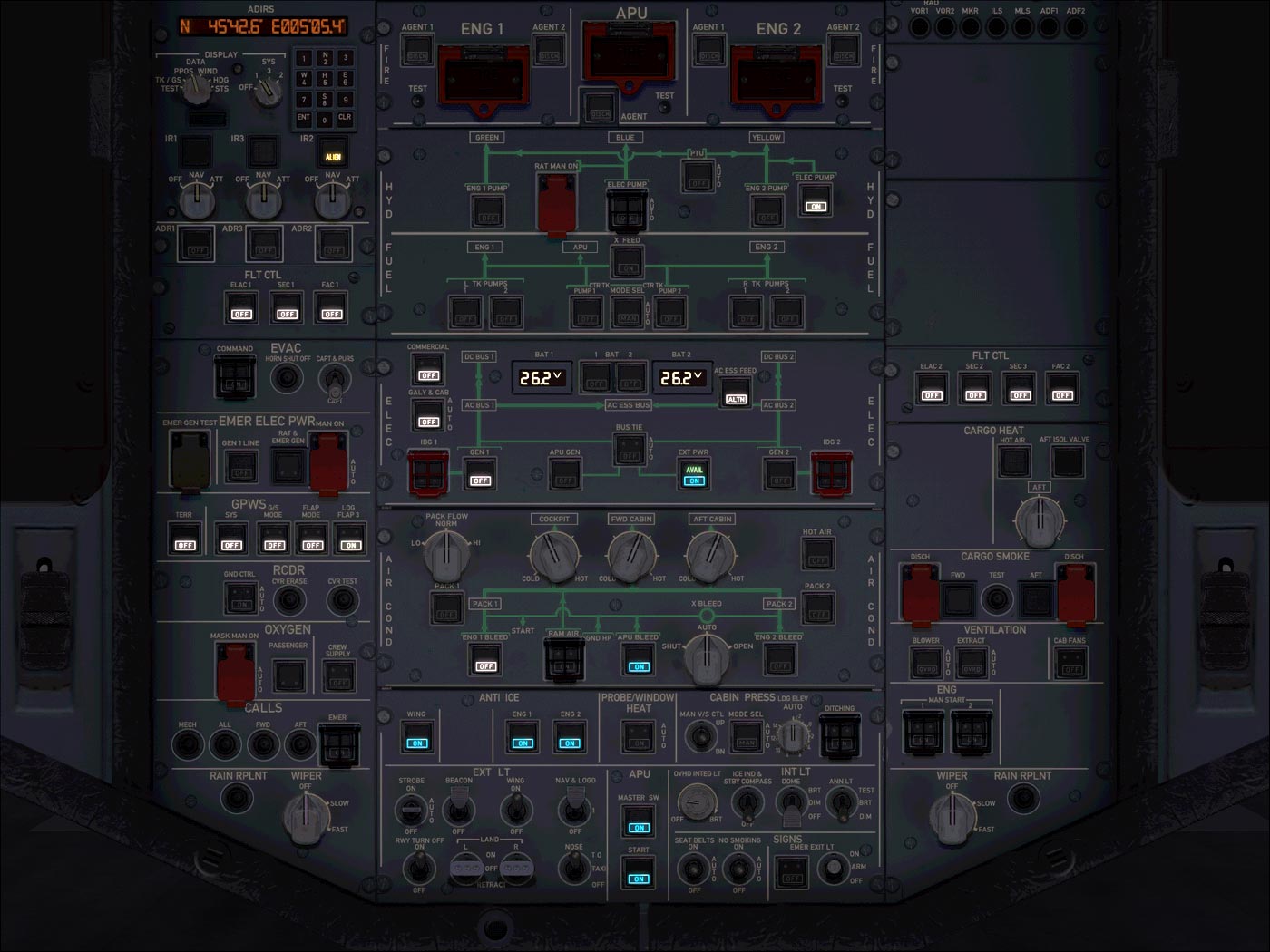

I've chosen to start all this out with the simplest panel I could find which is the lighting panel as you can see in the attachments. Basically, at night, everything white must glow (the knob is opaque but the triangle and the strip are clear, so the knob must glow also as can be seen in the next image). Although the next four images are of the overhead panel, the same thing will happen in the centre console with all its panels. You can see that the knob responsible for the lighting in question is called OVHD INTEG LT in the bottom centre area of the overhead panel. This knobs role is identical to that of the INTEG LT (MAIN PNL & PED) or at least I hope it is. Basically, they are both dimmers and control not only their respective separate panels but are connected to all the other panels as well.

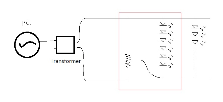

Having said all that, I've quickly created a basic circuit diagram just to see whether I'm on the right track because I've never created any circuits before so I'm not sure about what I'm doing. The power source will as I said be AC and then through a transformer be transformed into DC, then the red square represents the 6 BMD LED's on the panel in question + the potentiometer/knob and then I've connected up other LED's in parallel to represent daisy chaining of LED's on other panels.
More specific questions:
1.) How would I go about selecting the diodes for these purposes? i.e. in terms of voltage?
2.) Same as above, how do I figure out what sort of pots I need?
P.S. I'm planning on using PCB's if that changes anything.

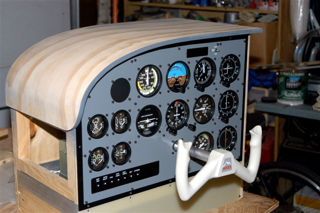

Wow… an A320 is pretty ambitious. I went with a simpler aircraft (pre-finished photo attached).
As for your panel back lighting… you could go with some material similar to Lucite. Just paint the frontside, engrave what you want lit-up and at some points (you’ll probably need several), polish the edge of the panel and apply light. Think along the lines of what’s used for “light pipes”.
