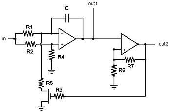

Long post, but I underlined the main issues I would like to get help with.

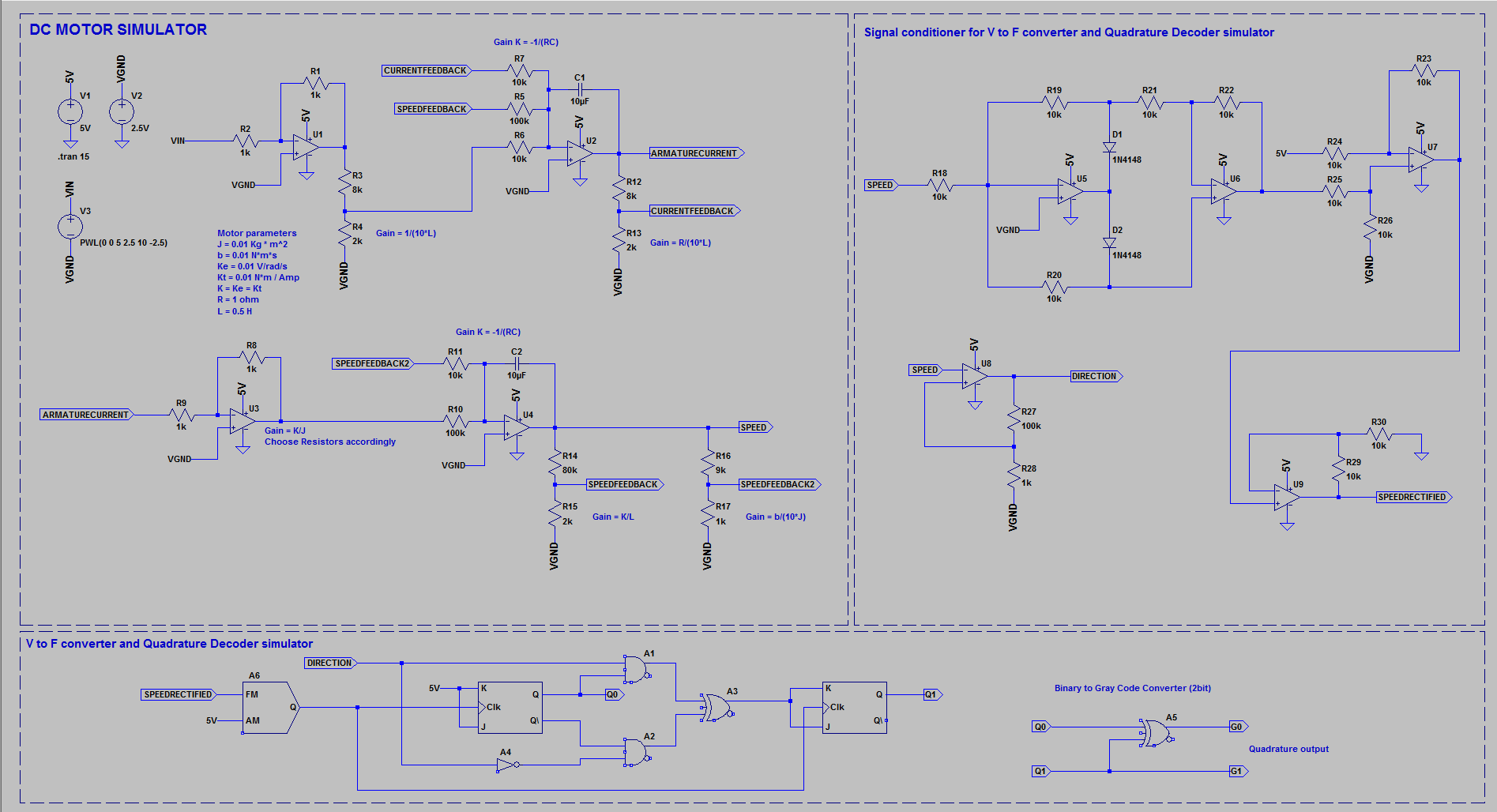

I've been working on an analog DC-motor simulator circuit. I'm not sure why, maby it could be usefull for automation students etc.
The system is supposed to work as follows:
Input for the circuit is analog voltage from 0 to 5V. Virtual ground is at 2.5V and it represent 0 volts across the motor. 5V represents max positive voltage across motor, and 0V is max negative voltage across motor armature.
The simulator circuit creates analog signal 0...5V representing the speed of the motor. 2.5V (virtual ground) is zero speed. Voltages below 2.5V are negative speed and above 2.5V positive speed. The circuit also simulates armature current (torque).
The goal is to simulate quadrature encoder also. I have a circuit that does that by taking two inputs; The speed as a frequency (clock signal) and direction information as logic signal.
Between the analog speed information and the quadrature encoder circuit I need a voltage to frequency converter. It does not have to be perfect. The problem I have is how to deal with "near zero speed" situation.. which is analog voltages at ~2.5V. The circuit should have small deadband around the virtual ground.
I have a signal conditioner for V to F converter. The signal conditioner takse the -2.5V...+2.5V (relative to virtual ground) speed information and rectifies it to magnitude information 0V...5V (relative to "real ground") and logic direction signal. I would like to get frequency range near 0Hz to 500kHz over the 0V...5V signal.
So, I need ideas for the voltage to frequency converter? I have found some ICs like AD654 should I just go with that? Could I build one using basic op-amps or 555 etc.?
Any ideas creating small hysteresis/deadband around 0 speed (virtual ground)? Any other comments, ideas, improvements.. or possible mistakes in my design or motor transfer function?

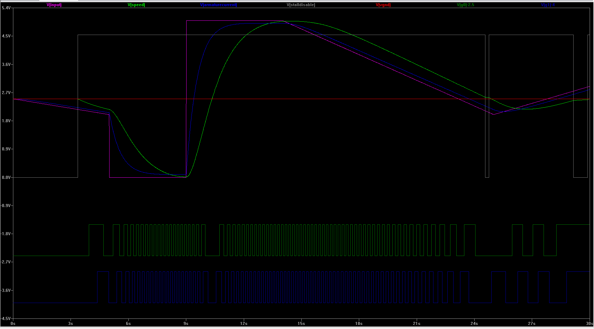

In the attached graph you can see:
- Input voltage to motor (blue)
- Simulated motor speed (green)
- Simulated quadrature decoder output (the digital signals at bottom)
- Rectified speed magnitude signal 0V...5V (red)
- Digital motor direction information

The circuit is a simulator. I want to simulate in hardware the output of a quadrature encoder (and dc motor itself). I need a V->F converter to translate the analog speed signal into a clock signal for 2bit binary counter.. which is then converted to gray code. The AD654 is one option, but it is very expensive chip (close to $10). How fast do you think I can make this circuit work:
The V to F converter does not need to be extremely linear etc. but I would like to get at least 100kHz.
The whole Idea of the circuit is that it is not practical to provide 10..20 students a dc motor with all sensor and power amplifiers etc. This simulator is easy and cheap to make and students can connect it easily to any microcontroller. And they can use it easily in computer classroom environment. With the simulator you can practice system identification, closed loop control etc. using real microprocessor. It is also easy to add disturbances and noise into the system.

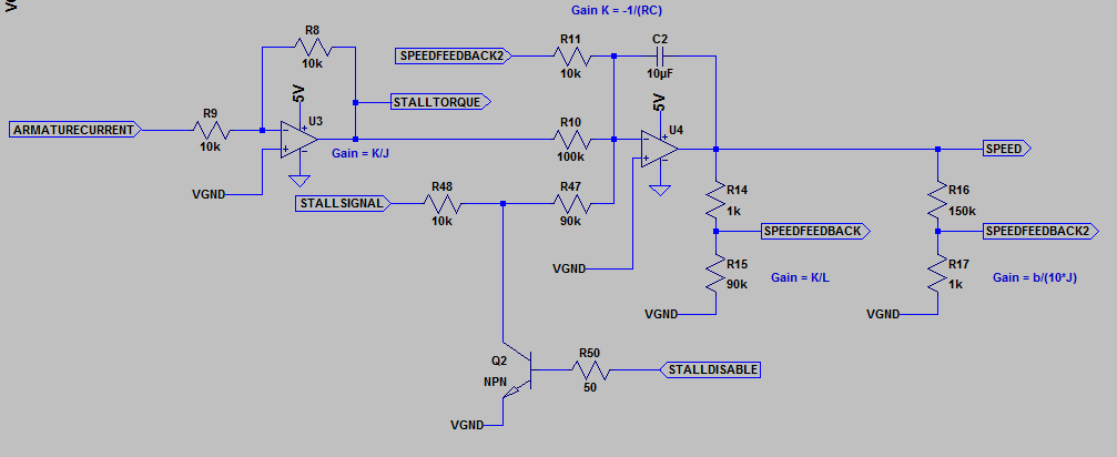

Well.. I managed to implement the stall situation (static friction) simulation.

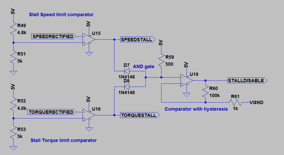

I think I have the stall condition at zero speed simulated, but I am not completely sure if this is a good solution. It seems to work in spice, but will there be problems with practical circuit?
The idea is to monitor speed and current. When speed is zero (or near zero) and armature current (torque) is below a set limit, then the current signal is subtracted from the speed integrator.. therefore keeping the speed at zero until the torque reaches a static friction limit.
I have been pondering why this simple solution works and I have not found any (practical) drawbacks, but I feel like there must be something I have not counted for. So I would like somebody to play the "spot the mistake game". The four graphs show some simulations and the circuit that disables the current feed to the speed integrator. The signal called "stallsignal" is just an inverse of the "stalltorque" (I know.. bad name for this signal). It is fed to the speed integrator when a stall condition is valid.. therefore cancelling the torque information.. which leads to stall in motor speed (until torque is high enough).

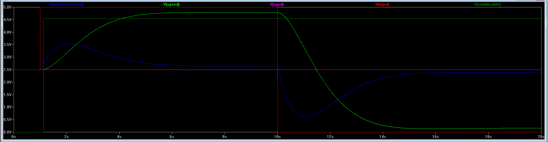

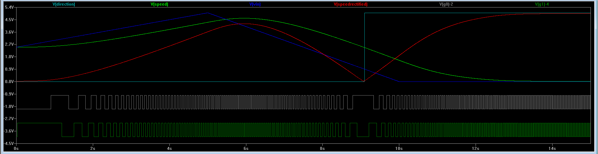

You can see the "stall torque" acting in the spice simulations.
I think such a range is going to be extremely difficult to produce with a relatively simple analogue circuit. Why so high a frequency? Assuming a top motor speed of 12000 rpm and a shaft encoder with, say, 8 segments the encoder would generate a max frequency of 8 x 12000 / 60 = 1.6kHz.
I don't follow the thinking there. Surely, at speed = zero, current is at maximum (because there is no motor back-emf), torque is at max and greatly exceeds static friction (otherwise the motor would never start to rotate)?
The 500Khz was an optimistic target because many encoders are rated at max 500Khz (at least the ones I have used). The actual frequency range is not that important.. The near zero speed (near virtual ground) performance is more important than the maximum rating. Still, it will be good practice for me to try to make that thing run as fast as I can.. just for self education.
The current is not maximum at stall condition. There is an AND gate that compares two signals; Speed and Torque. When speed is zero and torque is small that is considered as "stall condition". When torque (armature current) is high enough then the "stall condition" is released and motor starts to speed up. Take a look at the graphs.
