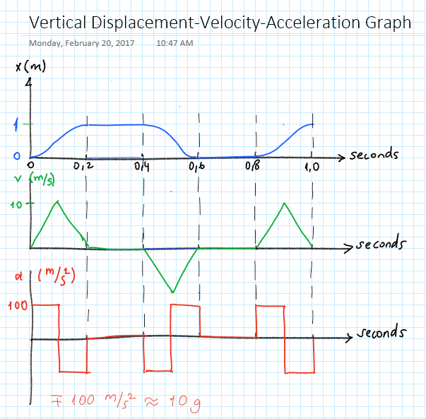

  • A 0.5 kg load needs to be moved up and down between positions A and B. The (vertical) distance between A and B is 1 meter. The trajectory followed for the up and down motion is free.
  • The load needs to be standing still in point A for 0.2 seconds, has 0.2 seconds to move up to point B, should be standing still in point B for 0.2 seconds and has 0.2 seconds to move down again to point A.

- for acceleration a in 0.1s and -k in 0.1s to travel 0.5m in each state of +/- acceleration
- d=1/2 at² for d=0.5m , t=0.1s a=2d/t² = 100g
- F=ma = 0.5kg *100g= 50 N
There are many mechanical unknowns'

My rough calculations are a bit different, but yes it is fast! Expected max vertical velocity is 10 m/s though.
But how to achieve such high speed (from zero speed) with an ac motor within 0.1 sec is one of the key questions now. Similarly, stopping it within 0.1 sec?
a=2d/t² = 100g = (2*0.5)/0.1²= 1/0.01=100g and v=at = 100*0.1 =10m/s not 50m/s
As in HDD servo positioners with a 100g change in acceleration the servo must switch from Acceleration mode to Position Error servo control to provide high position dampening and minimal overshoot. This requires precision position feedback near endstops and may use motor current to control acceleration.
The mechanical details are still unknown to decide if one needs a reciprocal driving piston actuator with a flat tipped camshaft or a long linear motor.
Since a "jerk is defined as j=da/dt which affects mechanical wear directly the transition from 100g to 0g almost eliminates a mechanical reciprocal solution as the position is not sinusoidal like an engine crankshaft.
Can you shed some info on the mounting and cost of this mechanism (lens?)?
I did some Fourier Analysis to indicate the Jerk stresses and compromising these would require
extending the stop time interval to allow for setting time to reduce jerk levels( only unfiltered j is shown)

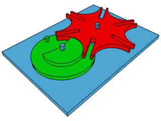

Maybe just a good old Geneva Mechanism:
To handle the rapid acceleration I'd gear it down on the input side, with a flywheel on the fast/input end of the gearbox. Then to get your 180-degree flip, gear it up on the output side.
For precise alignment, have an alignment feature at the very end, like a spring loaded bearing roller that falls into a notch on the lens holder since there will be non-zero backlash on the gears
Yes it's complicated and the forces will be high, but so is doing this using a servo. If you use a 4 side geneva gear you only need to gear up 2:1 at the output.
