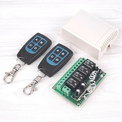

The simplest approach I can come up with is a four channel remote with relays from ebay, plus four power relays to control the motor connections.
eg.
plus four, two-pole changeover relays rated eg. 10A or more.
Possible type:
The relay contacts on the remote board just connect power to the coils of the four separate relays, with the other side of those coils to ground (negative). Add flywheel diodes across the relay coils.
For the motor power circuit:
Take power to the two common contacts of the first relay. Link the normally closed contacts of that to the next relay.
And repeat, both normally closed "daisy chained" to the two common of the next, through all four.
Then use the two normally open contacts of each to connect to the appropriate two motor wires to give each of the motor directions.
As soon as any one channel/direction is operated, it also disconnects power from any later relays so it's impossible to have a conflict and short anything or try and drive both directions at once.
