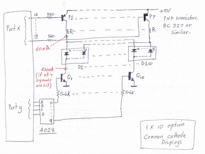

In my previous post, I wrote that you don't need Darlingtons. But I forgot that the PNP segment transistors (I'll call them Qa ~ Qg) have to switch up to 420 mA. So they will have to be Darlingtons.
I have also thought about the PIC programme. It is relatively easy. Briefly:-
Connect Qa:g to outputs 1:7 of the 74LS138. Set the address counter to 1. This will turn Qa on.
Do a lookup for each of the 10 digits to be displayed in order to convert them to the 7 segment format and store them in files say digit_1 : digit_10.
0. Turn all of the Q1:10 transistors off.
1. test bit 0 of digit_1 and if set, set the output that turns on the Q1 transistor.
2. Then test bit 0 of digit_2 and if set, turn on Q2.
3. Repeat this for all digits
4. delay for say 3 ms
5. then goto 0. and repeat for bit 1, etc.
It may be easier to decrement the counter and skip on zero, thus the above would be done in reverse, but the result will be the same.

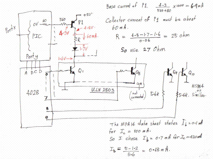

Hi ljcox,
I have decided to use 1x10 method you've suggested since I couldn't visualise and understand fully how the other 2 options function in term of s/w and h/w.
for this 1x10 method, I still have a few curiosity. I've never use a PNP before so I'm thinking is the current flow from Vcc to PIC?? If so, by setting Ic = 50mA, I'm sure PIC will damaged? That's mean I need another IC, like what eblc1388 suggest use a 7445 connected to PIC?
As for the R value, I'm not too sure since it's PNP, is the calculation as follow correct?
Ic = 5mA (1 segment) x 10 = 50mA
Ib = 50mA/100 = 0.5mA
base voltage Vb = 5 - [0.5mA x 560] = 4.7V (but the output port from PIC measured is 2.7v not 5v???)
Ve = Vb - Vbe = 4.7 - 0.7 = 4v
R = [Ve - 1.7 (1 segment)]/50mA = 46ohm
On the driver side, how do you come up with 5.6kohm?? I'm clueless. From the connection, does it mean that the total current of a digit is sinked through GND via transistor NPN?

taengi said:
Hi ljcox,
I have decided to use 1x10 method you've suggested since I couldn't visualise and understand fully how the other 2 options function in term of s/w and h/w. Do you want to ask questions about these options to help you understand them?
for this 1x10 method, I still have a few curiosity. I've never use a PNP before so I'm thinking is the current flow from Vcc to PIC?? If so, by setting Ic = 50mA, I'm sure PIC will damaged? No, the current into the PIC is determined by the 560 Ohm resistors. It will be about 4/0.56 = 7 mA That's mean I need another IC, like what eblc1388 suggest use a 7445 connected to PIC?
Ic = 5mA (1 segment) x 10 = 50mA Correct
Ib = 50mA/100 = 0.5mA To ensure saturation, you should make it about Ic/10 = 5 mA, hence my 7 mA above
base voltage Vb = 5 - [0.5mA x 560] = 4.7V No, Vb = 5 - 0.7. (but the output port from PIC measured is 2.7v not 5v???) I don't know why you measured 2.7V. Without any load, the PIC should switch between 0V and 5V.
Ve = Vb - Vbe = 4.7 - 0.7 = 4v No, Ve = +5V. The emitter is the one with the arrow.
R = [Ve - 1.7 (1 segment)]/50mA = 46ohm No, R = (5 - 0.2 - 1.7 - 1.6)/0.05 = 30 Ohm. Where 0.2 V is the PNP saturation voltage, 1.7 is the LED voltage and 1.6 is the saturation voltage of the Darlington transistors.
On the driver side, how do you come up with 5.6kohm?? The Darlington transistors have a very high gain, so they don't need much base current. See the data sheet. However, see my comments below. I'm clueless. From the connection, does it mean that the total current of a digit is sinked through GND via transistor NPN? Yes
The Darlington arrays ULN2003 (7 transistors) and ULN2803 (8 transistors) have internal resistors so they can be connected directly to the PIC.
So for Q1:10, you could use either two ULN2003 (and have 4 spare transistors) or one ULN2803 and two single Darlingtons such as the MPSA14 (with a resistor on each base)
The 7445 does not have enough current sink capability for your purpose.
So here is my suggestion. Note that I accidentally left the "S" out of MSPA14 in the note.
if i don't use these darlington transistor but the general purpose transistor, will the configuration still be the same? like if i use BC327 for PNP and 2N2222 for NPN
If you use the 2N2222, you will need 10 PNP transistors to drive them since the 2N2222 will need a base current of about 42 mA in order to ensure saturation with a collector current of 420 mA. The PIC cannot source 42 mA.
So if you want to do it that way, let me know.

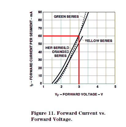

ljcox,
You are very conservative in estimating the voltage drop across the LED segment at 60mA current. The following is a typical graph from the datasheet of the 7-seg LEDs I'm using. It shows quite a large voltage drop. The "HER" in the graph means "high efficiency red".
