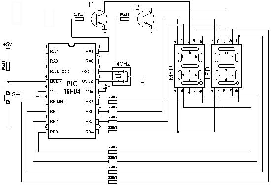

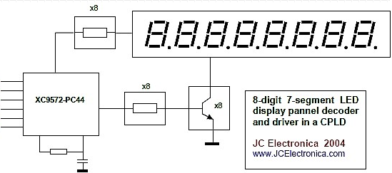

Although the design below is for a PLD it can be used on a PIC as well. you can expand it to 10 segments of course.
First, you drive the Common Cathodes with 10 transistors. NOT drive the segments with 7 transistors at 9v... There's no reason to use more than 5v in most < 1.8" LEDs
In a nutshell.
You can only light ONE CC display at a time (any number of segments is ok) So you must turn on your 2n2222 only one at a time (muxing) and you must refresh the complete display constantly at better than 40hz (some people still see flicker at that speed, I often use 60hz)
If you dont want to mux but drive the displays directly then you simply don't have enough I/O on a 16F877. You should consider a decoder IC.
I like to use a technique called charlieplexing, very I/O efficent but requires a little bit of fancy software. You can see an example of the hardware (Zebra) on my site.

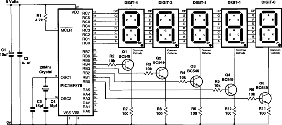

I use 4017 to select each digit out of 10 digits. RB1 from 877 connected to Pin14 of 4017 will ON/OFF to enable the ring counter. this would save my 877 I/O ports.
500uA is calculated from Ic/HFE [50mA/100], is that correct. I've read some of your previous thread regarding display so I come up with this design.
I use transistor to drive each segment coz the output from PIC doesn't sufficient to lit on the segment [approx 2.5v] which is a wonder to me as well coz I expected aprrox 4.5 ~ 5 v. I also want to reduce the use of BJT, so that's why I use 4017 to select 10 digit instead of another 10 transistors.

You don't need R2.
The transistor is configured as an emitter follower.
So connect the base directly to the PIC, transfer R1 to the emitter side and connect the collector to Vcc.
Neither do you need the counter as the PIC can do the counting - provided that there are enough i/o available.

Yes, you need to pulse each LED with 50mA (for your example), as they are each on 10% of the time they effectively get 5mA each.
You don't need to worry about base current, however your positive driving method is very poor - it's best if you use PNP transistors from the positive rail, but that would require NPN's to drive them (due to your 9V supply rail). As it stands, with the NPN transistors, the maximum voltage to the displays is only 4.3V, so you're wasting your 9V supply anyway!. Also the 140 ohm resistor in the collector isn't a very good idea, and will make it difficult to calculate the current to the display - moving it to the emitter would make more sense.
another thing is, on the 2N2222A datasheet, it stated that Ibl [base current] max is 20nA, does it mean I cannot supplied more than 20nA to the base of 2N2222A?
No, ignore everything about the base! - except I would suggest you use something like 470 ohm resistors between the PIC pins and the bases, to give better base drive.
Not a very good example though?, the 10K base resistors are too large, and the 100 ohm resistors are in the wrong place - simply moving them to the collectors of the transistors, and lowering the base resistors, will make the circuit work properly.
However, a considerable improvement would be removing the 100 ohms all together, and adding limiting resistors in the segment connections instead (from PortC of the PIC).
