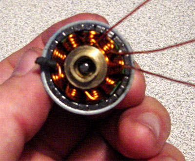

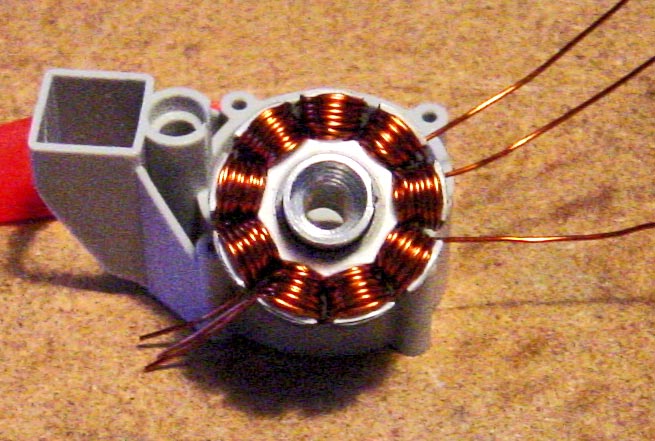

I am talking about motors that I take out of CD rom Units for Rc planes, I rewind the motor, replace the magnet ring with strong magnets and here is the result...
Motors that can pull 23 amps at 11 volts ( that is if you set it up with a big prop)
