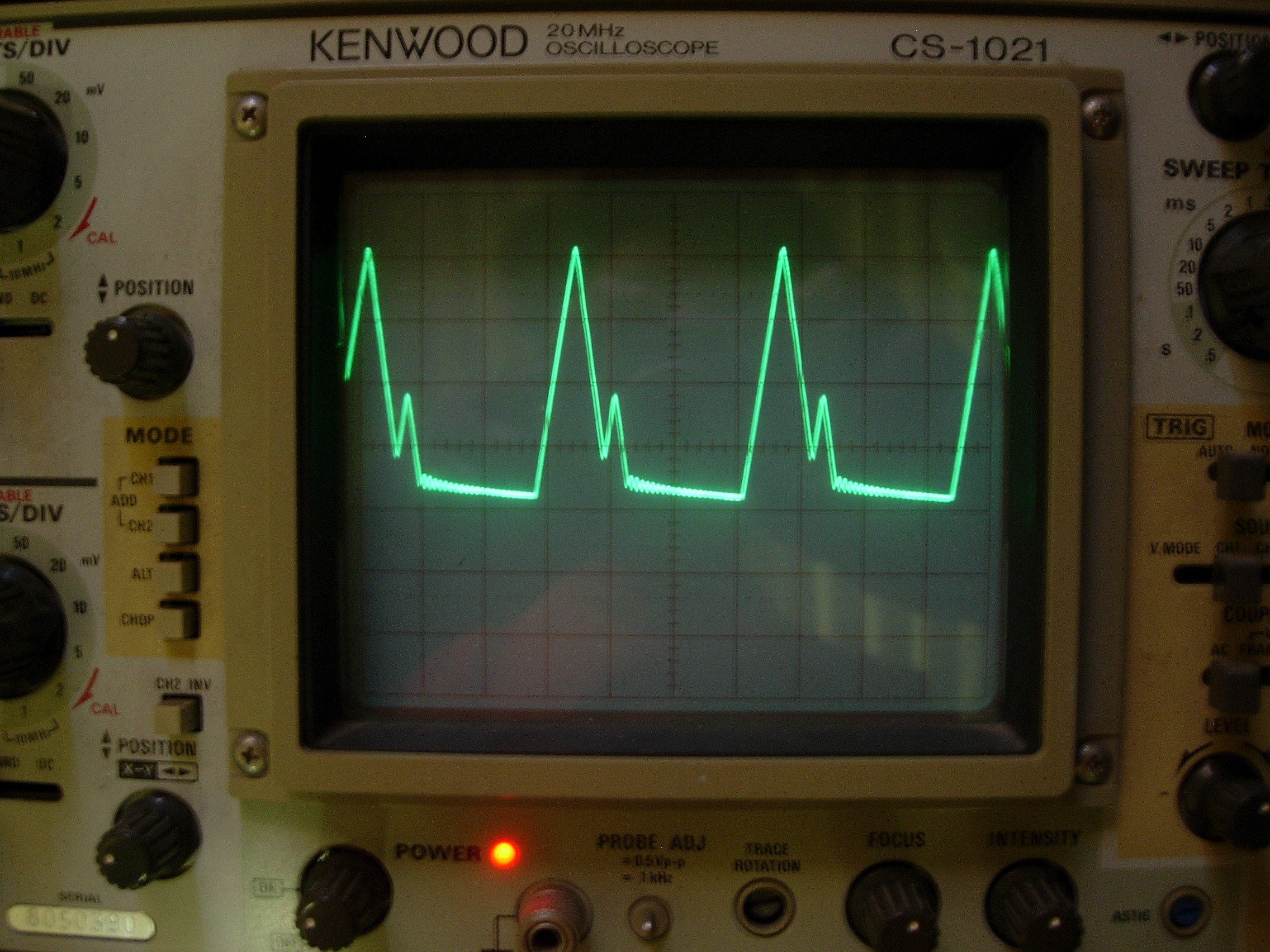

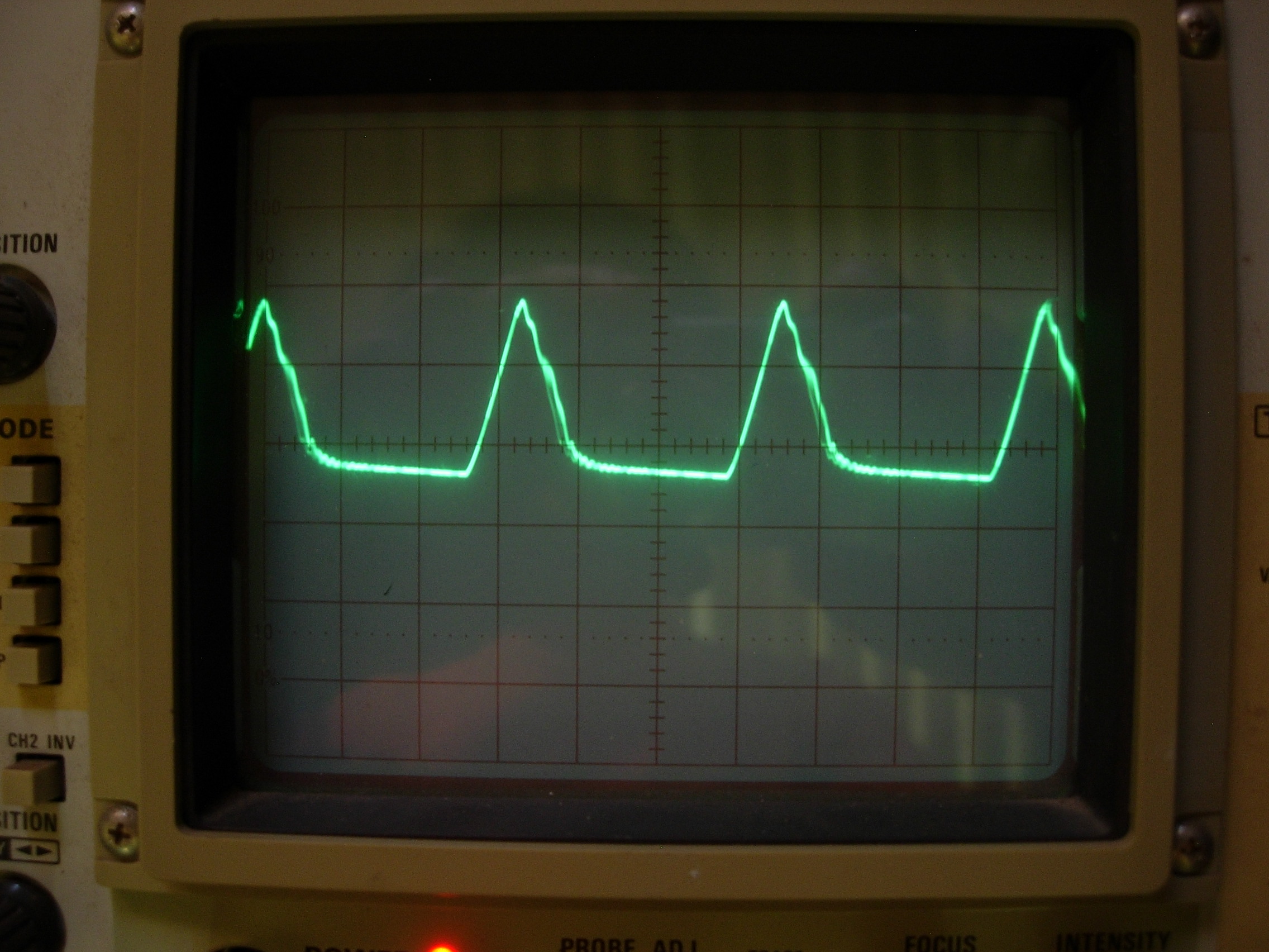

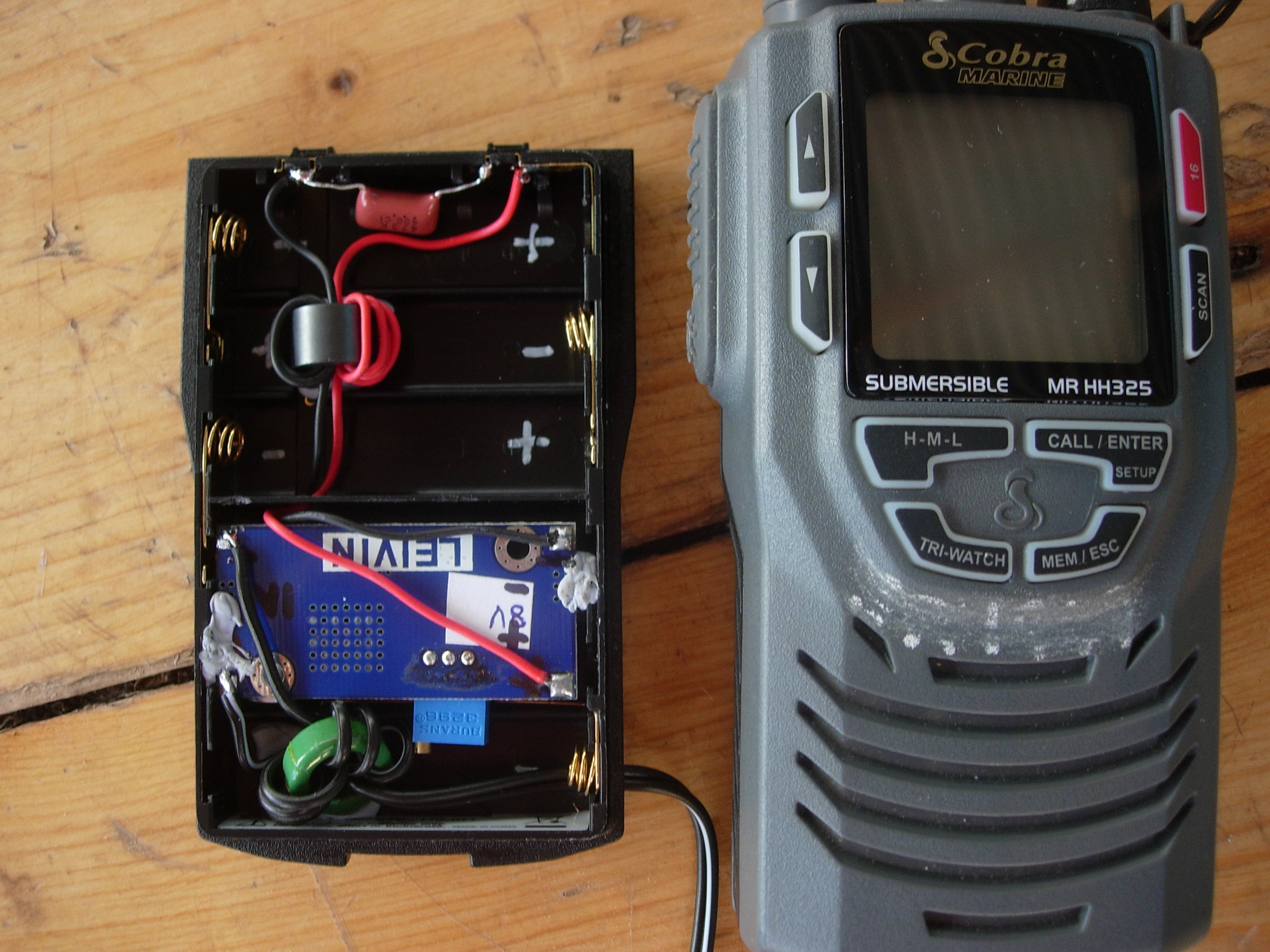

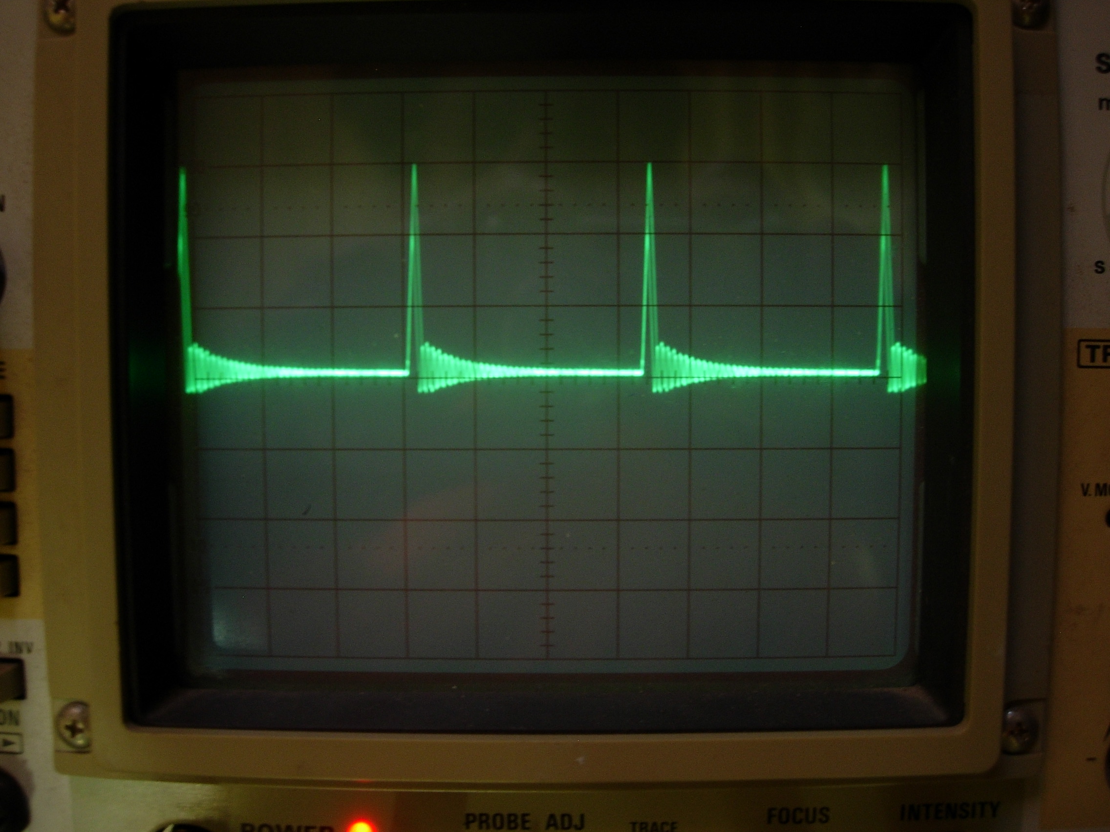

This is the wave form on the DC output loaded 20mv/div vert. No load 5mv/div vert. With a 1000uf cap on output 5mv/div vert. Also one ive fitted to a VHF hand held tranciever to run it of 12v.

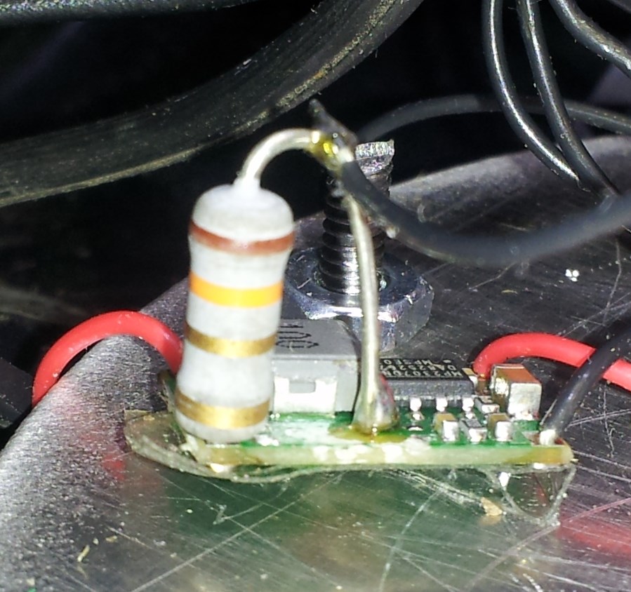

Here's a photo of one of these buck modules modified to be a LED driver, driving 3 watt LED at just under 700 ma, LED is rated for 800 ma, so it should last quite a while, I'll probably get to pass this on to my kids or grand kids.:)

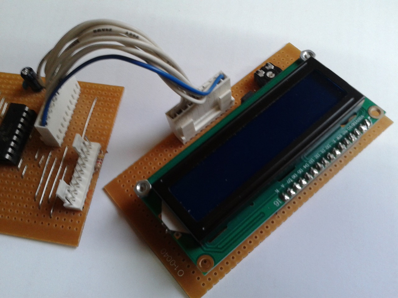

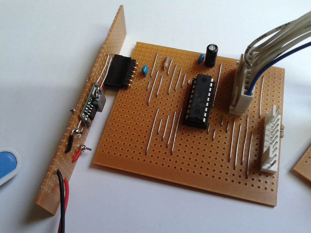

OK, I've actually used a couple of the little regulators now, both on identical little boards, in order to provide external power to tutorial boards via the PICKit3 programmer connection. I've added a picture of the board (the socket connector strip also came from Bangood), a picture of it connected to an 16F1827 tutorial board (nothing there from Bangood), and also a picture of my new LCD tutorial board, using an LCD from Bangood.

Just adding the additional capacitors made a disproportional improvement in the reduction of the switching energy (like that on the pics from the CRO) on the input/output leads - more than you'd expect from the increase in capacitance - implying that the onboard units are probably a bit higher impedance than the new, outboard units. This may have meant that they would be dissipating a bit of heat on their own, probably resulting in reduced lifetime. For as cheap as they are, I wasn't counting on them having very good capacitors (or enough capacitance!) anyway!
