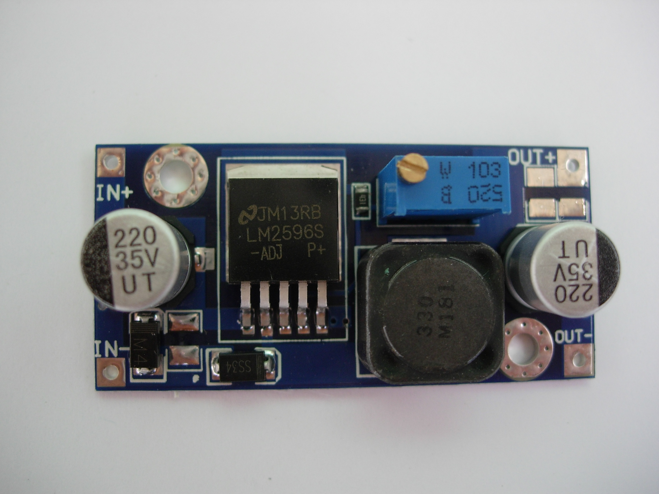

Ive been using these of Ebay, they are similar but $1.50 ea freight free in lots of 5. They work great LM2596S REG.JPG
I've got some of those too debe - nice little modules but I've found the input capacitor gets quite warm on mine.

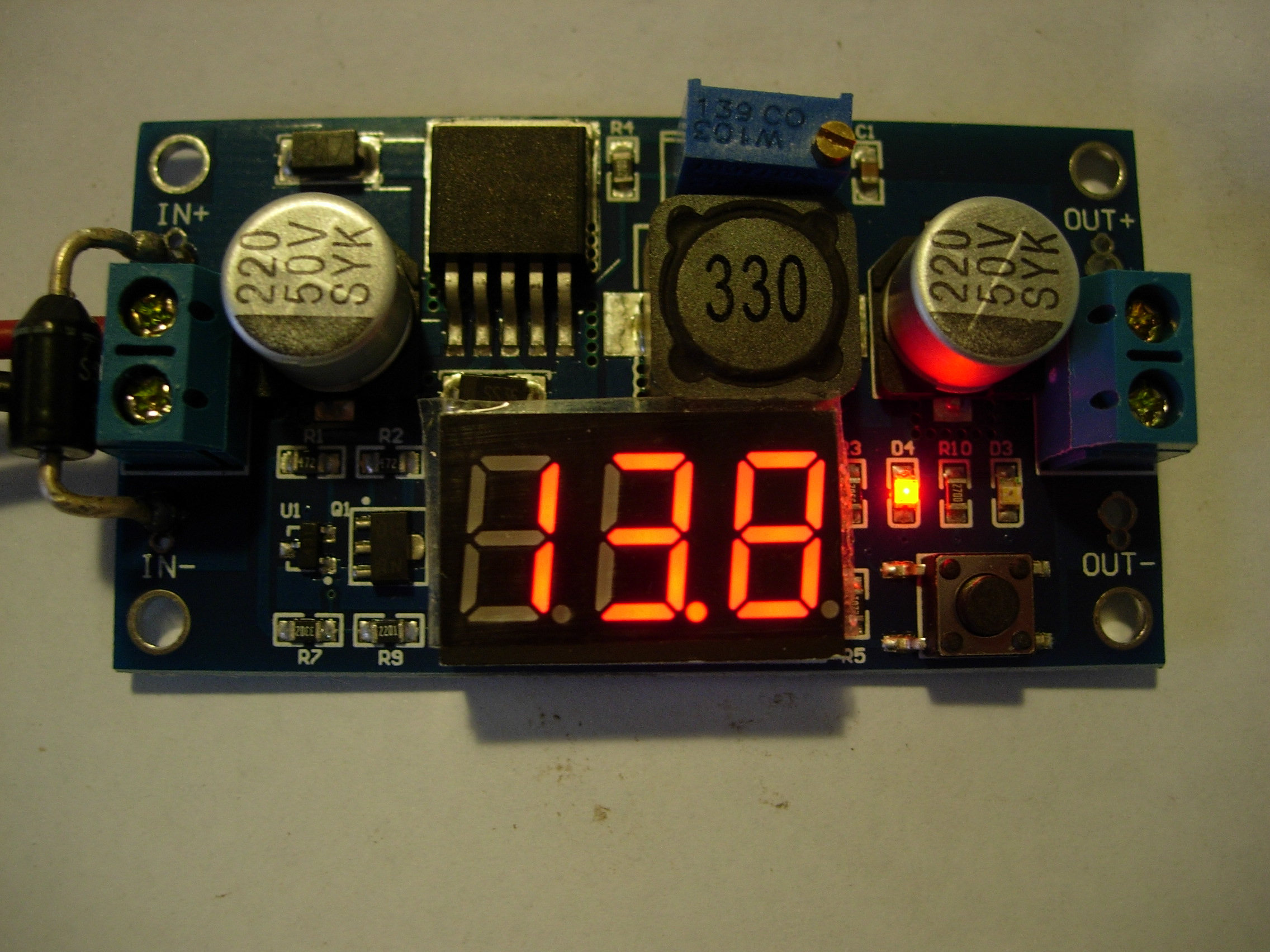

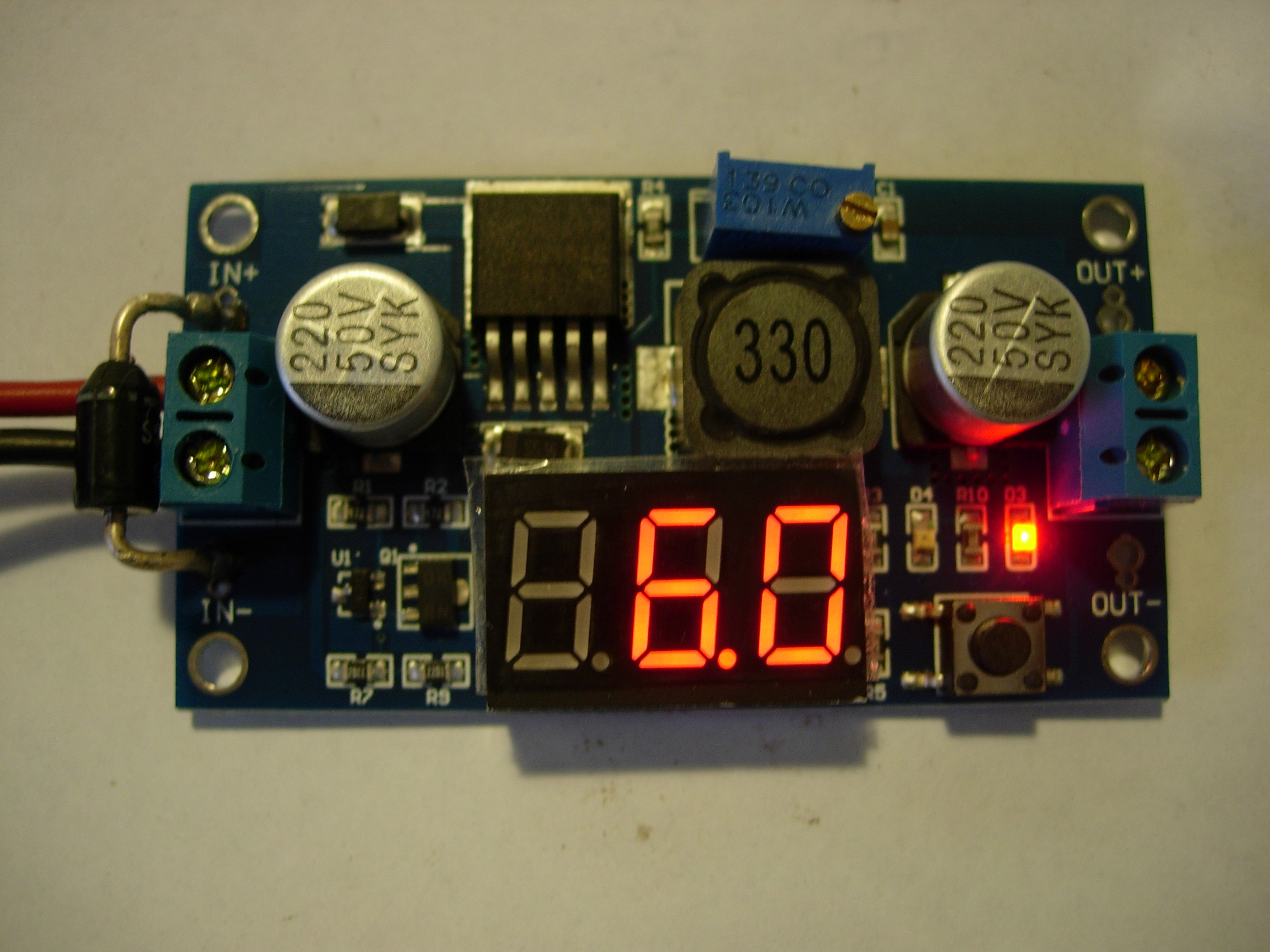

Another one from Ebay ive been using has a volt meter, & can by pressing the push switch read output or input voltage. These are $2.48 + 99c freight.
Yup - I have one of those too. Mine is about 0.5v out on the readings though - not incredibly accurate.

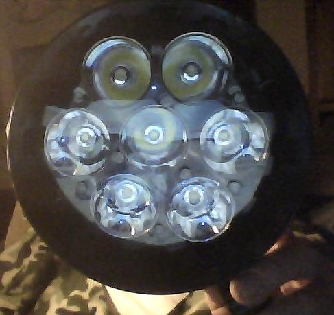

I ordered some of these and found them to be very useful as LED drivers that limit current after some modification. For instance, I had a broken spot light, there was a little spring rolling around inside the bulb, according to my wife after she dropped it, filament. :)
So I took some 3W leds and reflectors and mounted them in the spot light. There are 3 sets of 2 LEDs in series with a modified step down module. The modification is to remove the pot and 1 resistor, cut or remove some traces, drill a hole for the lead of a new resistor and remove some ground plane on the back side from around the hole. Now each LED passes just under 700 ma at any voltage from about 10 to 24 vdc. Very bright, probably just as bright as it was before, but a whiter light and not quite as sharp edges, but just about the same width of beam - narrow-.
The value of the resistor is .9 volt divided by current desired, I use a 1.3Ω resistor. The return from the LED ties to the lead of the added resistor.

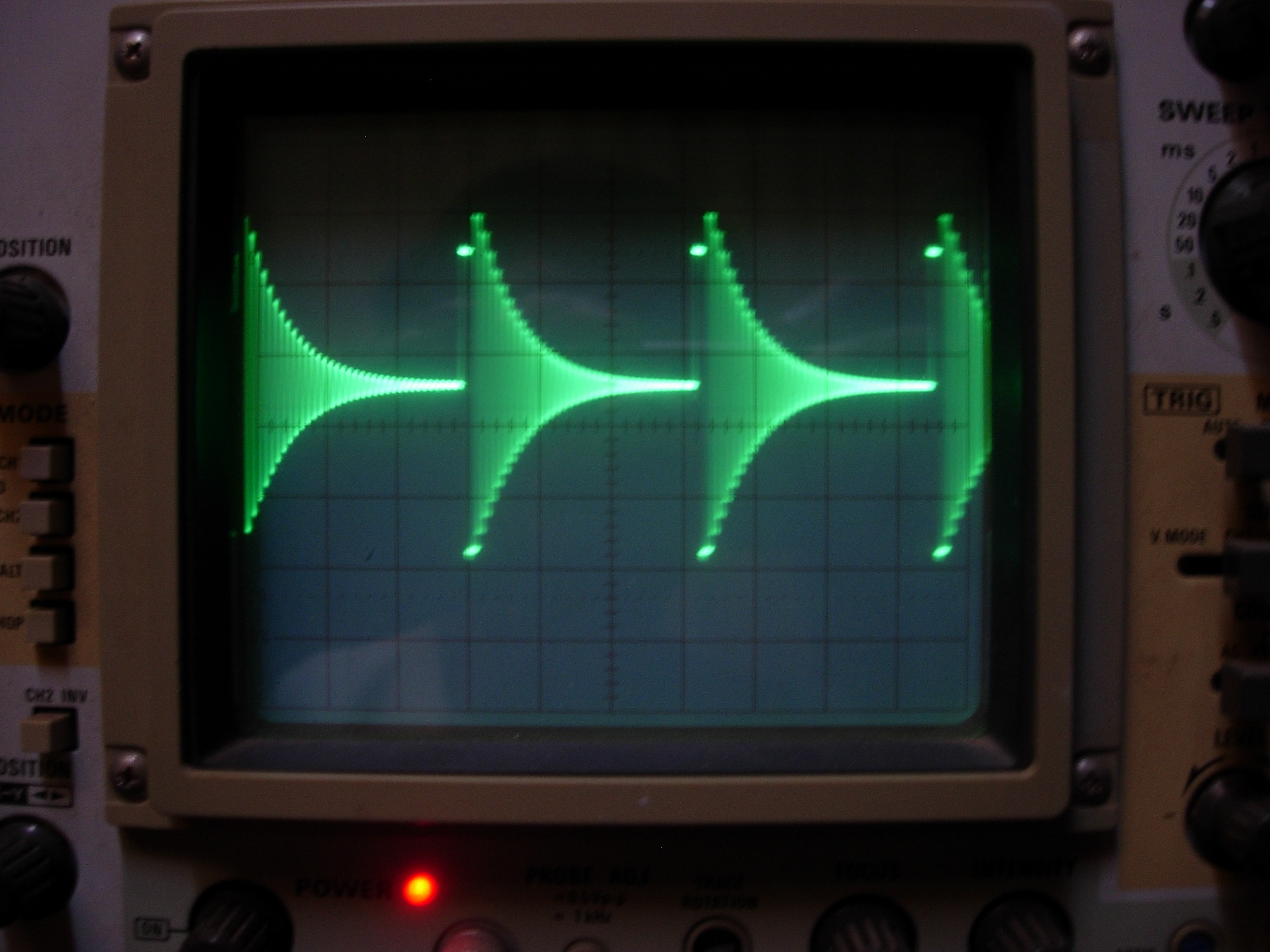

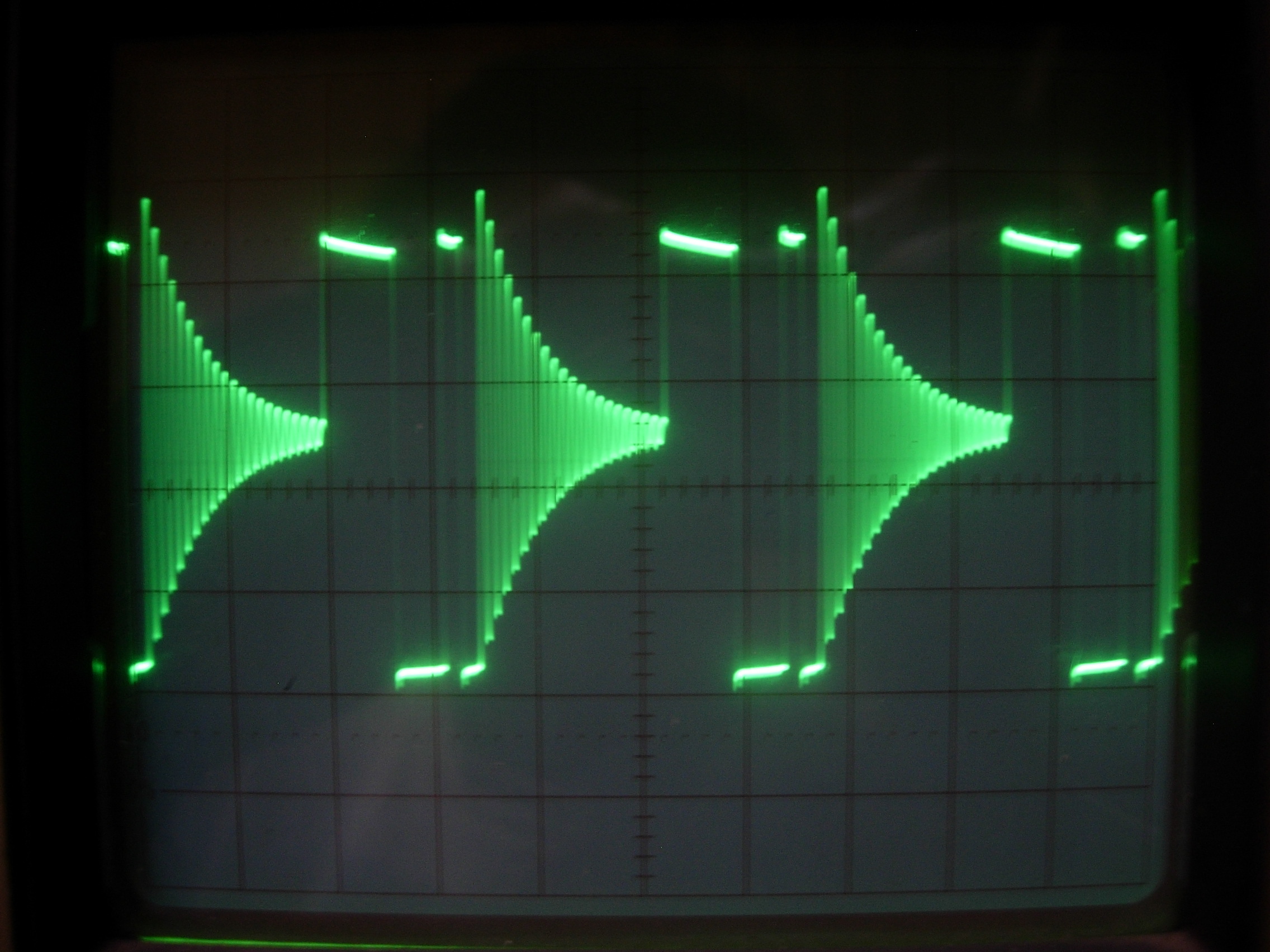

On another forum a person claimed they got some with an incorrectly marked chip. They were marked LM2596 which run at 150Khz, but didn't they ran at 50Khz. I did purchase mine from the cheapest Chinese Ebay seller & im quite happy with the ones I purchased. Did a few checks on mine to see what I had & they appear genuine. The wave forms are taken on pin 2 of the chip, CRO set at 2Us/div, Vert .1V/div probe on x10. One pict is no load & the other is with about300ma load.
