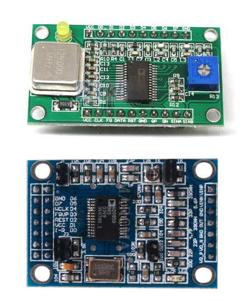

Looking to get one of these board but note there are 2 different types, one with a blue trimmer one without.
Have not yet been able to work out the use/need for that trimmer or which board to go for ?
Did notice another thread where the poster was having problems with the boards without the trimmer.
Any advice welcome..
I have used the board without trimmer, quite successfully on a couple of occasions.
I have had two versions of that board, on with an AD 9850 and the other with an AD9851 (higher clock frequency), both worked OK.
If you look around the website* of the suppliers of those things, there is usually a link to a schematic which should make the function of the pot fairly obvious.
* Just did a quick google, and the first site I looked at says that the pot adjusts the reference voltage to the comparator in the 9850, and so adjusts the mark-space ratio of the squarewave output from the 9850.
Thanks, think I will have to change search engines and my glasses ! looked a several boards/sites and unable to see a schematic or any mention of that pot.
However looking at larger pics of that lower board it does look like there is a small trimmer next to the upper right jumper.
Seems like they are both very similar then.
Just had a look at mine and they have the pot also.
I had not taken any notice of it before as I always used the sinewave output.

Well not quiet :), just a bit of info for anyone reading this post who like me is new to the AD9850 and has also purchased that lower pcb will the all smd parts.
Below is a clear pic of the different output pin assignments and some simple code that works at a fixed output with just a basic arduino uno board; no display or keys required.
The 9850 board should have jumpers on J2 and J3 .
There also seem to be a lot of chat about the voltage these board should be run at , seems the oscillator modules used may be 3v3 only devices on some boards.
Running at 5v my board uses 120ma and the oscillator case gets slightly warm, at 3v3 it uses 60ma and runs cool.

There are as mentioned 2 diffo clock frequencys.
I have a module with the pot, its for pulse width on the squarewave o/p.
I got it to work with an lcd and a rotary encoder, sweep on the othwer hand proved difficult, the registers that control freq need loading with odd ball values, you need some nifty way of calculating desired freq to the correct values for the registers.
The other issue is that the o/p isnt linear, it drops off rapidly with freq, so you need an auto limiter circuit for a sweep gen, or some self calibrating software on vb or something like that.
Also, if you are only using the sine wave output, disable the input to the square wave section by removing R12 (1k) on the modules with the blue trimpot. (Looks like R8 on the other, bigger style module)
Certain settings of that pot cause interference/spurs on the sine output.

Not sure why the pot setting causes the problems. Maybe some sort of harmonic interference, haven't really chased it any further to find out the reason.
It appears on both AD9850 and AD9851 modules I have tested. At some settings it distorts the waveform and in others you can see additional spurs or noise on the output.
