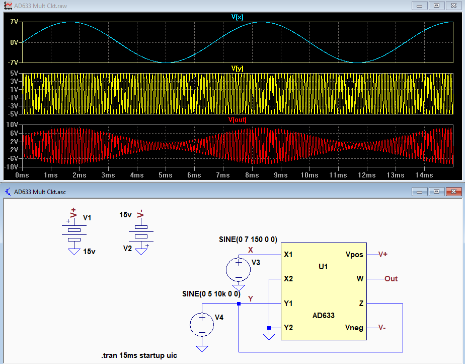

Please can someone help on what has got to be a simple oversight by me.
I am using the AD633 in spice as an amplitude modulator, but it's just giving me a rubbish output. Output is a few mV when the input is a few V, and it is not what I'd expect from an AM signal. My circuit is from the datasheet example, and plenty of entries online allude to using this circuit, I can't get it to work. This is the second AM arrangement I've tried, the first with a transistor and I got similar rubbish results. I am clearly missing something, but after nearly 8 hours of searching I can't find the issue and it's driving me nuts!
If anyone has experience with this IC, please can you take a look?
Attached is the spice simulation (LT spice - I haven't used this package before, so could be an error there), also the green trace is the output. Input conditions are labelled on the schematic.
Any pointers / ideas really appreciated.
Pete

It looks like there is 5V offset on the input signals.
Set that to 0v.
Here's my LTspice simulation:
I removed the input signals' DC offset.

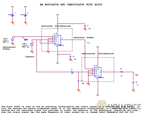

Sounds like connected improperly or wrong bias for linearity.
You can double check here:
Please verify the actual polarity on pins 5 and 8. Use a DMM for that.
