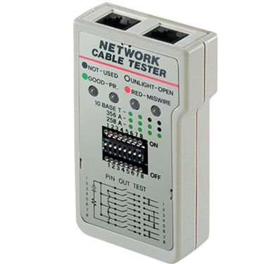

In case I wasn't clear, both the testers showed a complete PASS in all respects just like this
for whatever these little testers could test, for both plug setups, but in the end only the Cat 6 plugs worked for data transfer (for the actual task) between the two routers.
I use:
with an adapter I made that basically puts a remote on the end of it. It just consists of 4 bi-color LED's.
What I like about it, is that you can "wiggle" the cables and see bad connections. I have no idea where to get one now.
You can use a cable tester like yours to test for miswires. These seem to SLOWLY sequence looking for wiring errors. They won;t detect an intermittent contact. That seems to be more of an issue for me.

The testers tested perfectly for all sections of the cable, for the two separate pieces of cable, and for the long pieces connected together, with the tests coming through the same and perfectly with all Cat 5e RJ45s, and with all Cat 6 RJ 45 plugs.

That's when the simple continuity testers work great. You can flex the ends and see the discontinuities immediately. Very expensive qualifying testers would probably also see the faults.
