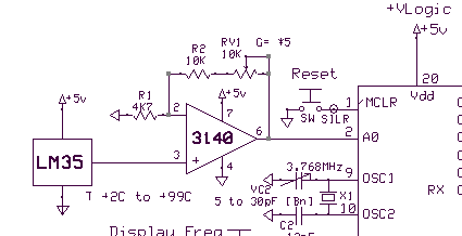

Hi I have done a temperature display using LM35 & it worked.
I just right justify & read the ADRESL.
Ex: If the room temperature = 25C then it’s giving 51.2 steps.
So this is the ADRESL value, when I divide by 2 its showing the room temperature.
That’s fine it’s working.
What I need is I need to add a decimal point to this final temperature.
When I divide the AD result steps its always giving a round value.
I need temperatures like this 25.2, 25.3, and 25.4 etc……..not like 25, 26, and 27.

hi Suraj,
As you are using a LM35, use a simple opa, so that 5.12Vout gives 1023 adc value.
Use the PIC's internal +5Vref
When you convert this value to ascii for the display, just insert a 'dp' between the two lsd's
This will give a temperature range of +2C thru +100.0C with a 0.1Cdeg resolution.
As the LM35 give a +10mV change per Cdeg, at 102.3Cdeg its 1.023Vout.
A simple NI opa with again of approx 5 will raise this to 5.12V
If you only need to go as high as 60Cdeg, the opa can be powered from +5V,
for the full 102.3C the opa needs at least 9V on the power rail.
Do you follow OK.?:)
This is the method I use with a CA3140 opa, [goes close 0Vout]

added a clip from my drawing.

hi Suraj,
Look at the EDIT for the drawing on my last post.:)
Eric's diagram shows what I had in mind. If you can't find the CA3140 then the TS912 or any other rail-to-rail OpAmp which works with a 5V supply will do. Make sure the OpAmp you choose has both rail-to-rail inputs AND outputs. The pin out will be different from the CA3140.
Whilst the opamp solution with give the greatest range of readings on the ADC it may not be the most accurate solution. The accuracy will be dependent on the stability of the 5V supply as this is what the ADC uses as its reference voltage. Using an accurate 2V reference will be more stable and supply independent but will only have half the resolution - 0.2°C. A combination of opamp and an accurate voltage reference would be the most accurate, however it's pretty academic as the LM35 is only accurate to 0.5°C.
Hello thanks for that good points I'll use an op amp to give inputs.
And also I'll concentrate on a smoother power supply.I'll tell you the latest progress.
