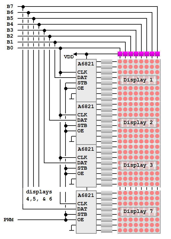

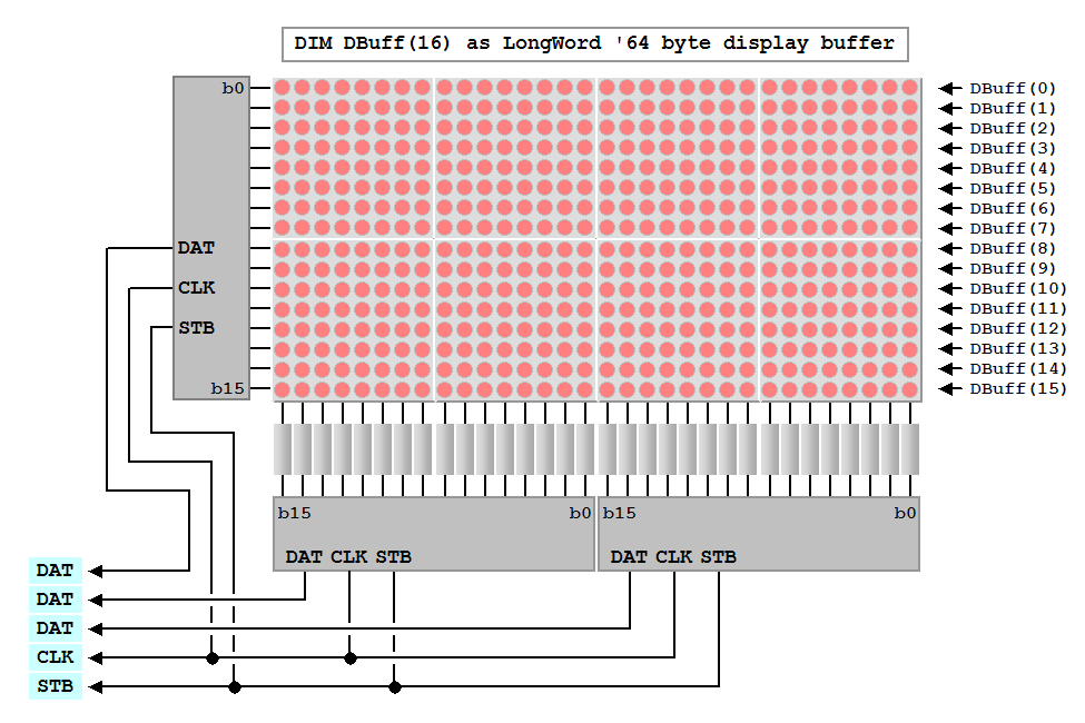

The problem is probably the BASIC Stamp. It's just not very powerful or fast. Try a compiler like PIC BASIC, Great Cow BASIC, C or assembler, lots of speed and much faster than the BASIC Stamp.
I wonder if you're giving up too easily? But I doubt I can be of much help since we speak different languages and mcu's (grin).
(1) Use an interrupt driver to paint the display hardware from a 64 byte (512 bit) "display" buffer. I would throw 16 special "shift register" formatted bytes onto the bus each interrupt and then configure the 16 special "shift register" bytes from the "display buffer" for the next interrupt cycle (the next row).
(2) Design a "character generator" that will place a graphic character from your graphic character set tables anywhere in the "display" buffer at position 'HPOS' & 'VPOS'. I used a character generator like this to "paint" characters and graphics into the video RAM in the EPG and EPG II (earliest versions of the current TV Guide Channel, circa 1984).
Example; setup HPOS and VPOS, tell the character generator which character set table to use, then send the character generator a string of characters ("AAaa442y"). Each character in that string would be mapped to an 8x8 character bit pattern or an 8x8 graphic pattern in a character table. As the character generator places the bit pattern for each character into the "display buffer" it auto increments HPOS for the next character.
Here's an interrupt driver for an 8x56 display (scanning columns again, sorry). I'm sure it's gonna seem completely alien to you but what the heck, maybe it'll help. The display is drawn vertically to show the bus/interface connections but it's actually a horizontal display.
COLUMN  equ     h'20'           ; column number (0..7)
COLPOS  equ     h'21'           ; column ring counter (00000001)
SBuff   equ     h'38'           ; scan buffer 30..37,  8 bytes
DBuff   equ     h'40'           ; disp buffer 40..77, 56 bytes
WBuff   equ     h'78'           ; work buffer 78..7E,  7 bytes
        radix   dec
;  K8LH High Performance 9-pin Display Subsystem ISR Driver
;  This subsystem hardware/software design supports from one
;  to seven 8x8 display modules.
;  One LED column in each of the seven 8x8 modules is driven
;  during each 1.0-msec interrupt cycle for an overall 12.5%
;  duty cycle and 125-Hz refresh rate.
;  A minimum PWM 'on-time' of 1% provides a 10-usec window
;  at the start of each interrupt cycle where the PWM signal
;  drives the MIC5821 Output Enable lines high (display off)
;  which allows me to use the RB7-RB0 column driver lines
;  temporarily as MIC5821 <DAT> and <CLK> lines to load the
;  seven MIC5821 shift registers.
;  Serial data is clocked into seven MIC5821 shift registers
;  in parallel by stuffing PORTB with eight data bytes, each
;  containing <DAT> bits in b7 through b1 and a <CLK> bit in
;  b0 which is preset to '0'.
;  The 1% minimum PWM 'on' time limits maximum brightness to
;  99% but the 1% loss of brightness is inperceivable at the
;  high end.
;  24 cycles, 4.8-usecs (20-MHz clock)

matrix-7x8x8-png.13422

Forget that previous example. It's way off base. Can't use PWM on that 16x32 board and you're scanning rows not columns.
I did however put together a PIC driver for that ($12.90) 16x32 matrix display just for giggles and I'd be happy to pass it along if you or someone else on the forum asks. I'll work on character generator code next.
Mike
Mike,
I had almost given up on this headache. I would love to see what you have for this IF YOU HAVE IT ALREADY. Don't spend the time unless it's ready or close so you dont waste your time.
Thanks again Mike!
This is my second version of a simple PIC ISR driver for your OEM 16x32 matrix display board. I didn't have the board schematic or the driver data sheets with me when I wrote this code so I may have the bit pattern backwards. I believe from the documentation that the STB signal is an active low output enable (this display may be a good candidate for PWM brightness control).
Mike
DBuff   equ     h'00'           ; disp buffer 00..3F, 64 bytes
WBuff   equ     h'80'           ; work buffer 80..85, 6 bytes
RowPos  equ     h'86'           ; ISR, 16 bit row ring counter
Row     equ     h'88'           ; ISR, row number (0..15)
Counter equ     h'89'           ; ISR, counter
        radix   dec
;  K8LH Experimental 16x32 6-pin Display Subsystem ISR Driver
;  This subsystem driver was designed for an OEM 16x32 display
;  that uses three 16 bit serial-to-parallel driver IC's.
;  One 32 LED row is driven each 1.0-msec interrupt cycle for
;  an overall 6.25% duty cycle and 62.5-Hz refresh rate.
;  Serial data is clocked into three 16 bit shift registers
;  in parallel by stuffing PORTB with 16 data bytes, each
;  containing <DAT> bits in b0, b1, and b2, a <CLK> bit in b3
;  which is preset to '0', and a <LAT> bit in b4 which is
;  preset to '1'.  This driver loads the shift registers with
;  bit 15 data first.
;       RB0 = DAT line on row driver IC
;       RB1 = DAT line on 1st column driver IC
;       RB2 = DAT line on 2nd column driver IC
;       RB3 = CLK line on all 3 ICs
;       RB4 = LAT line on all 3 ICs
;       RB5 = STB line on all 3 ICs
;  263 cycles, 52.6 usecs, 5.26% "overhead" (20 MHz clock)
;              33.2 usecs, 3.32% "overhead" (32 MHz clock)
ISR_load_shift_registers
        clrf    FSR1H           ;

Tim,
I've got those pdf files now and I've looked at your code a little closer. Looks like CLK is active high, LAT is active low, and STB is actually an active low Output Enable (hardware will support PWM brightness control, cool).
Also looks like I've got all of the bit patterns backwards. I'll modify my PIC driver.
If you can dimension an array as 32 bit long word you could map the entire 64 byte display buffer to a 16 element array. That would allow you to modify any row by assigning a new value to it's corresponding array element. Your compiler would hopefully translate that array element assignment into just a few instructions that copy the 4-byte/32-bit argument directly into the display buffer. Of course the display driver would handle the buffer-to-hardware process in the background.
DIM Display(16) as LongWord

Can I confirm the "row" pattern is active low ('1111111111111110') ?
Mike,
The row is an active high but set to move from the top row to the next lower row when it equals the following:
data1 = data1 << 1 {This is the code use to shift the bits left}
data1 = 1 (2^0) when on the 1st / top row or (data1 = 0000000000000000)
data1 = 2 (2^1) when on the 2nd row or (data1 = 0000000000000001)
data1 = 4 (2^2) when on the 3rd row or (data1 = 0000000000000010)
data1 = 8 (2^3) when on the 4th row or (data1 = 0000000000000100)
data1 = 32768 (2^15) when on the 16th row or (data1 = 1000000000000000)
This is where I beleive the problem is in that I can only have the row assignments set to 1 bit (or row on) at any time with a corresponding set column of 16 bits each for data2 and data3 ..... because the lines are all tied together.
I'm interested in what you have found and let me know...
Thanks!
Ah, those are sinking drivers. Input data is inverted on the outputs. Duh!
Are you sure those bit patterns aren't like this?
0000000000000001 top row
0000000000000010 2nd row
0000000000000100 3rd row
1000000000000000 bottom row
Are you shifting 'row' data least significant bit first? For example, when you send it %0000000000000001, are you activating the top most row of the display which the schematic shows as bit 15/output 15 on the 'row' shift register?
Mike,
YES YOU ARE CORRECT. MY MISTAKE!!!
I did another check and set data1=1 and only the top line had column data (data2 and data3) displayed.
When I set it to data1=32768 then the bottom row turned column data on.
If I set it to data1 = 0 then nothing is displayed.
If I set it to data1 = 3 then the top 2 rows displayed column data as you would think.
And by setting data1=32767 then the first 15 rows display data.
data1=1 is the top row because all of the PCB labeling on the reverse side (IC's and components) are listed upright for reference.
Let me know if there is anything else you need. I am awaiting your feedback.
Thanks!
Their schematic shows the top row of the matrix corresponds to the bit 15 shift register input. The '7932 Data Sheet seems to imply that the first of sixteen bits shifted into the shift register is bit 15, the most significant bit.
Are you shifting that %0000000000000001 'row' value into the 'row' driver least significant bit first? Put another way, are you representing your values, for example %0000000000000001, in reverse order, least significant bit on the left and most significant bit on the right?
Mike,
The "data1 = data1 << 1" statement shifts the data1 variable from 1 to 32768.
Should I change this to shift the other way (meaning from the bottom to the top). Does it matter? I can simply turn the display upside down?
I did try this once when I initially set "data1 = 32768" and then set "data1 = data1 >> 1" but it would start at the bottom row and move towards the top BUT all of the rows from the bottom to the top STAYED ON. It's a little hard to explain but maybe I set it up wrong. I just found that the way I scroll the row from top to bottom seems to work well.
