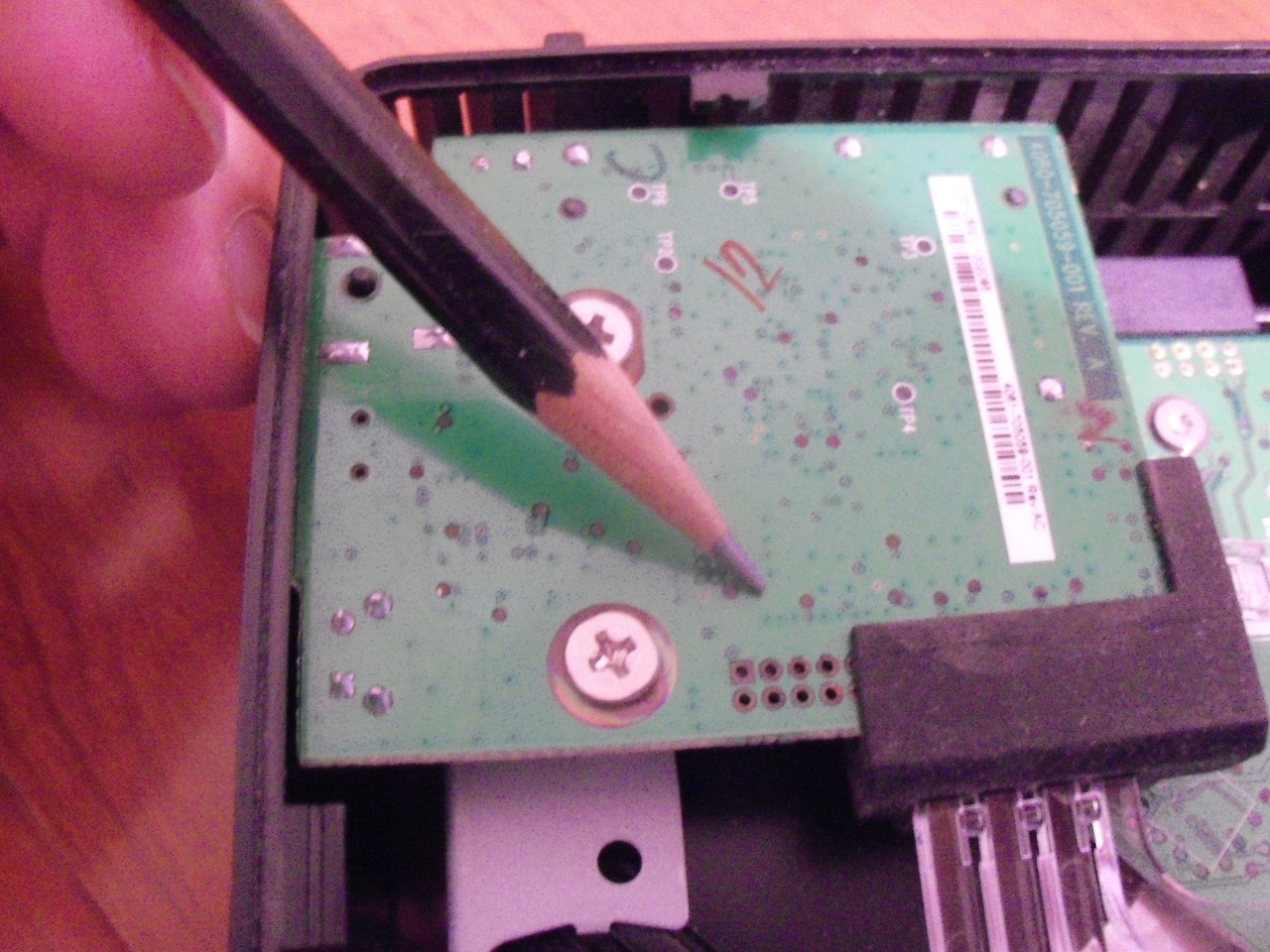

Accidently plugged 19vdc PS into a 12vdc back up hard drive.
I removed the PC board from the HD then connected the 12v PC and LED light marked D6 activity comes on very bright.
Red color button on PC board says, soft state.
When I reconnect PC board to HD all 6 LED lights come on not very bright.
D1 Lock
D2 Gauge 1
D3 Gauge 2
D4 Gauge 3
D5 Gauge 4
D6 Active
I tried all the USB wires I have and HD does not show up on my computer as being connected to the computer.
I can't think of anything else to test.
If I buy the $20 HD enclosure maybe HD will work.
My question is, if he was using the computer HDMI output to the hard drive is there anything on the drive at all? Or anything useful?
It's the same USB cable used for the Pickit 2 and Arduino Nano. A mini USB cable which was once common but was replaced with micro USB and now USB C.

So you got the HDD out. I would do as suggested and invest in an inexpensive USB to SATA HDD adapter. Google is your friend. I have a few from over the years which will adapt to any HDD and the kits include a power supply for powering your HDD. Then you will know if the actual HDD from your enclosure is alive. Unitek and a dozen others make a universal PATA / SATA to USB adapter kit.

This HD is not made to be inside of any computer it connects to any computer with this cable. This circuit board plugs into the edge of the HD its not made to have a HD cable plugged into it. I stopped building computers 15 years ago the HD case looks the same but you can't plug a HD cable into it. Maybe HDs these days use different cables?
Find the PWB board number on the assemblies, and do an eBay search to see if someone has parted out a similar drive. You may get lucky and it will fix the drive.
