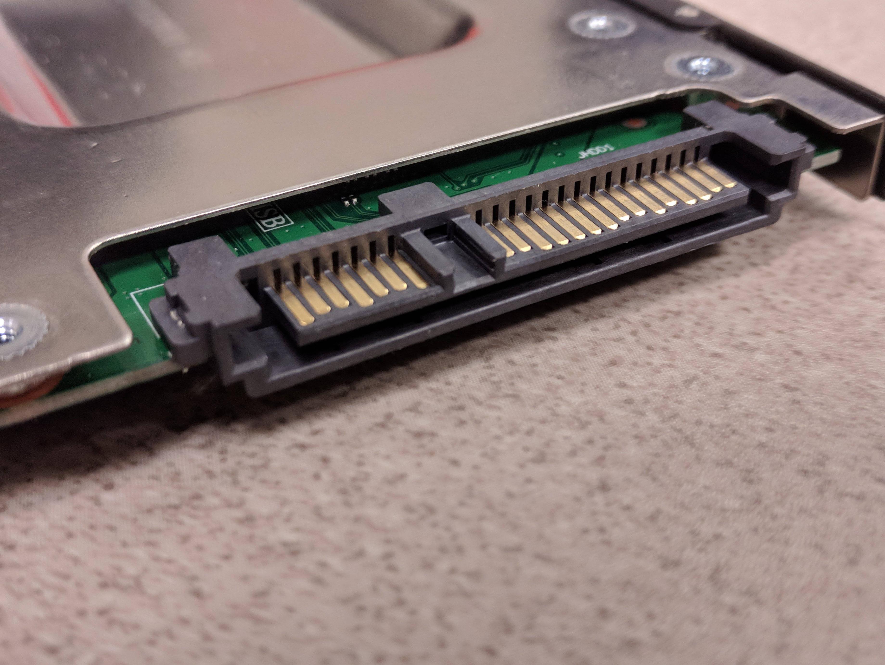

The external drive is a SATA drive – the norm for more than 10 years. The easiest way to recover your drive, if it's possible, is to buy a USB–SATA converter OR another external SATA enclosure
That looks like (is) a 3.5" drive. The connectors, as already mentioned, will be sata.
This is what a sata connector looks like,
Is that what yours looks like?

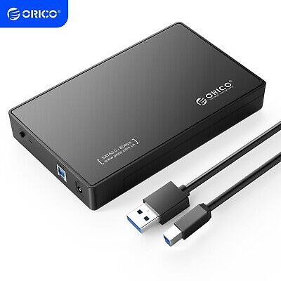

Picture #2 shows it is a SATA drive.
Picture #3 shows the jack for the USB cable in post #6 connects to the external housing adapter interface board, not to the hard drive.
Post #8 shows the connector SATA drives have for powering it and for data.
To connect a SATA drive to a USB cable, takes that extra adapter board inside the external housing.

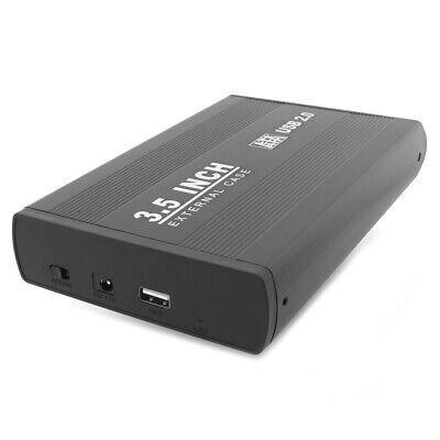

I'll also confirm it is a "bog standard" 3.5" SATA drive.
It was fitted in a branded version of a SATA to USB enclosure such as this type of thing:
The prices vary with the USB type/speed and just from make to make & different sellers.
The big question is if the drive electronics were blown by the overvoltage, or only the USB adapter / regulator part...
I'm pretty sure the new drive enclosure will come with a new USB cable (and power supply if needed). The one you're showing is a USB A to mini USB B cable which is pretty much out of favour now.
