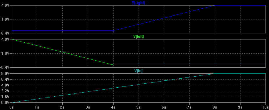

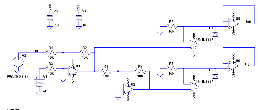

I posted a schematic on the other forum.
This should work. There may be a simpler way to do it.
V1, the -4V battery, is actually a voltage reference, and it could have another value, so long as V1/R3=400uA. For op amps, try TL074 or something similar.
U1 inverts the input and level-shifts it to be symmetrical around zero volts. Full scale (FS) left at the U1 output is +4V, FS right is -4V.
U2 reinverts the signal. FS left at the U2 output is -4V, FS right is +4V.
U3 and U4 are half wave rectifiers that clip off the negative portions of their respective iputs.
U5 and U6 are voltage followers, to give you a low output impedance that will drive a light load without error being introduced by the load.
You probably don't need U5 and U6 if you are driving LM3914s.

One small last question (this guy is *never* satisfied!), the diagram shows the Op Amps as 1N4148...and Google as I might, I can only find diodes referenced as such...
My supplier has several variations of op-amps, but none with that number (it may be because I am in the UK and have been looking at products available at https://www.maplins.co.uk.
Can you give me any further help on the nature of the Op Amps...are they common or garden variety, that I can swap with any similar product? or do they have carefully selected characteristics?
Jim

jimbo1954 said:
That is *exactly* what I needed! Thanks Very Much!
That's because the reference is for the two diodes to the right of the opamps! :D
