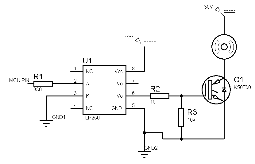

Hi All
I want to control dc motor using k50t60 IGPT & microcontroller .
below the circuit i want to use .
should i modify the circuit before test it.?
regards
I
You need two caps on the +12v. A ceramic at the pins and an ele. cap.
Can your computer I/O pin lift up 5ma? You can reverse things. Most computers can pull down much better. (I/O & Ground verses Supply & I/O)
