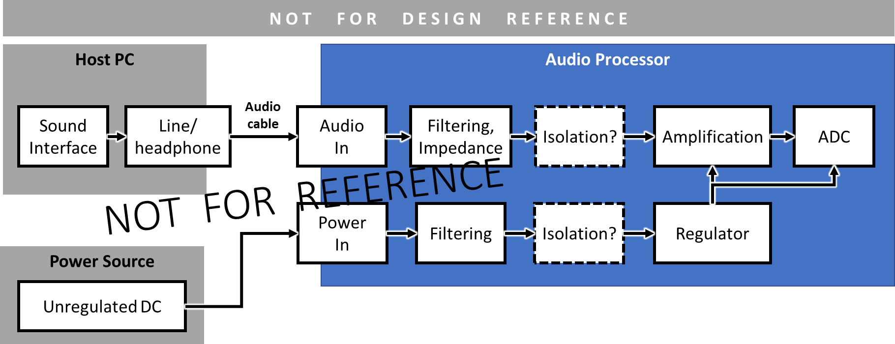

Hello all,
I have a system in need of a PC audio source by way of a headphone jack or possibly a line out jack. The intent is to plug my device into a PC audio jack, have it show up as an ordinary set of phones, and push audio signals to an analog to digital converter (ADC). You can see my diagram attached, and this is mostly concerning the blue shaded area.
The idea is to of course do this without damaging the PC side in any way. After doing some preliminary searching, I've found no real standard range for headphone impedance: or if there is one, there are many headphone products in conflict with it. So I guess my initial questions for how to connect an ADC to a PC are:
1. Do I need a transformer at my input? If so: are there specifications it should meet?
2. What voltage range should I expect from a typical PC headphone port if headphones were plugged in?
3. Does a headphone waveform cross the PC's 0-volt reference/ground?
4. Are there any unexpected traps/pitfalls to watch out for when connecting electronics to PC audio jacks?

1. No. If your input can take the voltage and current from the PC (2.5W).
Where did you get that from?.
PC's haven't included audio amplifers since probably the 286/386 days, the audio output socket is just a line level or headphone socket, and can feed any standard sort of line level input. Hence the fact that computer speakers have had in-built amplifiers for decades now.
The output is line level / headphone compatible.
The impedance can be just about anything, ten ohms to 10K or more.
Aiming somewhere around 10K is probably most practical for an audio input.
The load needs probably needs a DC path (resistor across it) for the PC auto switching system to detect it, if that's enabled.
The signal will be symmetrical to ground.
Downsides:
PC analog audio is generally not that good quality and frequently has power supply noise superimposed on it.
If the external equipment is separately grounded, earth loops and yet more noise on the input are likely.
It may need isolation transformers to eliminate ground loops, but they can then reduce frequency response and do nothing for source noise.
You say you are going to feed the signal to an ADC - so you want digital audio...
The better option for that is to take a direct digital signal and use that in your project - you avoid all the noise and grounding problems and retain maximum possible quality.
Most motherboards have an S/PDIF digital audio output, even if there is no rear panel connection for it.
It's a 5V logic level signal and can connect directly to a TOSLINK transmitter for optical out, or a resistor divider for a coax output.
You can buy add-on connector plates for desktops, with the connectors and appropriate cables to suit different makers S/PDIF headers.
If your computer does not have S/PDIF, you can get an external USB sound card with optical or coax out for about 10- on ebay.
I got it from opening the PC and checking whats inside. You have a speaker of 2.5W AC audio signal. Your auido jack is not more than the internal speaker's power of "2.5W".
That's presumably a laptop or all-in-one, as desktops do not generally include speakers.
The audio out socket on a laptop/all-in-one machine will not be the same level as the speakers - most basic headphones are only rated for a fraction of a watt & 2.5W into headphones is enough to rupture eardrums...
