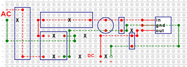

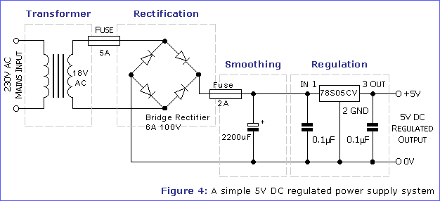

Ok, so I've got my 230/40vAC-18vAC transformer.
So I look up building a power supply and come up with a circuit based on one on the 'net. I upgrade the components listed to support more current. I build it according to the schematic.
It gives me 2.5vDC and not 5v DC!
v AC at transformer out - 18v AC :)
v DC after rectifier diode - 16v DC :)
v DC after smoother and regulation circuits - 2.5v DC :S
Any ideas please?
(Schematic and stripboard layout uploaded.)

Is this with, or without, a load?.
If it's without a load, then you've probably connected the 7805 the wrong way round?.
You should also be VERY aware that the 7805 is going to get EXTREMELY hot under any reasonable load, and will require a substantial sized heatsink. Main reason for this is that the transformer is far too high a voltage to feed a 5V regulator.

I've already got a heatsink (twisted vane) and nothing seems to get hot. I've looked at the datasheet and I copied the image but I am assuming the VR image on datasheet is from the lumpside facing. If its the lumpside away then it's back to front.
The capacitor is wired with the positive wire from the fuse to the positive terminal on the capacitor (and the capacitor hasn't exploded)
I'm not sure whether my multimeter is working properly so new one should be here tomorrow.
Re-checked the voltage after the rectifier and it says 25V DC!!! this is from 18V AC in. Is this right????? How does the rectifier make the voltage grow? I thought the voltage should drop after the rectifier by about 1V per diode....
Also re-checked the voltage out and it started at about 4.6V DC and gradually dropped to 1.6V DC. Once it had dropped to under 2V I wired in an LED and it didn't need a resistor! It was sooooo dim :(

18 x 1.41 = 25 Volts DC that is ok.
The 2200 µF Capacitor smoothens the ripple and bring it up to 25 Volts at no load.
Through the bridge rectifier 1.2 Volts is lost because of the diodes in series.
If you have 2 x 12 volts 5 watt car bulbs, wire those in series to check your power supply before the rectifier.

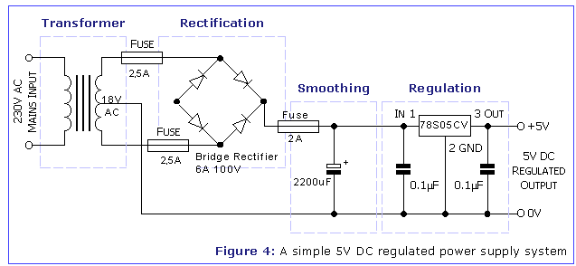

Check the regulator , perhaps wired up wrong as already said. Could be a dud too.
Just had another look at the schema.
The regulator is drawn in ok, you are sure it is on the board , right way around?
Also check that the negative from the regulator is continuous. otherwise it has no reference.
A good, reliable multimeter is a must for fault finding.
Check all solder joints and see if components are loose or tracks are broken.
you might have the 7805 backwards. Recheck the datasheet carefully.
The 18Vac output is the RMS value. This means that the peak voltage of the sinusoidal voltage about 25V, so the output of the diode bridge will be right around there. If you want that to be 18VDC, then you might want to get another linear regulator and supply the 18V with that.
A 25V input to a 5V output linear regulator that will see a max load current of 1.5A is going to fry that 7805 real quick. The 7805 will be dissipating 30W! Even if you're input to the 7805 was 18V, that is still 19.5W. Way too much for any single pass element, even with a heatsink. There's no way to remove the heat quickly enough in a realistic scenario.
Solutions... a transformer with two secondaries would work. Then you just rectify and regulate for your 18V and 5V. Another option would be a switching regulator, but that's fairly complicated.
If I read correctly, you need 5V supplying 1.5A to your LED. Well, you've got 25V input that means the 7805 needs to dissipate 30 Watts! Don't do that. Reduce input voltage to 7805 & use BIG heat sink. Or buck converter for the 5V.

Did that, it doesn't show whether the image of the 7805 is lumpy side facing or away though.
If you look at the "lumpy side" with the legs pointing down, then the input is at the left and the output is on the right and the center leg is ground.

Aha, ok, it was wired up ok.

Woohoo!!!
One 5V DC power supply :)
Nothing gets hot, nothing blew up.
Not even an electric shock!
