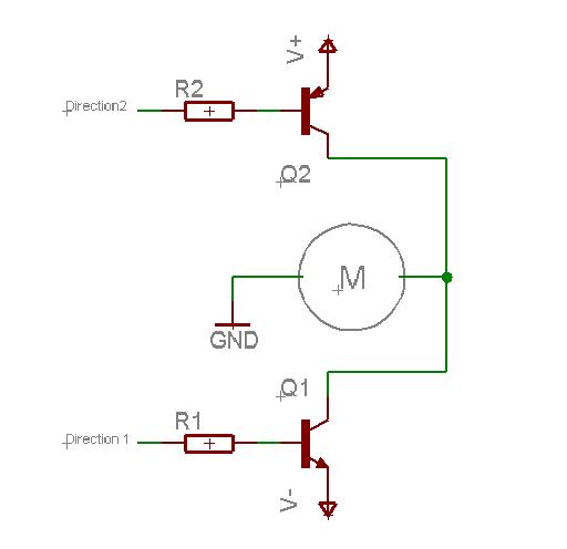

if a dual power supply is available then it's really simple...like this
(gnd switches a direction on; never drive both directions at once)

Its not a good idea to make parallel port sink the base current of upper PNP transistor. If base current is too high, it may blow up the port. Also the voltage +V has direct effect on base, which when greater than 5V has potential to destroy the port.
So use additional NPN transistor to drive PNP. Drive this NPN with parallel port.
One should always buffer the parallel port (with an 7407 and pullups for example).

Also, the NPN in the schematic (with emitter to V-) can't be turned off with TTL logic levels. You would need a PNP to drive this transistor.
Yes RonH, I forgot to see that part of the schematic.
The problem is not with the NPN transistor, its with the PNP. Ive built circuits with the parallel port using NPN transistors and they worked fine. A high output on a parallel port pin will turn an NPN transistor ON a low will turn it OFF. If you want to insure that the transistor is OFF ,during a low , simply connect a 10K or so resistor between the base and ground.
An even better idea when working with the parallel port is to use an opto isolator IC such as a 4N25 to drive the transistor. This will give perfect separation between the computer parallel port and any connected loads especially motors and relay.

Nettron, you can switch an NPN with the parallel port if the emitter is grounded. Look at the schematic. The emitter is connected to V-. If you ground the base, the base-emitter junction is still forward-biased. You need a PNP as a level translator.
I agree with your suggestion to use optoisolators for motor control.
Doh! hadnt noticed thats a dual polarity power supply.
But i'd caution against using PNP transistors on the parallel port. As Kinjalgp already mentioned the port would have to sink current to ground, ive bin warned by others , when i was working on my circuits , not to use PNP transistors.

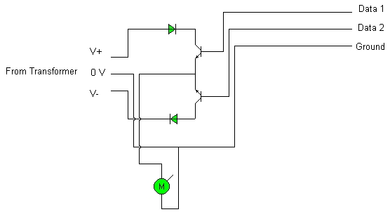

I just cant get it to work!!! :x :x :x
Im desineing the circuit in Crocodile Tehnology!
I just got the 4 transistor circuit to work but i want to have it with yust 2!
if i use the 4 transistor i need 16 transistors for 4 motors!!!
And thats lo lo!
PS: the 4 transistor can work with a normal batery

After some time of mesing with the simulator i finaly got it! 8)
This is made of just 2 diodes, 2 transistors and a transformer!
Dose it realy work or is just a bug in the simulator? :?
What do you have to say?Do you like it? 8) 8) 8)

The top transistor will work as an emitter follower, so the voltage across the motor will never be more than the voltage on Data 1, minus the Vbe (0.7v) of that transistor. The bottom transistor will never switch the motor. What simulator are you using? Given your level of knowledge, I'd be more inclined to say it's a bug in the operator. :roll: I don't mean this as a put-down. It's just a fact that a simulator in the hands of an inexperienced person can give misleading results. In fact, a simulator in the hands of an experienced person can give misleading results, and the simulator is generally not the problem. I'm not putting down simulators - I spend most of my time at work using Hspice and Agilent ADS. I use Linear Technology's free SwitcherCAD III at home. This experience has led me to these conclusions.
I use the "Crocodile Technology" Simulator.
Its a demo so i can't save circuit's but i am working a program to save the copy'd file from the clipboard and then paste it in agen!(Its Save/Load my stile 8) )

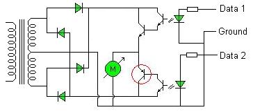

In the negative side You need a PNP transistor. I recommend to use darlingtons.
