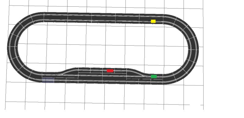

Ok so here a simple track with pitlane:

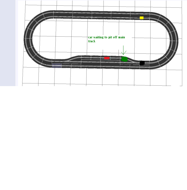

RED pitting, so does GREEN sit at pit entry waiting to pit with power cut? The problem with the dead strip is car YELLOW coming round track on inside lane.
A track this size would take around 3.5/4 seconds per lap so YELLOW driver would really have to pay attention and then stop/wait for GREEN to enter pit before carrying on his lap. If power was cut to the entry flipper car GREEN would be fored to keep lapping unitl pit was free again.
Is this what you had in mind or where would this dead strip be?
Right il test it on my track and use masking tape to create a dead strip and see how big it has to be for the car to slow and stop.
just put the tape on the track connector contacts, not on the rals. It might slow the car down too much for reliable stopping distance measurement.
ok tested my track, with the momentum produced by the car its looking around 12-18inches to stop from half throttle which is quite a long way in 1:32 terms. Tested with 6 different cars with almost the same outcome for each. GOing to get tech spec for lane changer and see what solenoid i would need to overide it.
